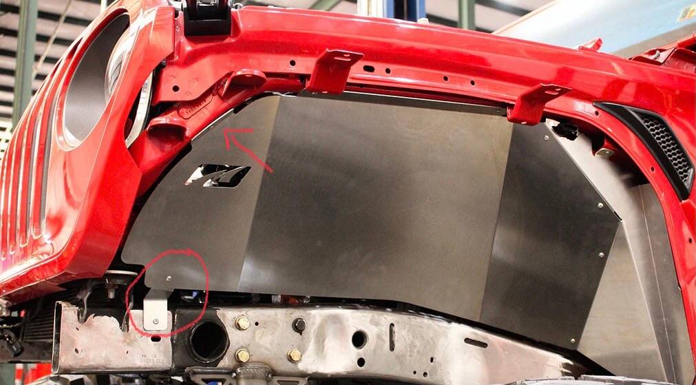

Terrymo
Terry
Jun 17, 2022
52
11,824
37,235
2023 JLURXR 3.6 ET
I had some hardware loosen in the two areas shown, and I think the bottom bracket was popping.
