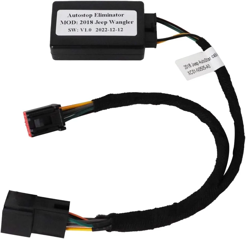

I did this and a month later-everything still works perfectly! The standard main starter battery without a tow package is something like 650 CCA and the Aux is 200 CCA-so a Diehard AGM battery is rated at 850 CCA-which covers all the bases if you still want the stop/start system to work and better yet if you eliminate the stop/Start with this $39.00 plug in.

That's the first ESS defeat harness I've seen that uses the HVAC panel in lieu of a connection in the driver's side footwell. Hopefully the Amazon harness doesn't require too much finagling to stow the wiring, as the review suggests it does (and which isn't an issue with the admittedly more expensive under-dash harnesses.)
I have been using this for a month or so and it works perfectly. There is a space to put the unit behind the A/C panel if you take the time to look for it. This is so easy to install that it takes less than 5 minutes from start to finish. A great add on for $39.00
