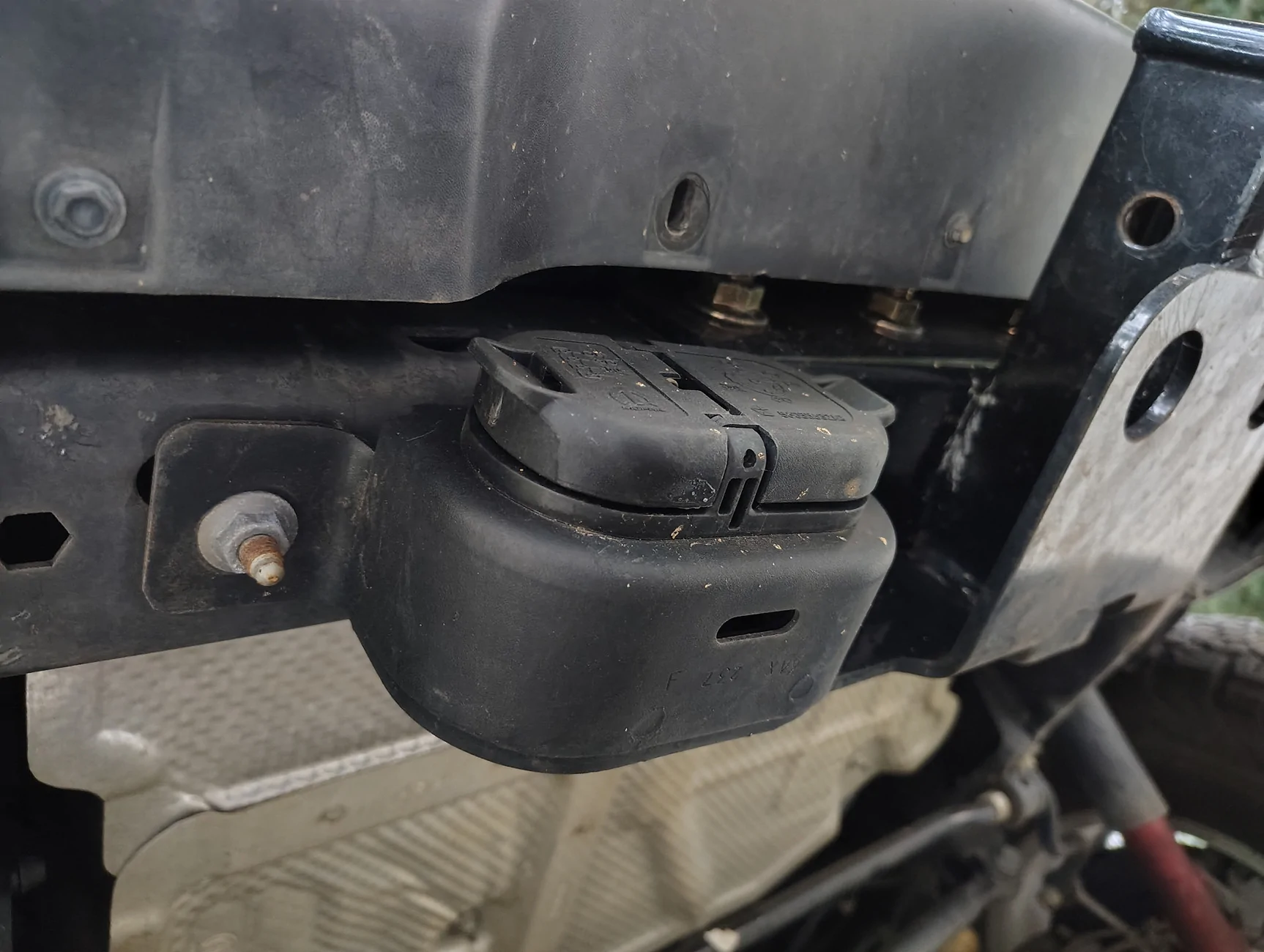

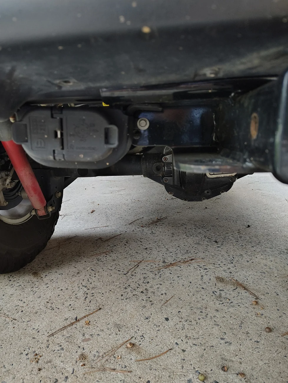

Hi everyone,
I have a 2023 Rubicon Unlimited, factory with 33’s. I have the factory tow package, but I want to upgrade to a class 3 hitch. I’m looking to tow a trailer that’s around 3100 lbs, but I want to use a weight distributing hitch (tongue weight is nearly 350 lbs). From what I understand, the class 2 hitch I currently have isn’t rated to use a weight distributing hitch, hence the upgrade.
I see there’s a lot of class 3 hitches out there, but I can’t seem to find one that would accommodate the factory wiring plug. Does anyone know one that would work? Is there a factory class 3 hitch that I can buy, seeing how the later model years can be rated at 5000 lbs?
Thanks in advance!
Rob
I put a Curt on mine. I had to get creative with the bolts and drilled a small hole for one side of the factory plug. It fits almost perfectly.
Jeep Wrangler JL Class 3 Hitch Upgrade IMG_20251009_184928466_HDR
Jeep Wrangler JL Class 3 Hitch Upgrade IMG_20251009_184948308_HDR

I put the Draw-Tite unit on mine. It was the highest load capacity when I bought it a few years back, but it does not play nice with the factory socket. The Curt unit pictured above looks much easier to work around FWIW.
