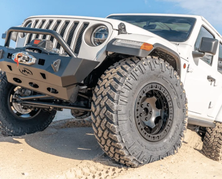

I would run this:
Jeep Wrangler JL Choose my wheels for me 1631584391647
With the Nitto trail grappler 35s in 12.5 width, not the skinny ones..
Jeep Wrangler JL Choose my wheels for me 1631584629781
because yolo! :fist bump:
Good luck on whatever you end up choosing! ;)

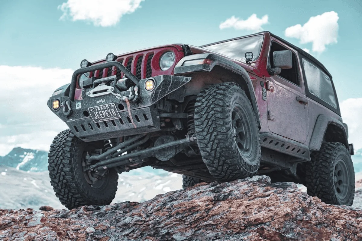

I was under $2k for my setup with 35s, out the door. That was 2 years ago but I bet you could get there. I was also on the 2” dynatrac lift, you’re gonna love that thing

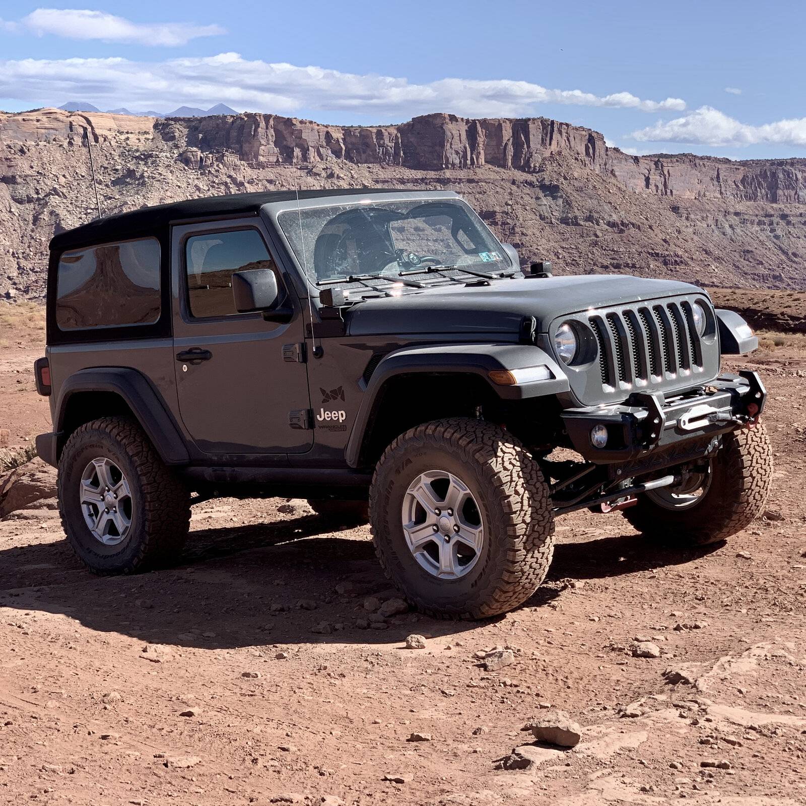

BFG AT's on Stock wheels w/ spacers
Jeep Wrangler JL Choose my wheels for me IMG_0399

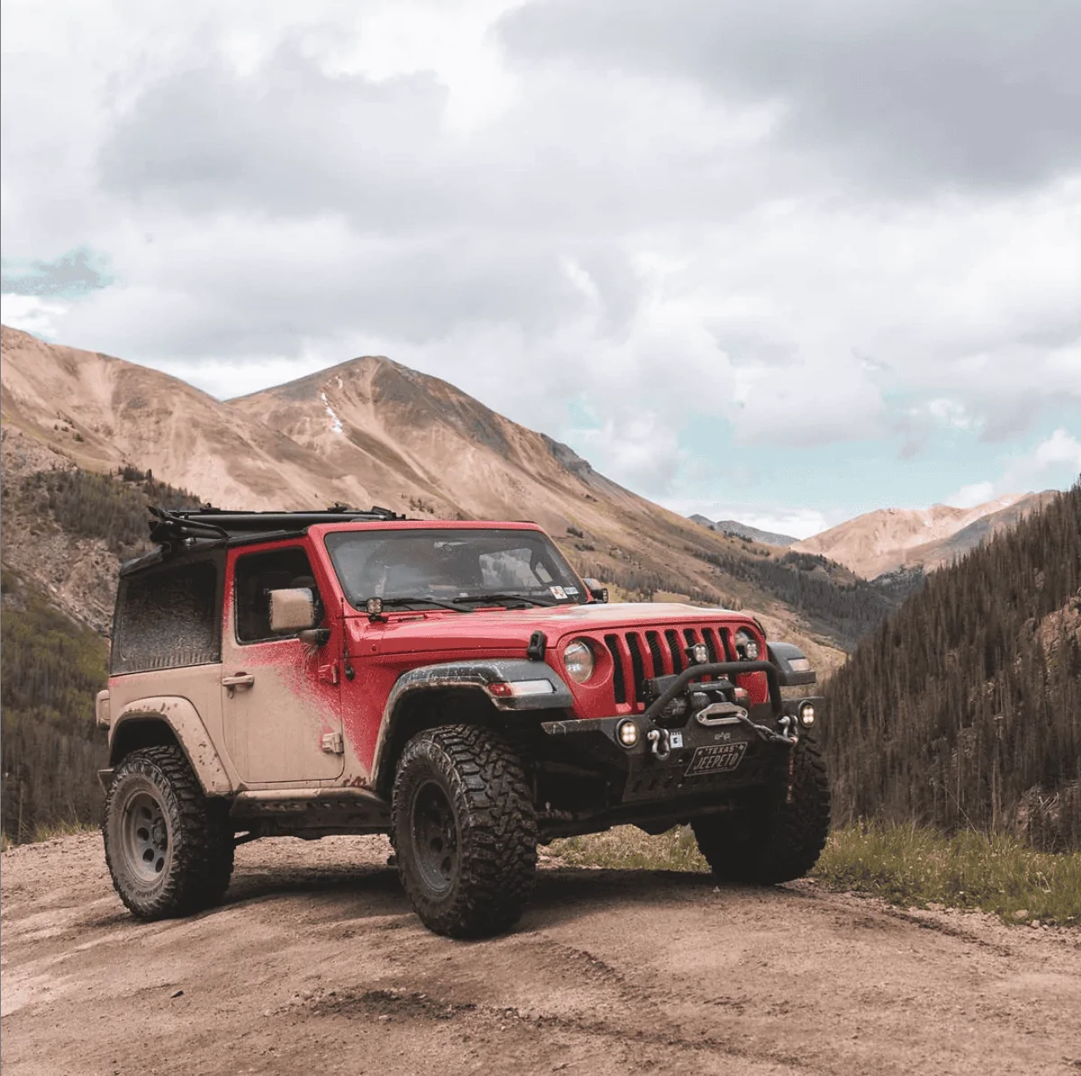

I’m loving my Ballistic Rage wheels…
Jeep Wrangler JL Choose my wheels for me 2A383FEF-8488-41E9-A6BE-AAD3DFA42C87
Jeep Wrangler JL Choose my wheels for me 1A15753B-11A5-49FE-8563-CA0CB343DC93
Only problem is the bore diameter is much larger than the hub on these wheels, so had to get aluminum hub rings to return them to “hub-centric” wheels. Definitely want to check the bore vs hub size on your new wheels. Custom sized aluminum hub rings from US Wheel Adapers are the way to go if you can’t find pre-made rings or Jeep hub specific wheels.

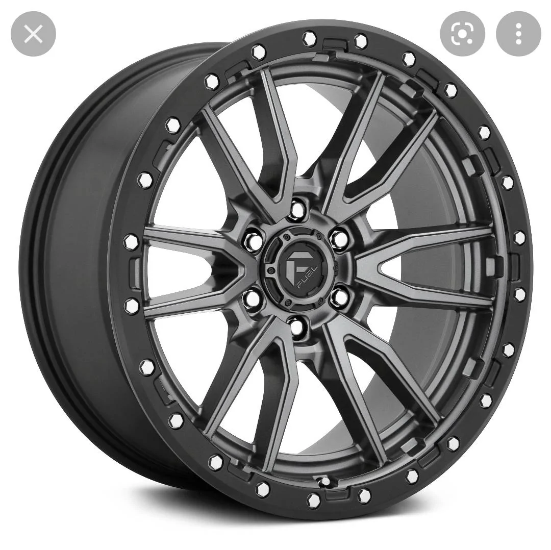

Discount Tire has me at 2700 for 5 Fuel Rebel 5's or Icon Vector 5's and the M/T' in 37's. That's well worth it to me. However with this shit storm in Customs wonder if prices will go up.
Jeep Wrangler JL Choose my wheels for me Screenshot_20210913-214255_Googl
Jeep Wrangler JL Choose my wheels for me Screenshot_20210720-113637_Googl
