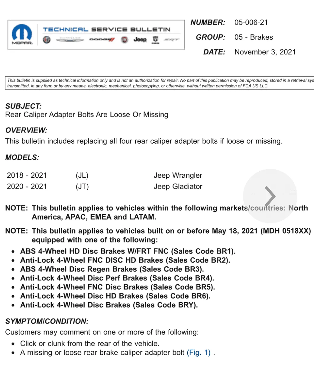

I don’t know what’s going on with the check engine light, but do they want to replace your entire caliper because of a loose bolt? Or did they mean they wanted to simply replace the bolts as per this TSB…
