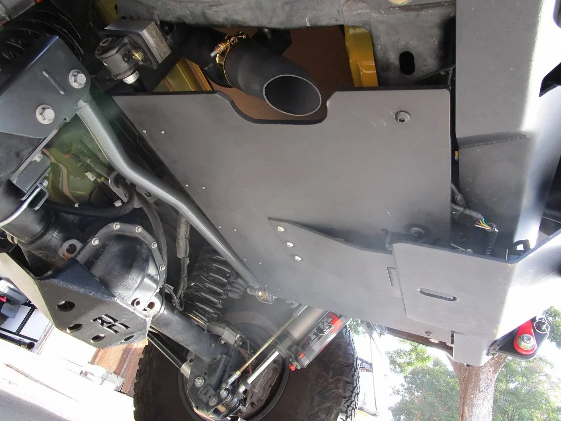

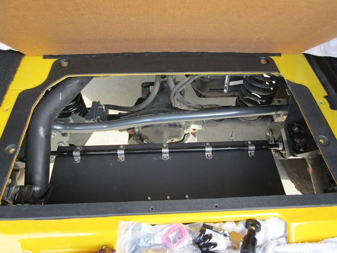

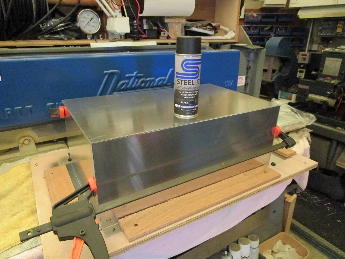

Here is what I did.
First just the muffler delete tail pipe. works great put a little to loud for me.
Second I installed a Borla S-type cat back also worked great put still a little to loud for me.
If I was 17 again I would be happy with ether one of these.
Last I installed Borla Touring cat back and that's what I have now and happy with it.
Now that I no longer have a muffler and muffler skid plate in the rear I have a big opening with the plastic storage exposed that can be damaged when rock crawling so I built a 3/8 aluminum skid plate.
Next I cut out the plastic storage compartment and built an aluminum storage compartment doubling the storage.
Waiting for my buddy to tig weld the box and I will install it.
Another option it this can be made into a 13gal. gas tank with a transfer pump.
My old Borla muffler and custom skid plate is for sale if any one is interested.
