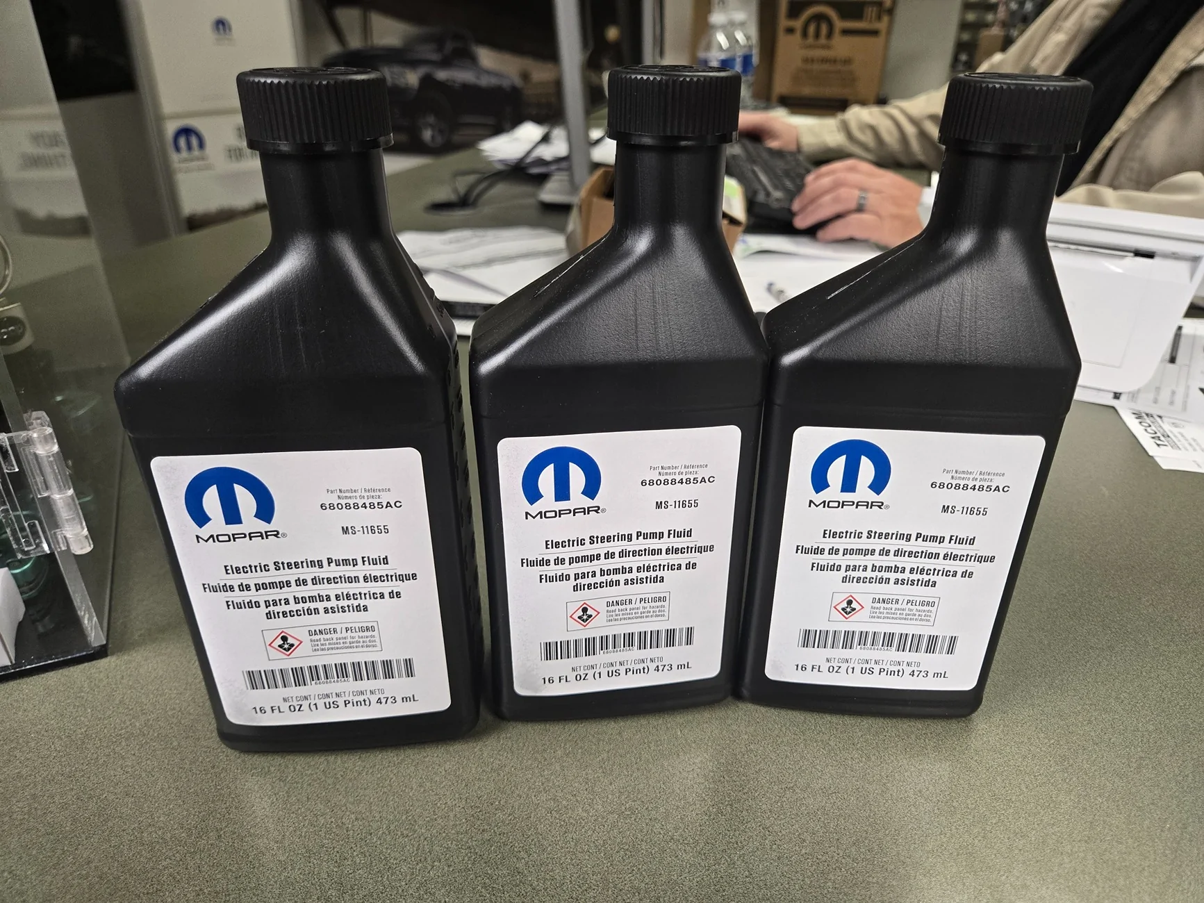

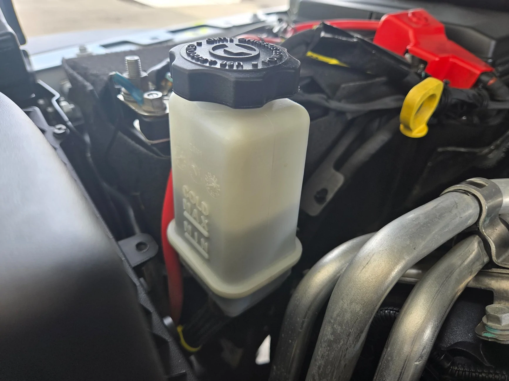

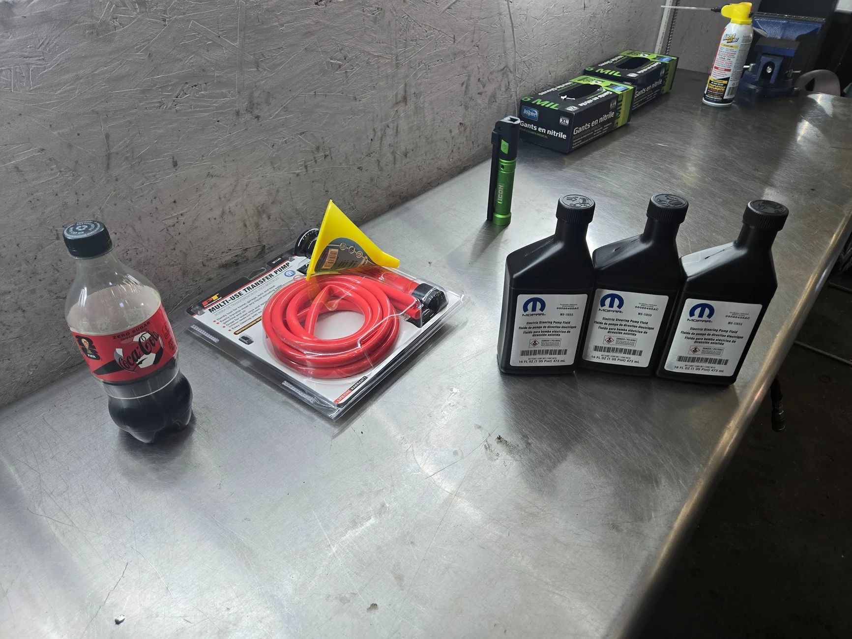

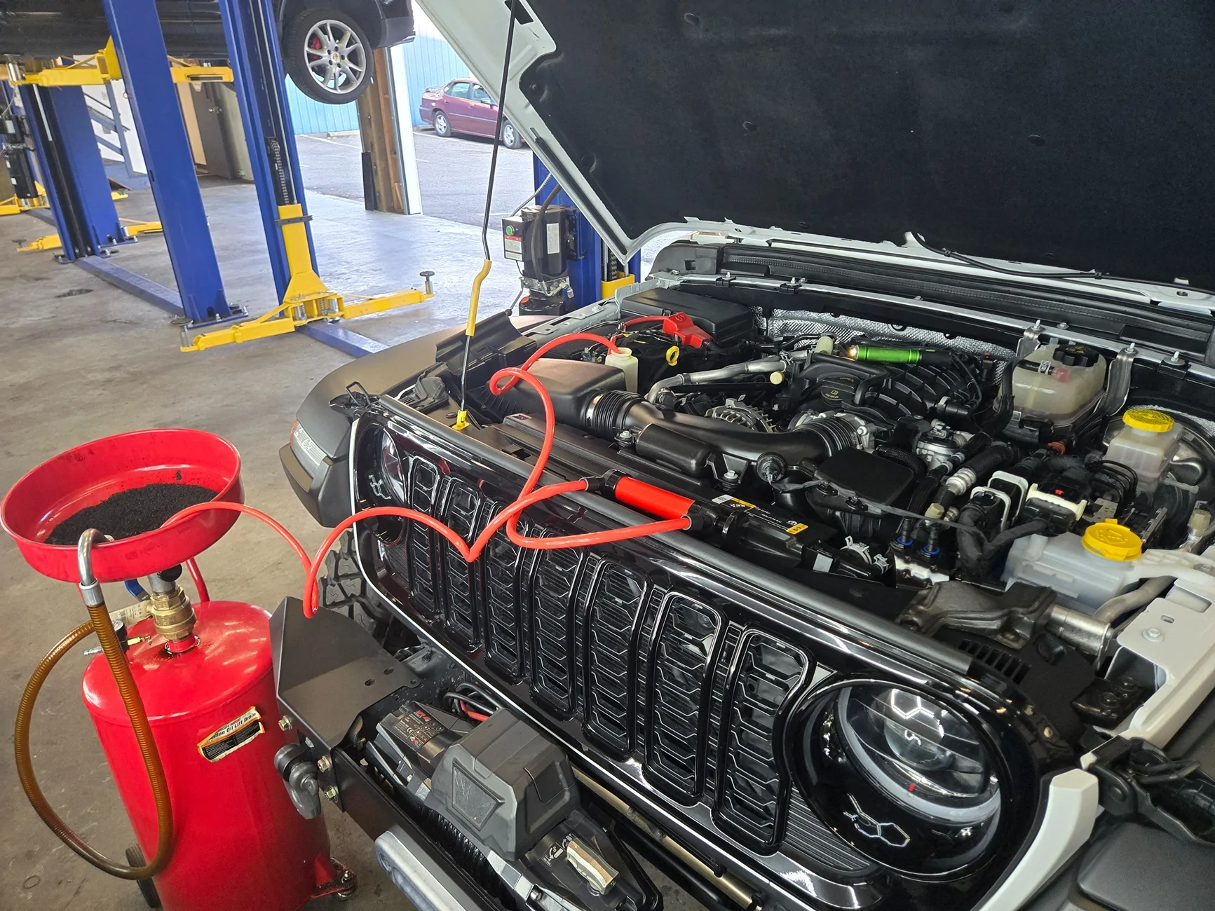

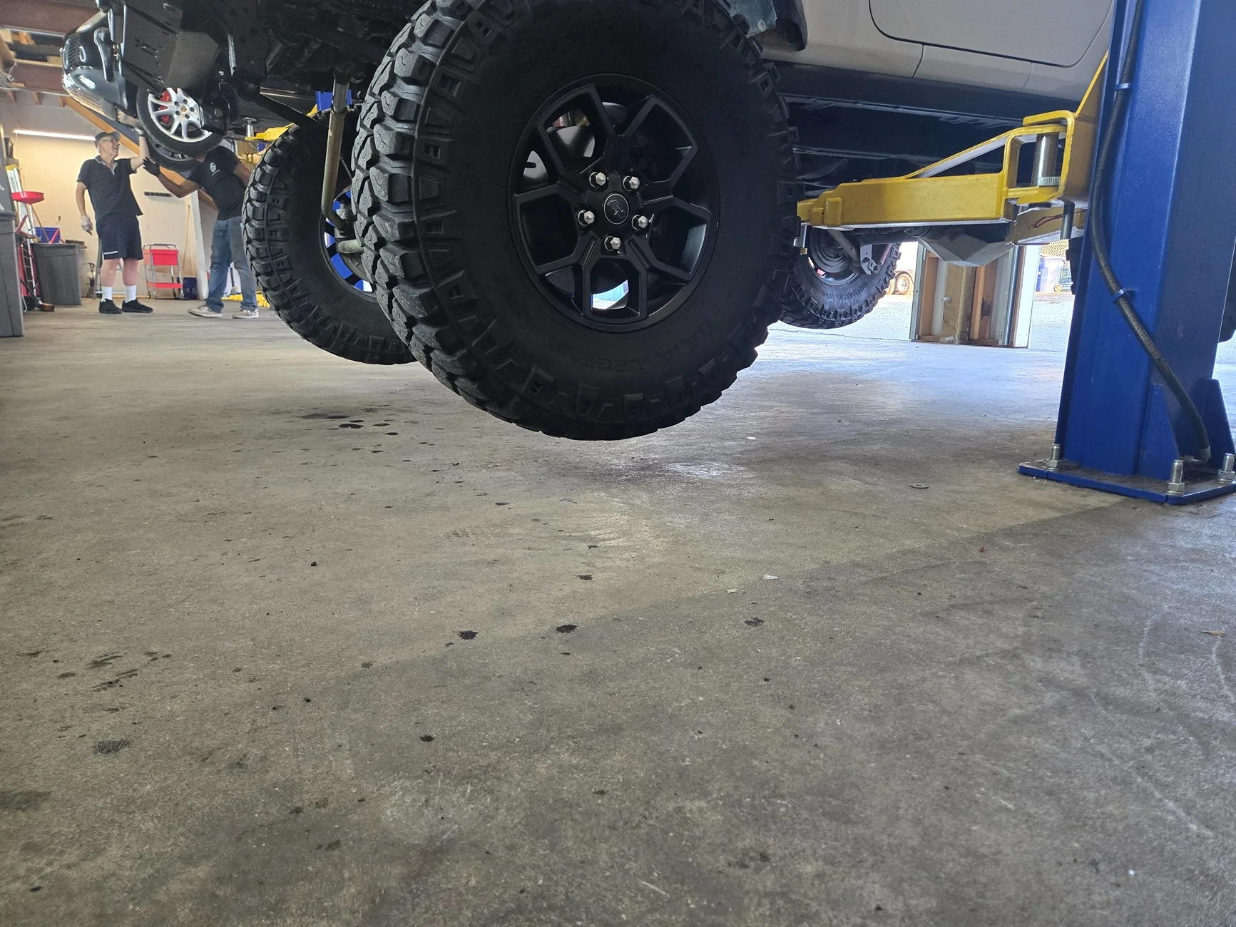

Guys, dealer made me nervous that my steering fluid needs to be changed and they were asking me $409. I said I will do it myself so I grabbed three bottles of the fluid. So here are the steps, please correct me. Thank you 🙏
2024 Willys 2 door, 3.6 and 8 speed
Steps

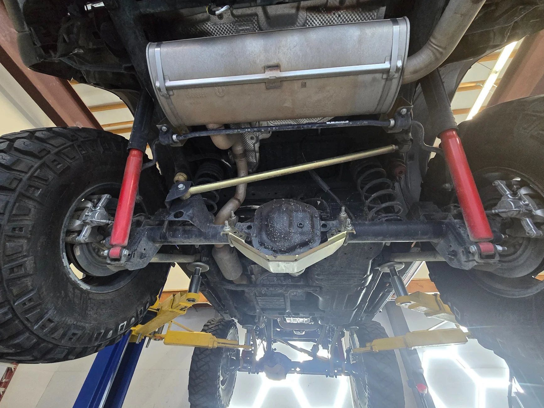

1) Lift front of the Jeep and turn the wheels lock to lock a few times
2) Pump out the old fluid
3) Fill new fluid
4) Turn wheels again
5) Check fluid level and top it off to max level
6) Check the level a few more times when fluid is cold in the morning.

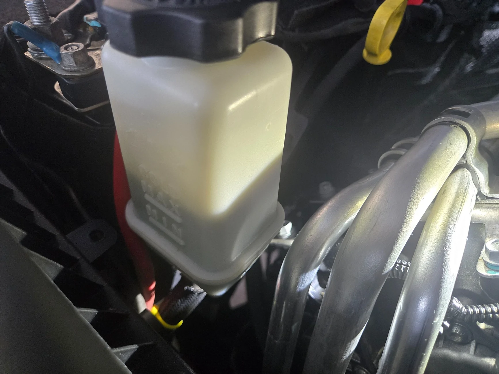

Guys, I screwed up. My level is above Max line. What should I do, pump out some?
