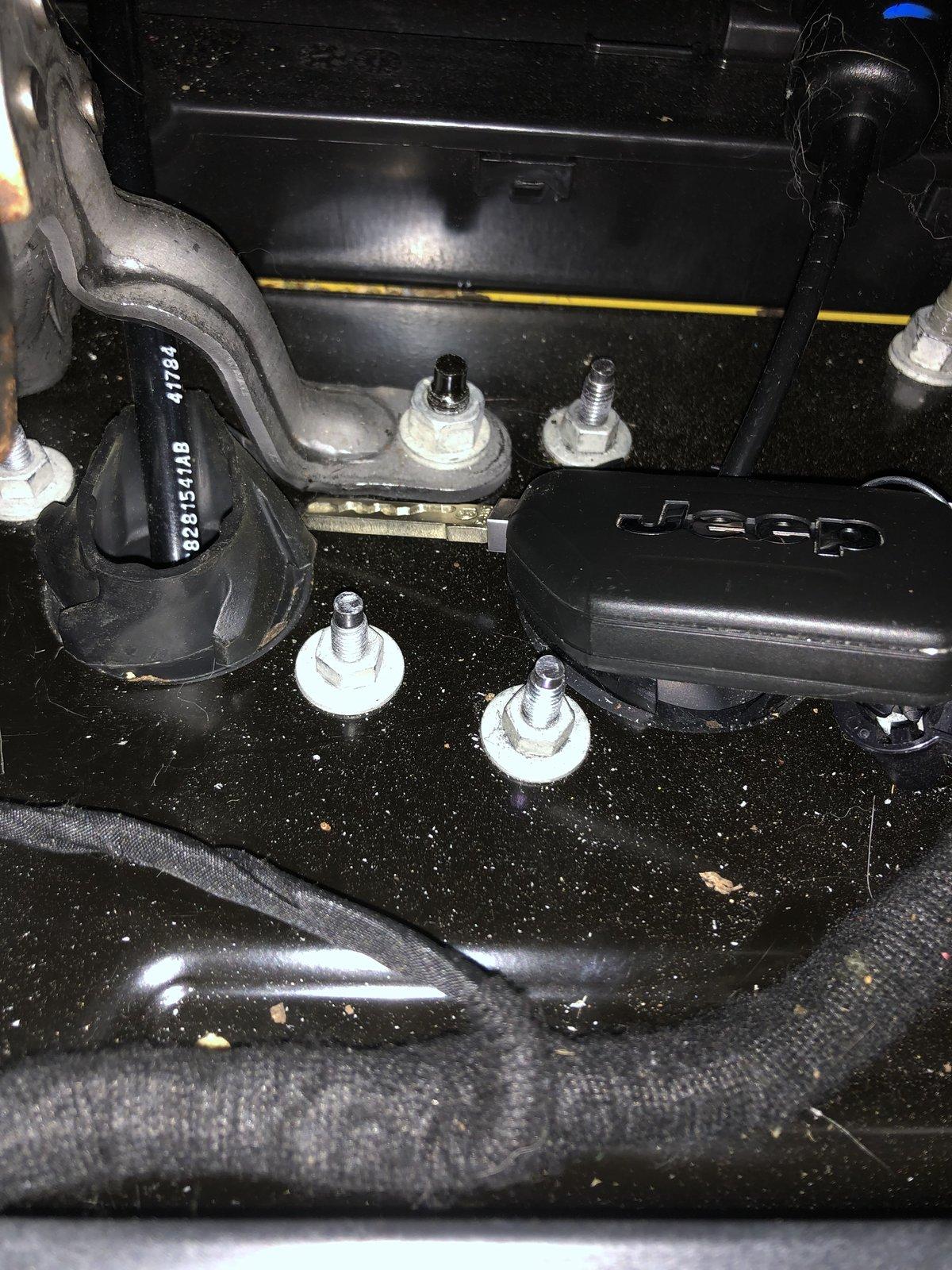

I pulled mine most of the way out. There are square plastic covers on the sides of the console. Pop the plugs and pull the 10mm bolt. pull up on the ebrake and you can lift the rear of the console about a foot or more. I hung the rear with a tie down strap over the roll bar.
Thanks for this information! My key fob fell in between the seat and center console when I tried to grab it, it slid under the center console...just out of reach.
Good, so I'm not the only one stupid stuff like this happens too ;)
