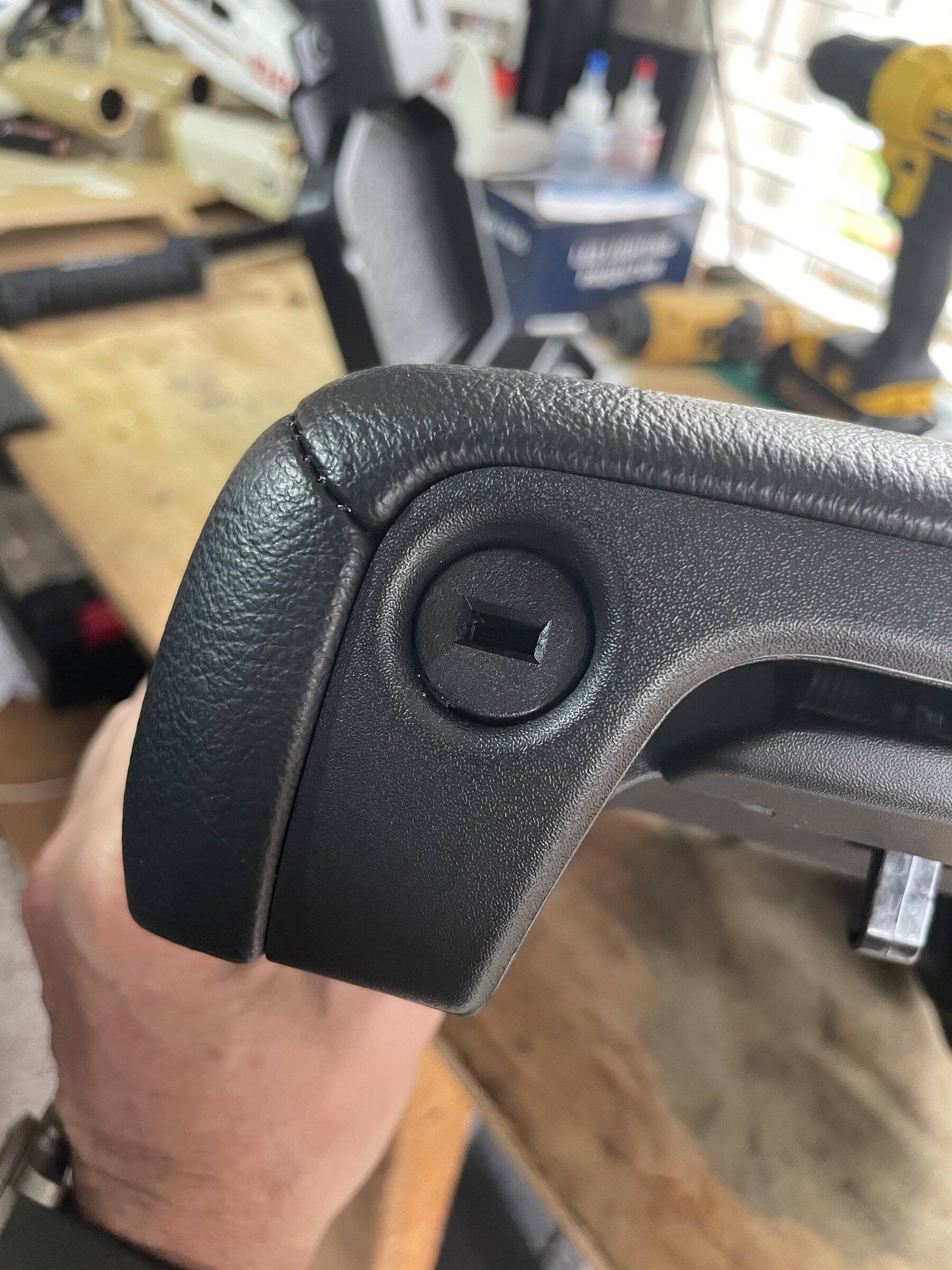

Anybody know how to get access to change out the key lock mechanism and pull it out? Is there a secret to prying apart the top and bottom? (I swapped out the cheap lid for a leather lid and want to put the original key lock into the new lid.)

Yes and no, it doesn’t pop off, instead the entire top is held on by 4 screws, I removed that and replaced the lid. The lock stays with the hinged part of the console. Easy swap.
