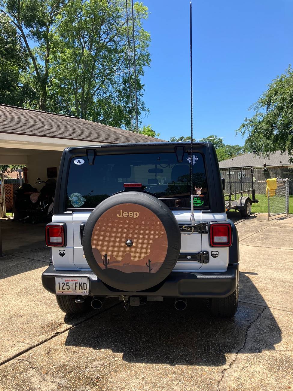

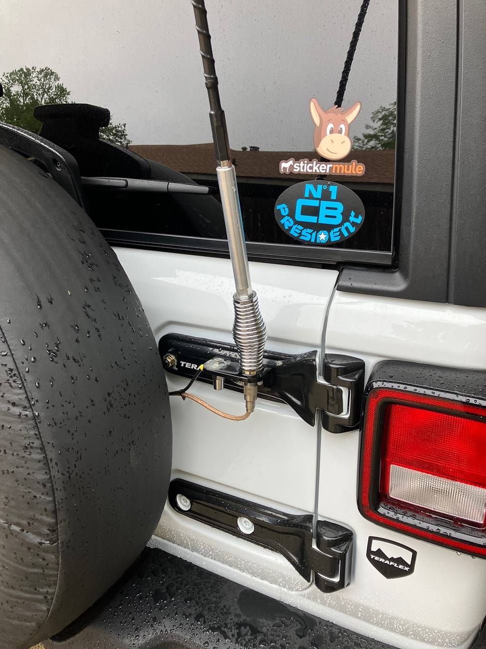

So far, so good. In your first pic, the ground cable on the left is a separate copper cable that isn’t just hooked to the outer shield of the coax? If it is a separate wire, where is that end attached? Hopefully not on the tailgate…
It is passed through the tailgate and grounds to the floorboard inside the vehicle.
