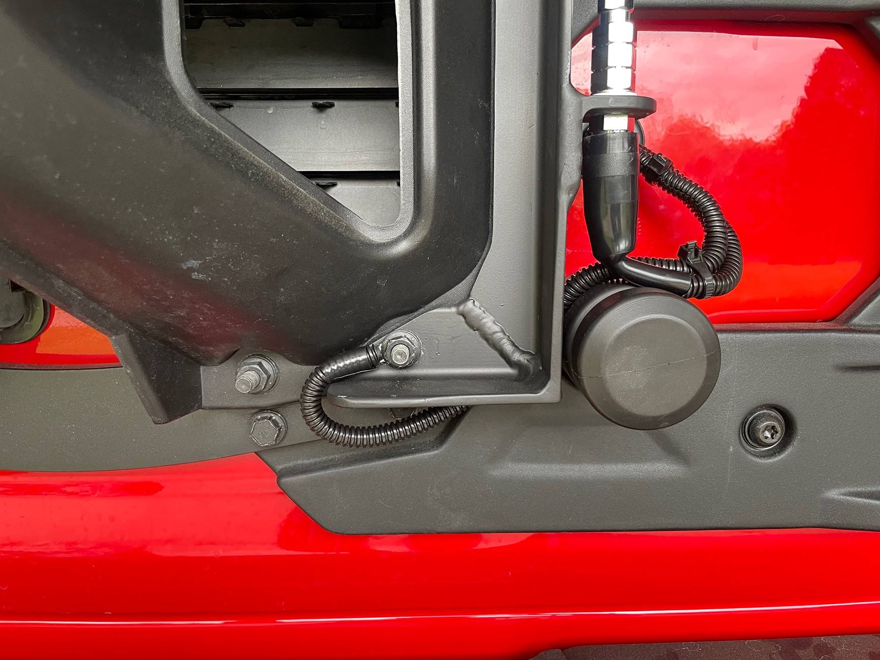

I have the Extreme Recon package on my Rubicon with the reinforced tailgate. I run a 3 foot Firestick and want the Jeep to go through a 7 foot door without taking the antenna off. Couldn’t find a bracket so I designed some templates and made my own. Cut that aluminum angle and had a welding shop stick it together for me. Works well and looks good. Invest in an SWR meter and tune your antenna. Also make sure your antenna has a good ground. I ran an individual ground wire off the bracket to the frame to insure a good ground. That will ultimately affect radio performance. If you don’t tune your antenna and the SWR is too high or you don’t have a good ground, you will destroy a CB Radio. Ask me how I know.

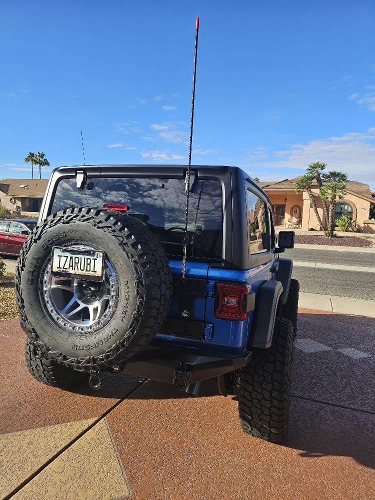

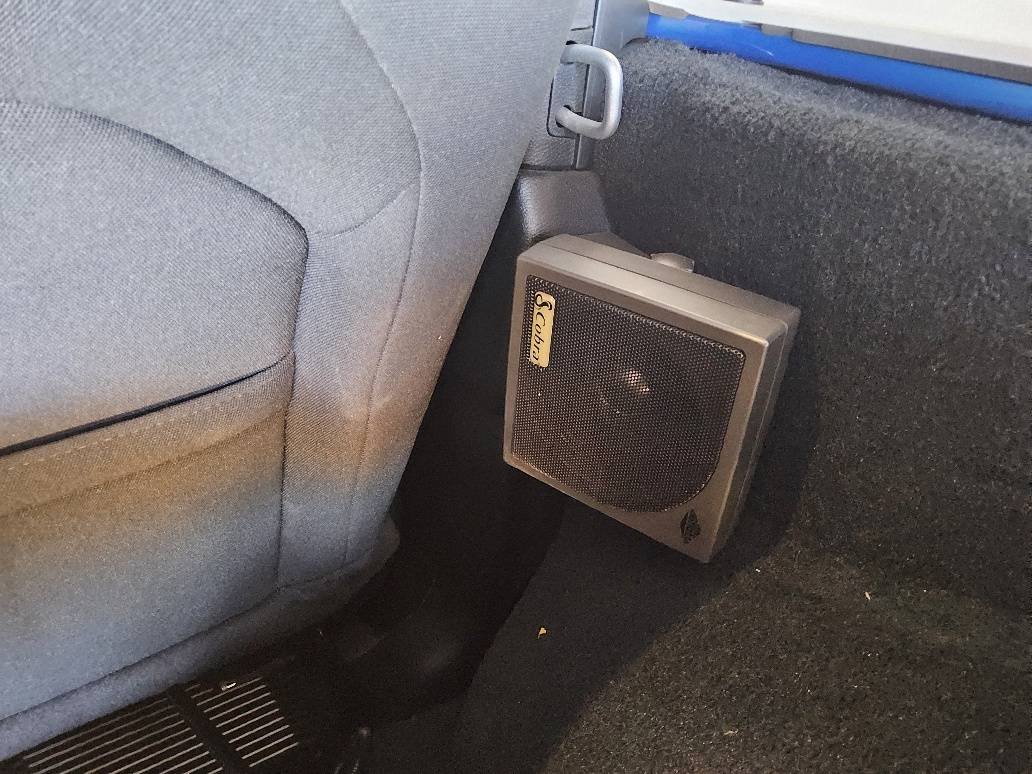

For my 23 Wrangler Rubi 2 Dr. I am using a Cobra 25 LTD Classic CB Radio with a 2 Ft and 5 Ft Firestik II Tunable Tip Antdnna with a Quick Disconnect. With the 2 Ft antenna I get 1.2:1 on Ch. 1 and 1.3:1 on Ch. 40 for VSWRs and with the 5 Ft antenna I get 1.0:1 across the board for VSWRs. My antenna is attached to a bracket on the rear door hinge.

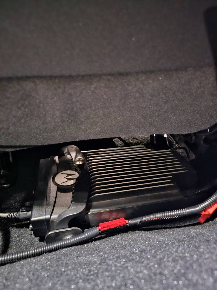

For my GMRS system in my 23 Rubi, I am using a Motorola XTL5000 Remote unit. I have my GMRS radio connected to a Larsen Glass-Mount Antenna which works very well. My VSWR on 462 Meg freqs is 1.2:1 and on 467 Meg freqs is 1.6:1.
My GMRS radio Control Head and the Remote Transceiver along with the CB Radio are powered through the 40 Amp "Aux 1" circuit.
No cheap Chinese junk POS and other related radio parts and stuff were purchased from any 3rd party reseller that sells cheap junk and does not specialized in the sale of radio electronics.

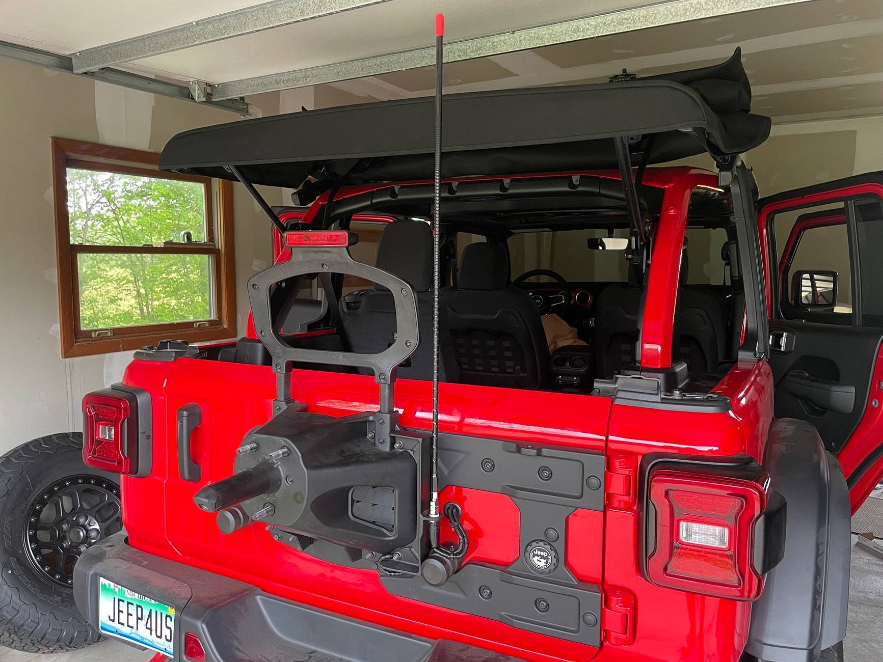

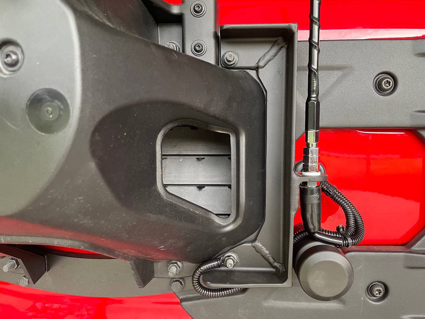

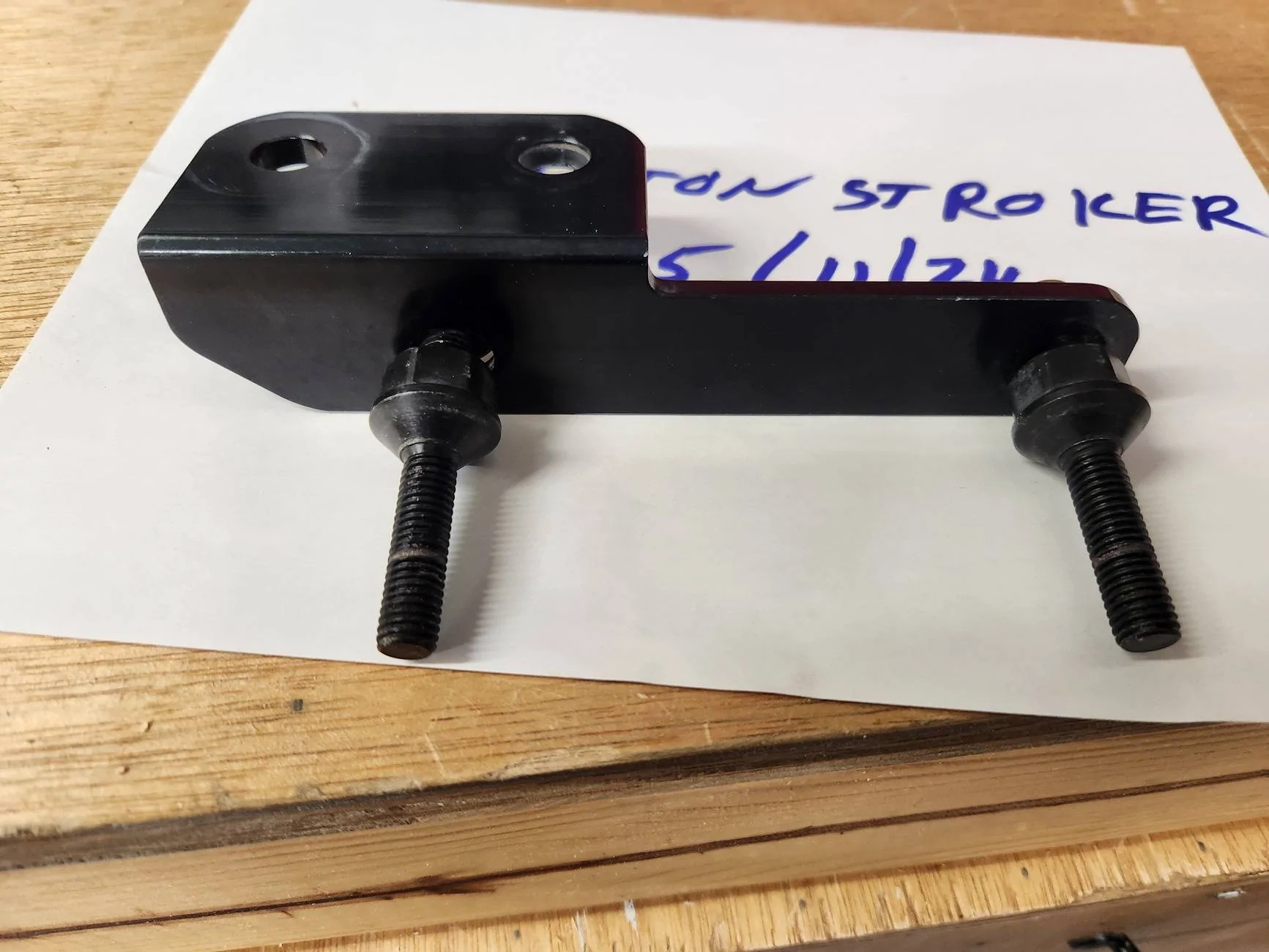

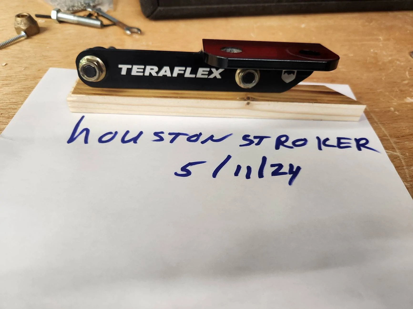

I have a Terefex I can sell you. , The Terefex has two openings one for antenna and one for whip or flag.
Jeep Wrangler JL CB Antenna Recommendations. 20240511_120249
Jeep Wrangler JL CB Antenna Recommendations. 20240511_120256
I used it with a No Ground Plane Firestik. I went with a reinforced tailgate that came with its own mount.

Thanks for the offer. The Teraflex mount won't work with my Cav Fab tire carrier/tailgate hinge
