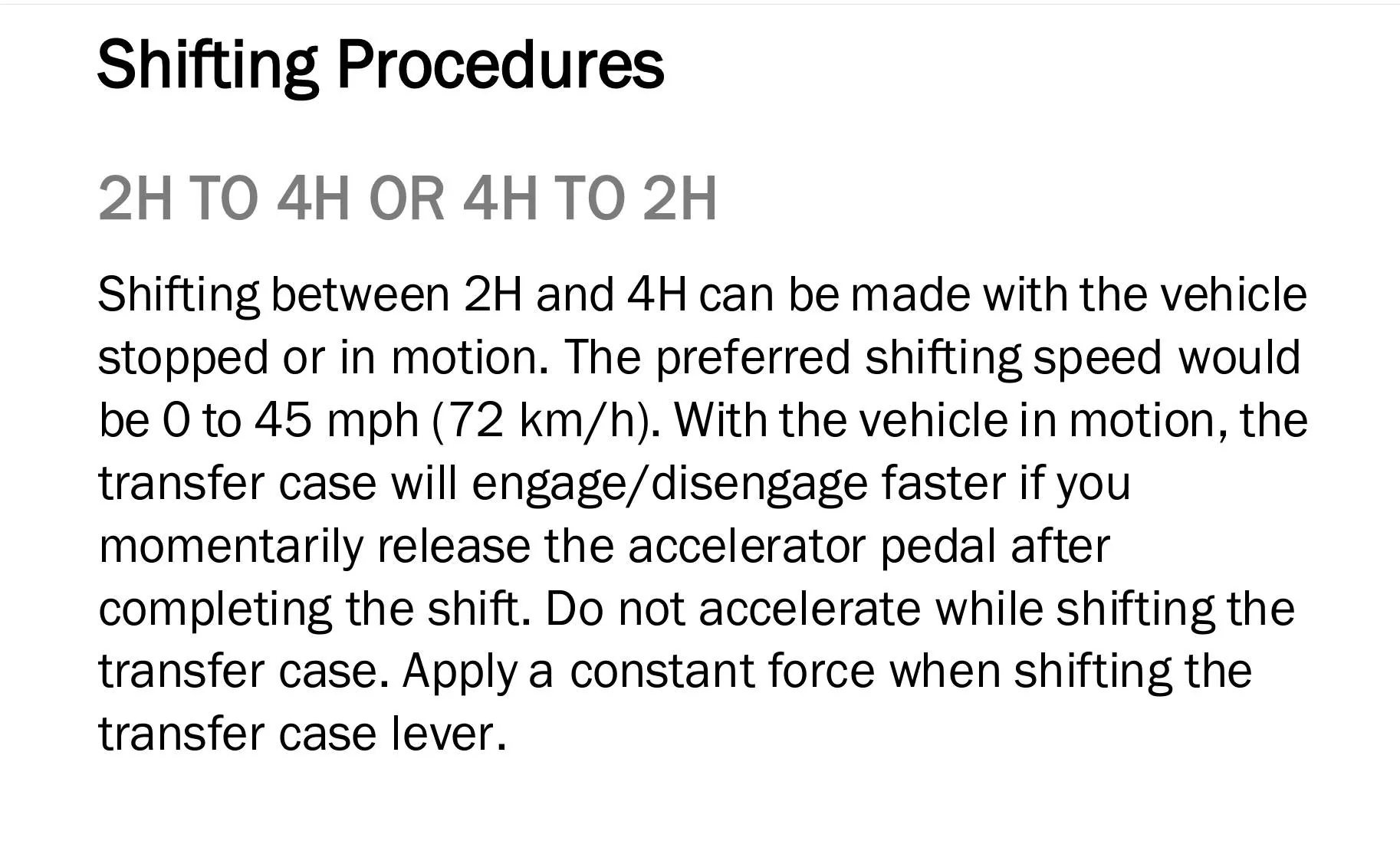

I thought I read in the manual that it is recommended to be moving with transmission in gear when going from 2H to 4H. 4H to 4L, transmission needs to be in neutral and the vehicle moving under 5mph. I have a 21 Rubicon, so not sure if different than the sport.
Would the manual's instructions change on this point from year to year between your 2021, his 2022, and my 2024? If not, I can easily post scans of my 2024 manuals here if it helps.
And, within a given model year, would this advice change between trim levels? I wouldn't think so because only a single manual serves a given model year, right?
