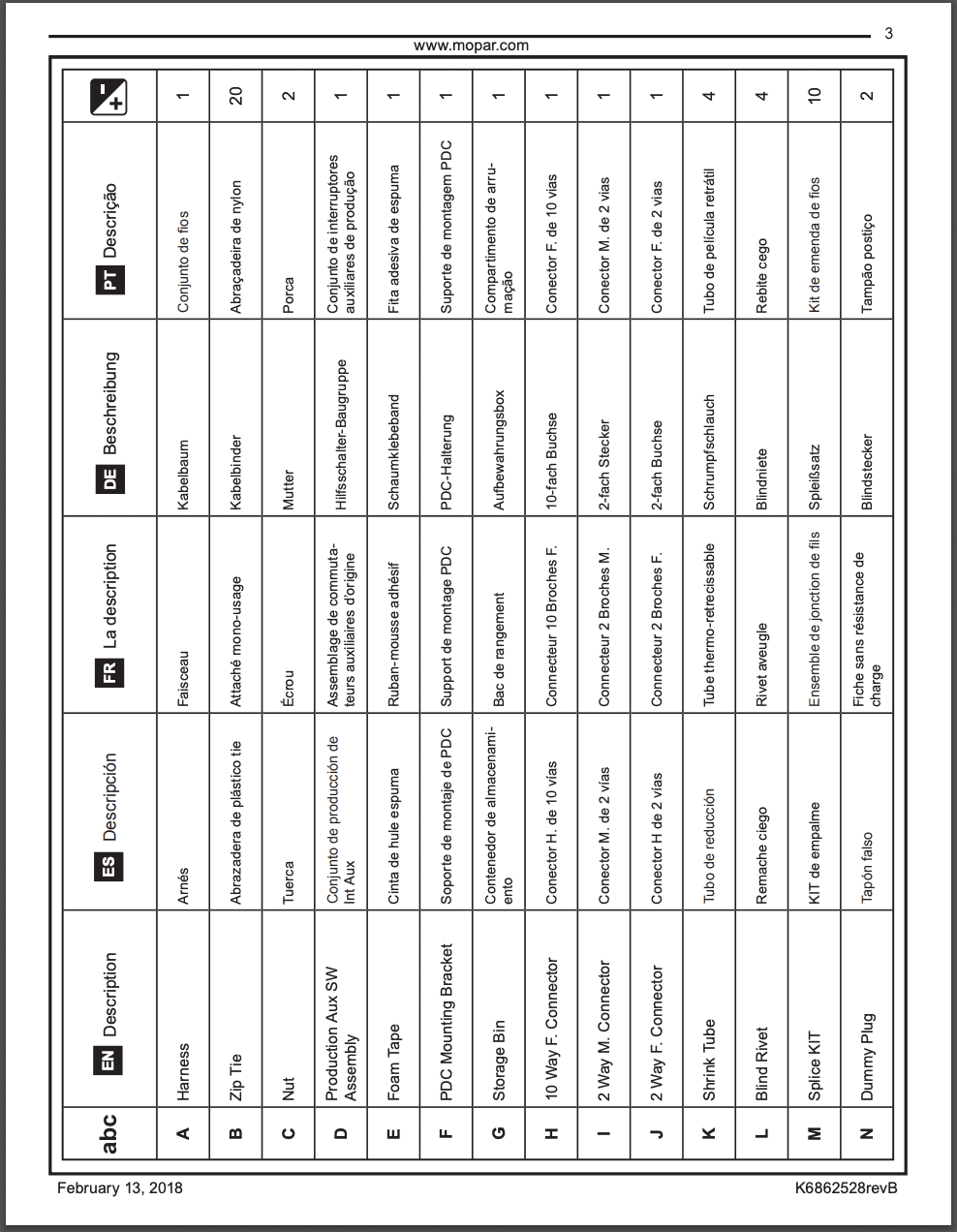

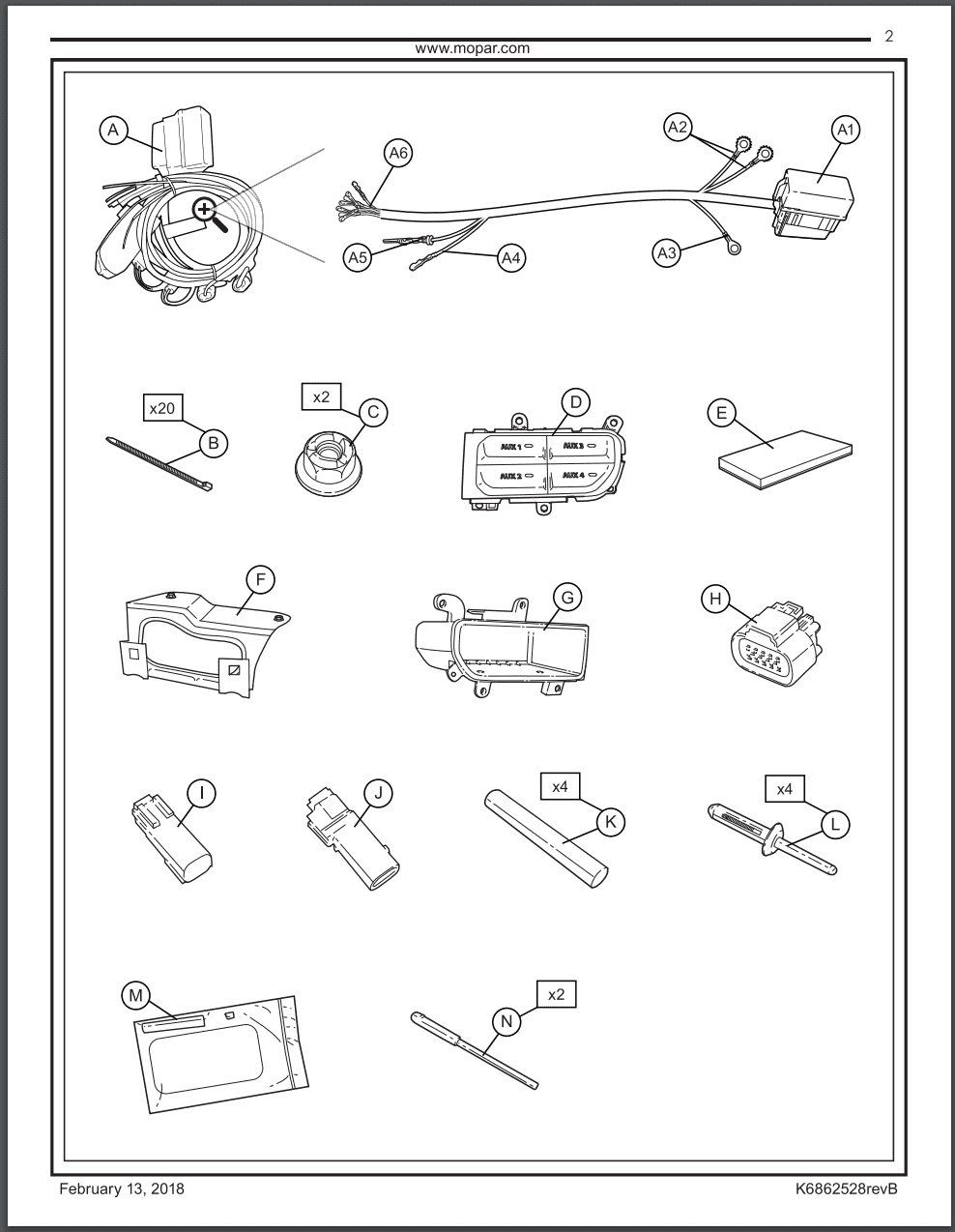

Looking for an assist. I've scoured the internet to find a proper part number for the Mopar Aux Switch instruction book Part H: 10 Way F. Connector. Needless to say I managed to destroy the plug that came with my kit, leaving my switches inop. Need to re-wire the connector and replace plug. I think that Mopar: 68137859AA gets me close, but I can't verify for sure. Anyone have a schematic or know of a good part number?

Ok. I'll answer my own question. Mopar: 68137859AA works.
