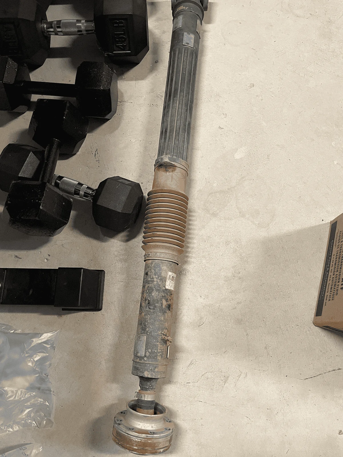

1. From what I have read, most people seem to agree that a new driveshaft isn't required for a 2.5" MC lift. Once you step up to 3.5" of lift, the consensus seems to be that it is time to replace the DS. Considering you indicated your at the beginner skill level, you may want to save the cost of the DS and invest in some armor or a winch, if you don't already have it.
The MC lift, both 2.5” and 3.5” lifts have essentially the same free length springs, only about a 1/4” difference. The extended length of the shocks is what determines the need for DS….. Since the Rocksports are sold and used in both lift heights you can need a DS with the 2.5” lift as well as the 3.5”……be careful what you decide to believe on the interweb, there’s a lot of misinterpreted information out there……
Yup, even the longer SP2 3.3s are running the ragged edge of needing a new driveshaft at 28.5”. I scrubbed the stock slip boot on the trans skid just under that length.
