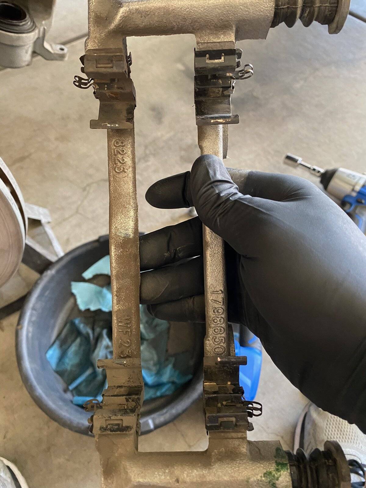

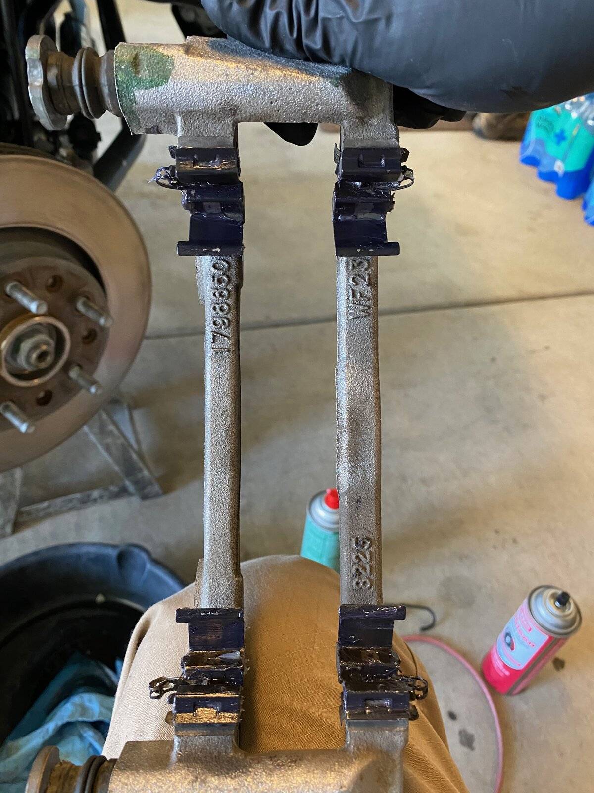

Within the first 5k miles, my 2018's brakes would squeal/chirp upon light brake pedal pressure. I took both front and rears apart and found the brake pad clips to be DRY. There appeared to be a black coating on the clip, which was flaking off. Best guess is the coating was supposed to serve as some type of coating/dry lubrication. The guide pins were lubed.
I used Sil-Glyde on all of the pad clips and back of the pads/shims where they make contact with the piston. I also lubed the end (ears) of the pads. These ears sit in the pad clips and are the parts which slide back and forth when the piston presses on the pad.
Those brakes were perfectly quiet for several thousand miles. I have since swapped them out for the PowerStop Z36 system. I lubed those the same and they too have been squeal/chirp free.
Worst case, if the brakes aren't what's chirping, you're not out anything but a little time. Plus you'll know your disc brake parts are properly lubricated and will operate correctly.

DRY:

LUBRICATED:

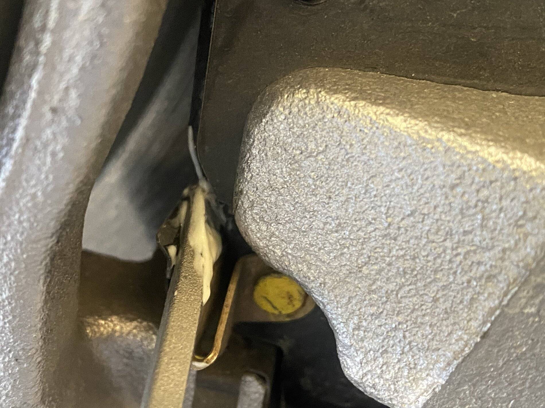

I added a few pics of what my before and after in case you've never done JL brakes before.

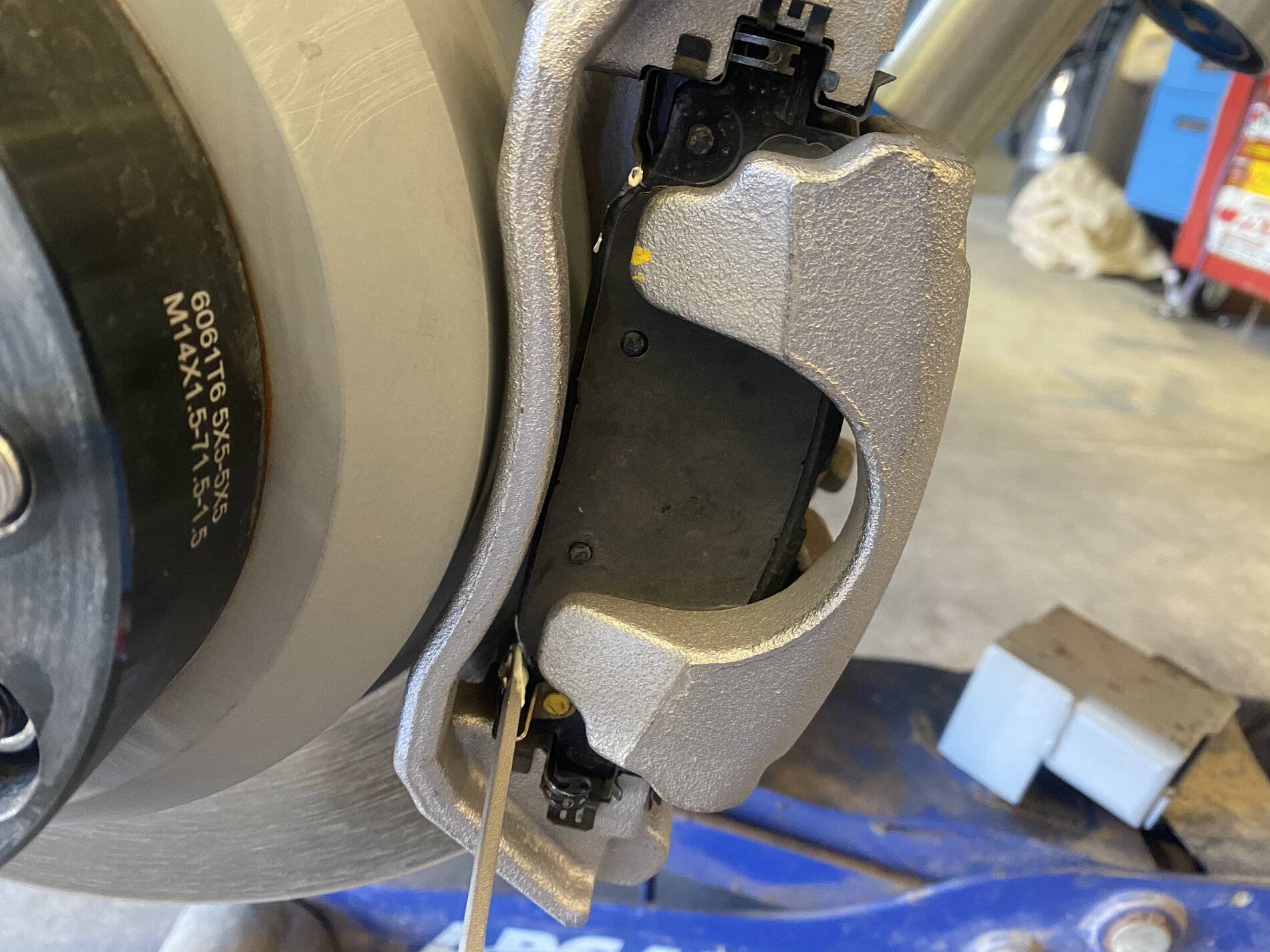

So I got all the wheels off today and cleaned and applied sil-glyde to the clips, back of the pads, shims, and other contact points. The only thing I didn’t do is the guide pins. They seemed springy and well greased, so I left them alone. I only have 5,000 miles so I figured it was fine to skip.
I noticed some wear on the top clips where the dog ears of the pads make contact with the clips. My guess is this was the main reason for the chirp, so I applied extra grease there.
Took it on a test drive around the neighborhood and it’s now quiet as a mouse fart. Very happy with the results. Hopefully they stay quiet for the life of the pads.
