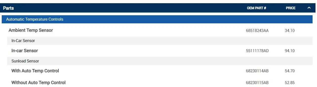

Do you have a part number? I'm only seeing the one sensor.

As far as I can tell, there is only one sensor and that's it. I'll shoot you the testing and install instructions. If they're gonna charge you $100 for it, I'd take the 5 minutes to test it out.

I have a similar issue. How do I test my sensor to verify if good ?
55111178ad - cabin air temp sensor
