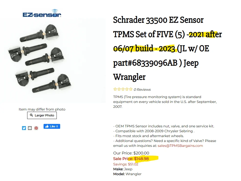

Good morning, looks like TPMSbargins has a sale for the newer versions:
Jeep Wrangler JL Buying take-offs without TPMS - can I add them? 1675169545589
