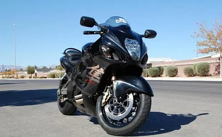

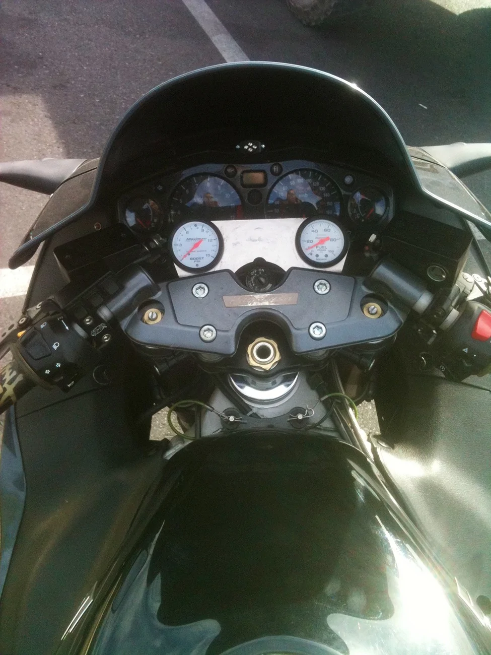

Do you have a real purpose for such a rig? Or do you just want one? Be honest.
I would get a V8 engine myself over a supercharger, those V8 combinations are proven with a LS powerplant or 392.
This is coming from a guy with a turbo on a hayabusa 311 hp. Sometimes want is all that is needed.
