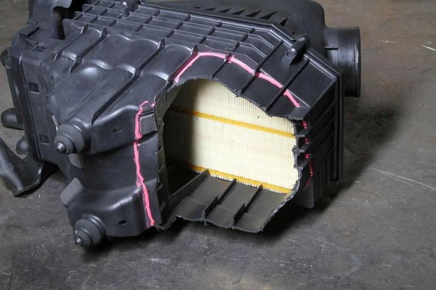

So, Hamburger claimed a wee smidgen back that they had a supercharger over at Jeep, in an attempt to be the "official Jeep supercharger." (Linked the video and jumped to that part with that claim.)
How do you guys think that will go, with cutting a huge hole open in the bottom of the airbox being one of the installation steps? Can't imagine that's beneficial to water fording capabilities, and not sure what Jeep themselves think of that either.
Jeep Wrangler JL Hamburger's Supercharger..? 26-jeep-jt-gladiator-supercharger-installation

Looking at the vid and the picture, you need to cut up the filter box, lower the sway bar (not sure how this would work with a Rubicon) and weld the oil cooler behind whatever bumper you are running... I don't see how this could become the official Jeep supercharger with that much hacking up.

Agree. I see it as back yard engineering and poor execution. No thanks.

Seriously? That's an easy fix! Duh!

I agree, although I see why it requires so much modification. Although it LOOKS like just any other centrifugal SC, it's NOT. I wouldn't want to hack my Jeep up with such commitment even if I never plan on reversing the mods...it goes against my grain.That being said, this is an oil traction drive "rotrex" centrifugal SC. That's what makes it unique. There is no direct connection between the impeller and the drive pulley. It uses a planetary roller system and special traction viscosity oil developed by Rotrex. Hamburger is one of a few dealers or licensees that market for them for various cars, including BMW. This setup requires a traction drive oil cooler system and an intercooler system, hence all the shoe-horning and cutting. The impeller spins more than 30 percent faster than a gear driven model and is silent. The SC can be much smaller and still be more powerful, providing 3-4 x more boost also. If any OEM were to choose a centrifugal SC, it would certainly be this one...but the vehicle would have to be designed with all it's requirements in mind. For low end power I think that a twin screw is the way to go, but I haven't seen any torque curves... apparently they are all kept under lock and key.
