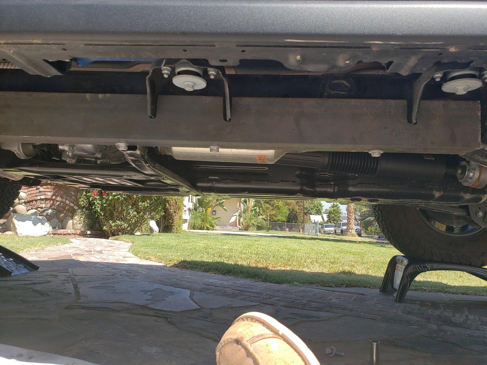

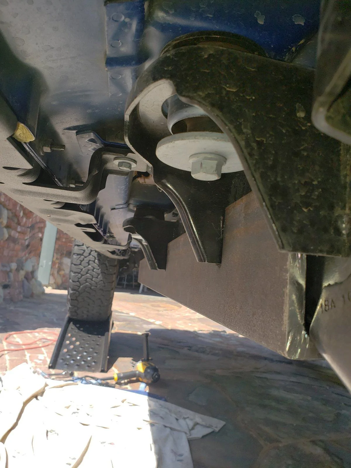

First rail bolted up for fitment. Bolt heads will end up being flush when bellypan is complete. Moving to other side then each side will get 4 bolts to frame as well. Side step/slider mounts will bolt right to this new rail as well.

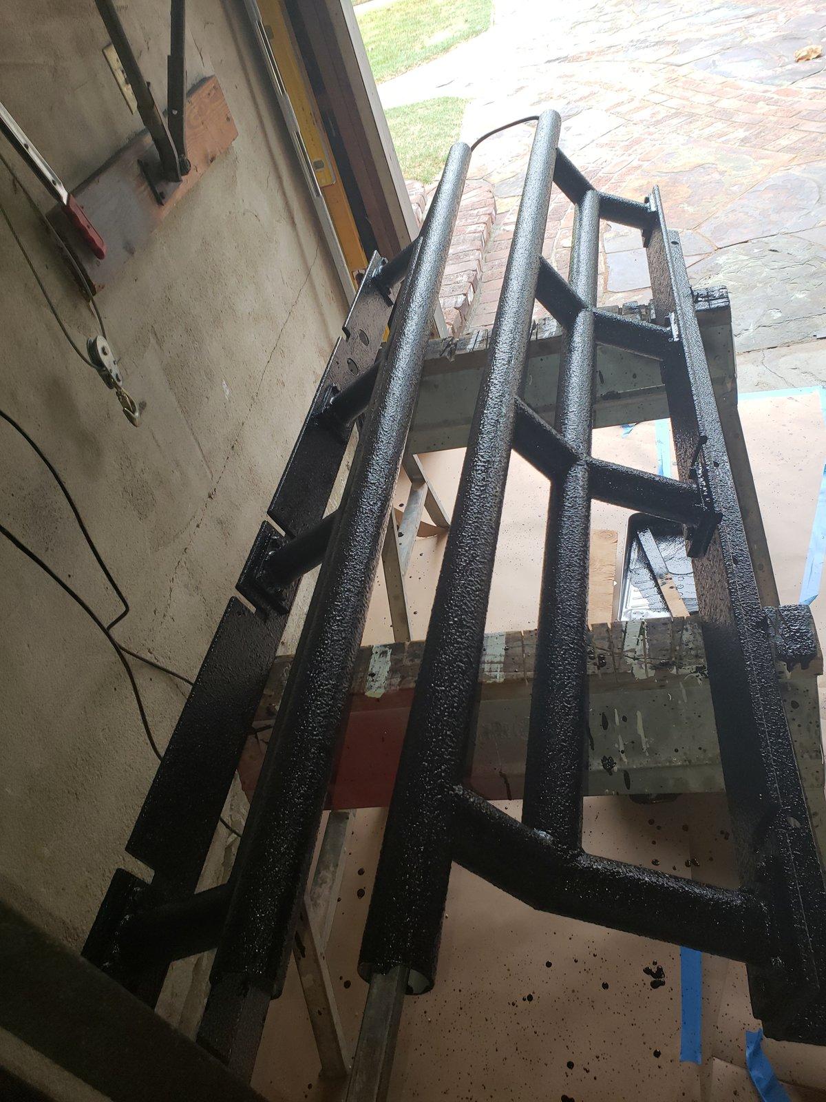

First of three coats of Herculiner. Will have stainless removable skins on underside.

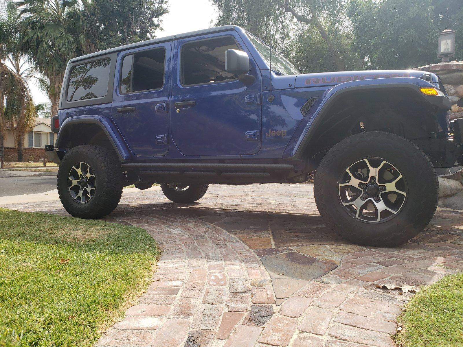

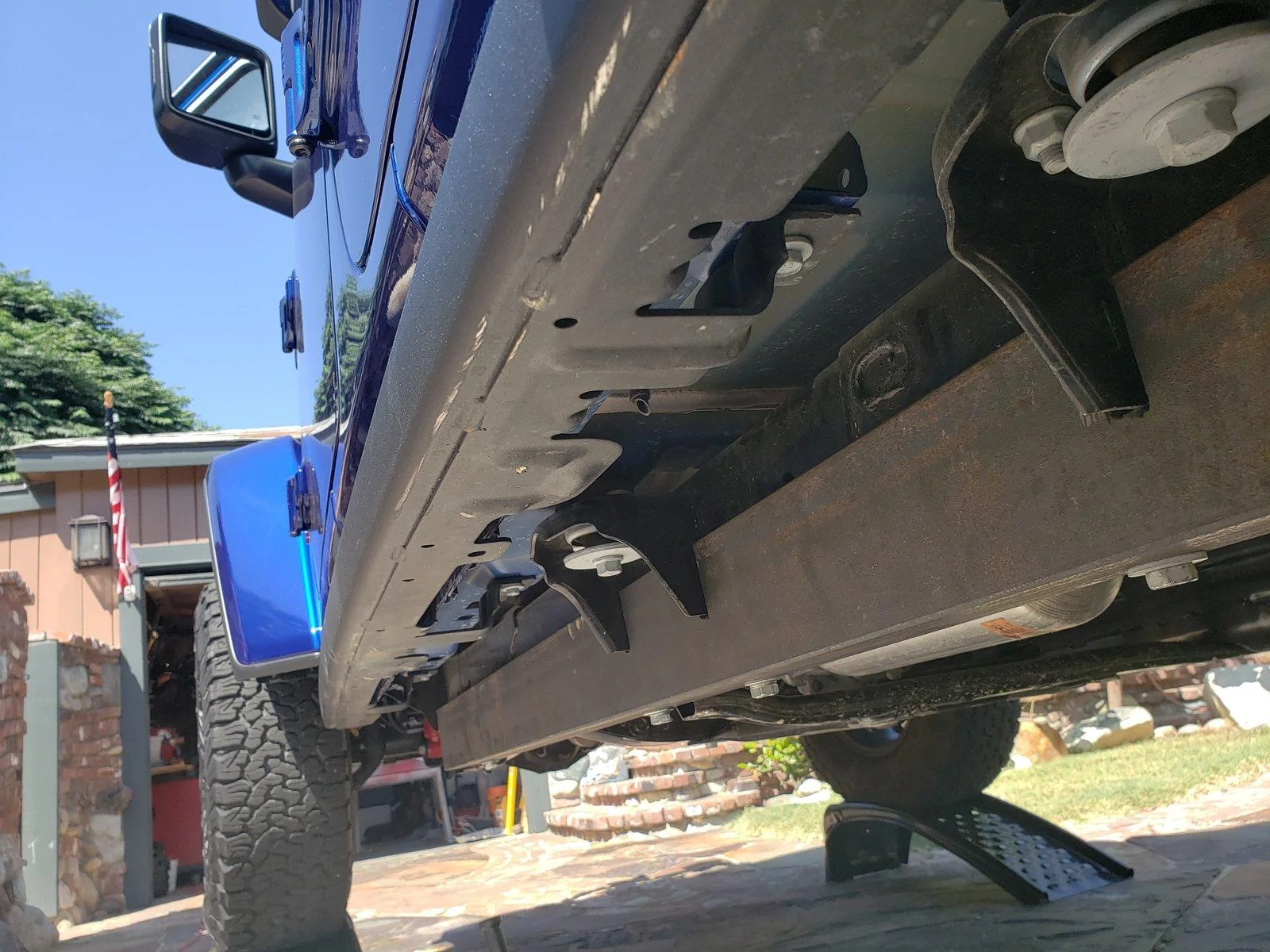

Slider / steps installed. Still need to add replaceable stainless panels along bottom but you get the idea
