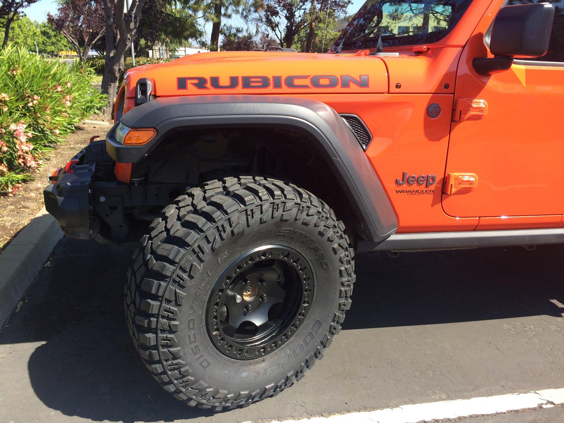

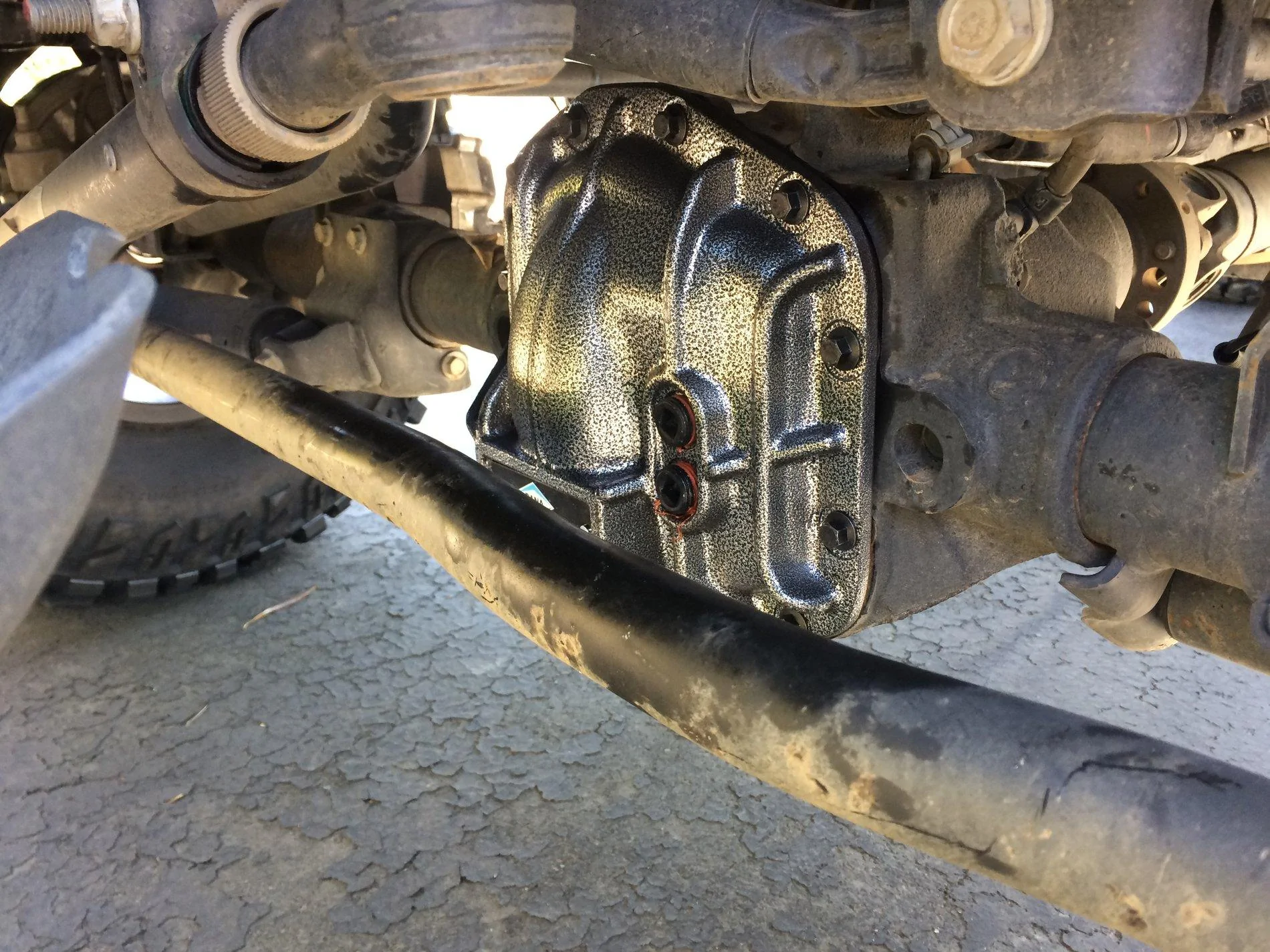

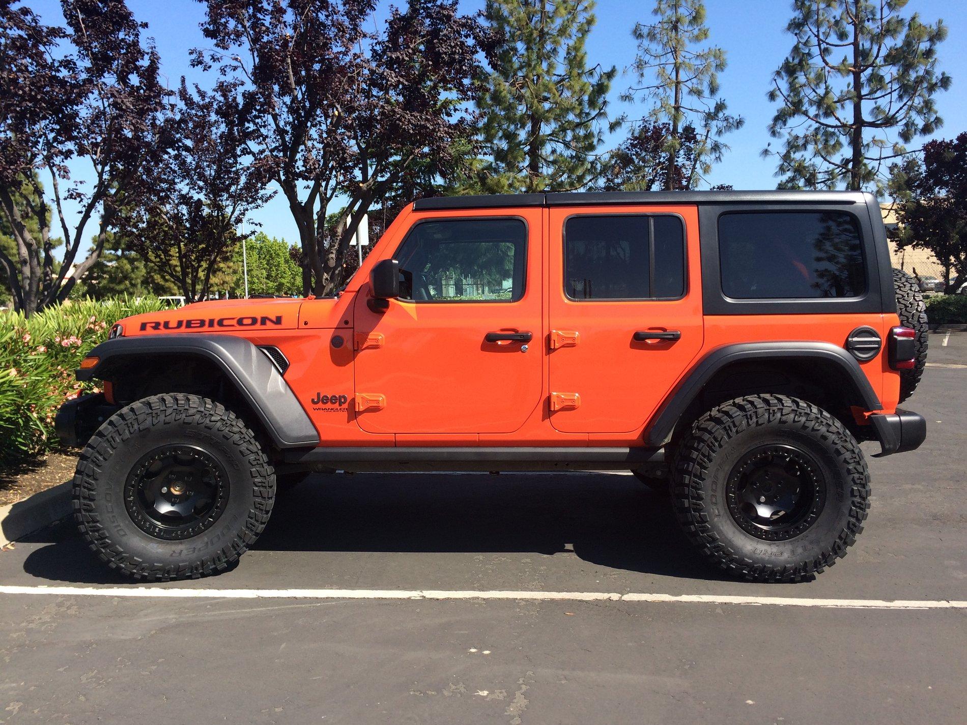

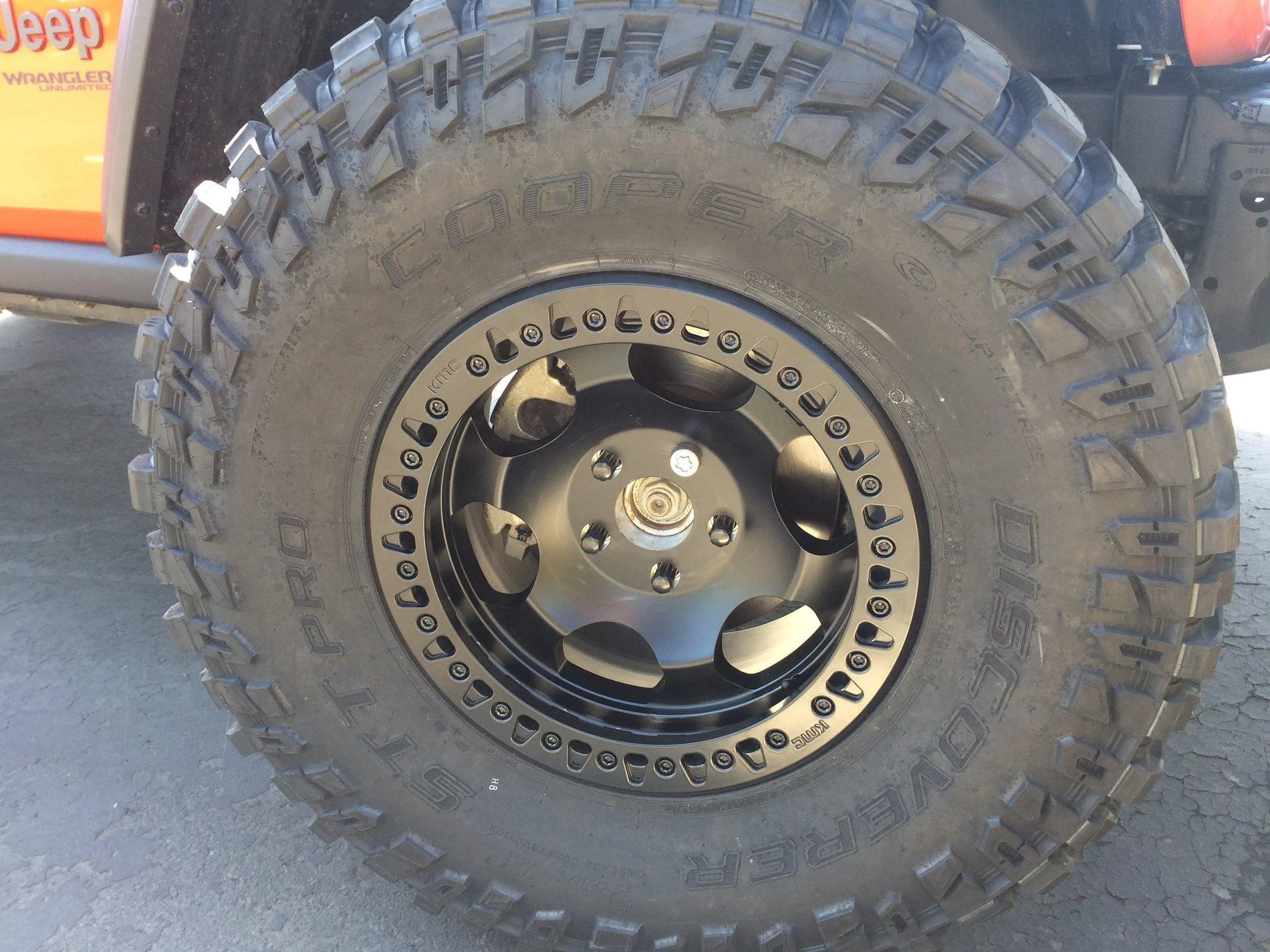

Got the beadlock with 37 coopers on today with diff covers

Sweet Punk'n looking good!

Damn son, nice looking ride. I'm still undecided on diff covers, but I may upgrade considering how much of a beating mine have already taken thus far.

my front cover had taken a couple good shots and bottom bolt was rounded off already so we will see how these take a hit

Is that stock height with 37's or did you put a lift on it? If so what did you go with?
rough country 2.5" lift

Looks gorgeous. Punk N’ was a close second choice for me. Any rubbing on your off-road adventure. You just sold me on Going with 37’s. Offset and backspacing on wheels?
Great job!

4.75 offset and no rubbing in front and had to remove lower rear cover and slight heat gun to rear liner

@Mud2Sno Did you need any sort of driveline modifications to avoid vibrations? I know with TJ's it was anything more than 2" you would need a transfer case drop kit or a new driveshaft and adjustable control arms. I know the longer wheel base rigs can get away with a little more, just not sure

No drive line modification was needed and can fully flex out
