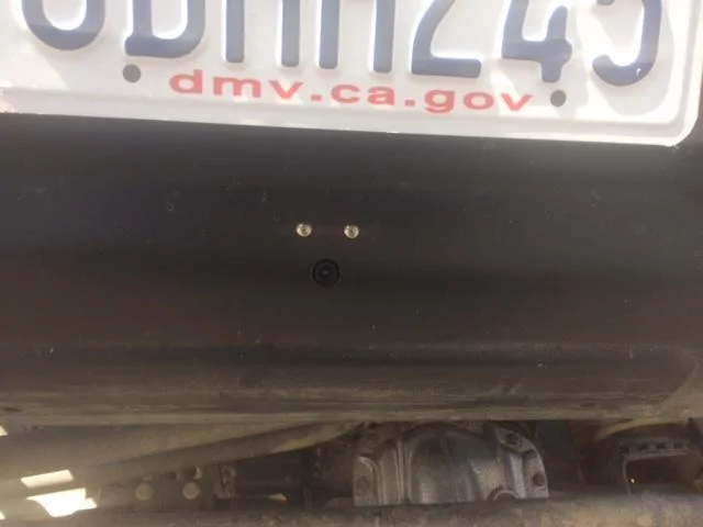

Was the front camera a pia to install? Do you have to use a Mopar camera?
I have the Tazer and the Tazer RCA plug and you have to remove the head unit to connect to the headunit plug then mounted camera in sway bar skid plate. the resolution is not as good as the rear camera but just need to see rocks, see the pictures as the one with the planter my left wheel was just hitting the curb

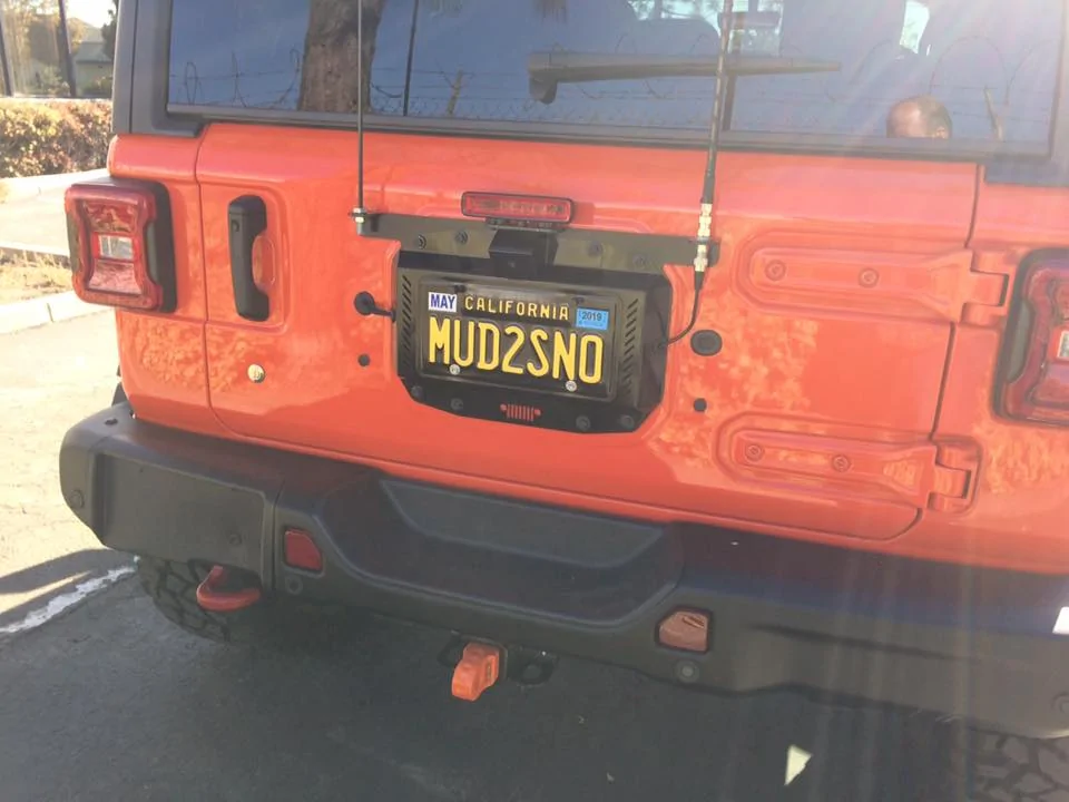

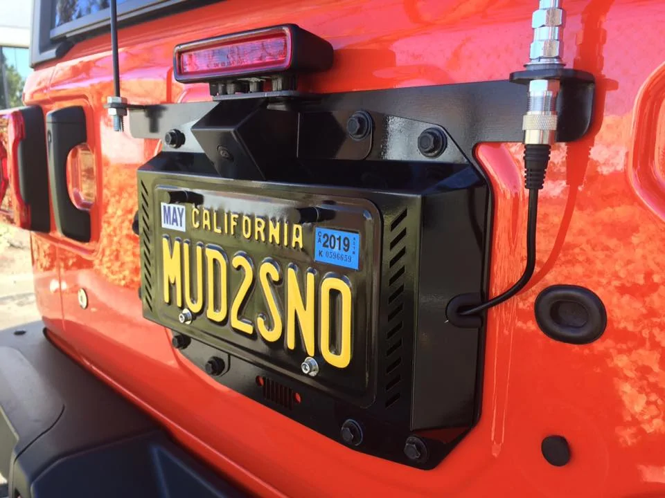

Made a licence plate relocator bracket and camera housing also used stock third brake light in this design. this design allows me to have the bracket for my CB antenna and a flag for the sand dunes. I didnt like the ones online as the mount the camera lower and don't utilizes the stock third brake light, added the JL grill on the bottom that lets the orange come thru. Next upgrade will be the new rear bumper so I wont have to worry about losing the rear plate anymore as all the plastic tabs are broken.
Wow, now that's uber impressive. Sometimes I wonder why the "vendors" don't design things with the features people want, like you've done. Kudos on a great job!
Oh, and the Punk'n is bad*ss, stands out in the crowd.

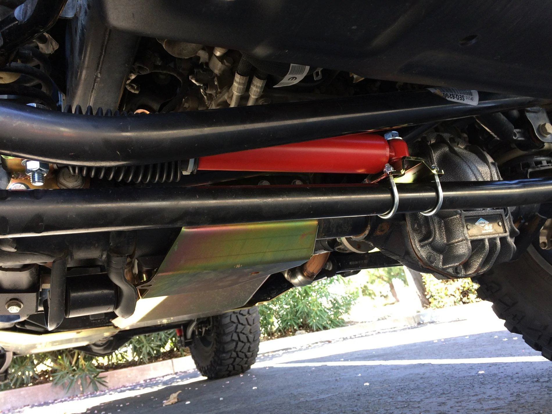

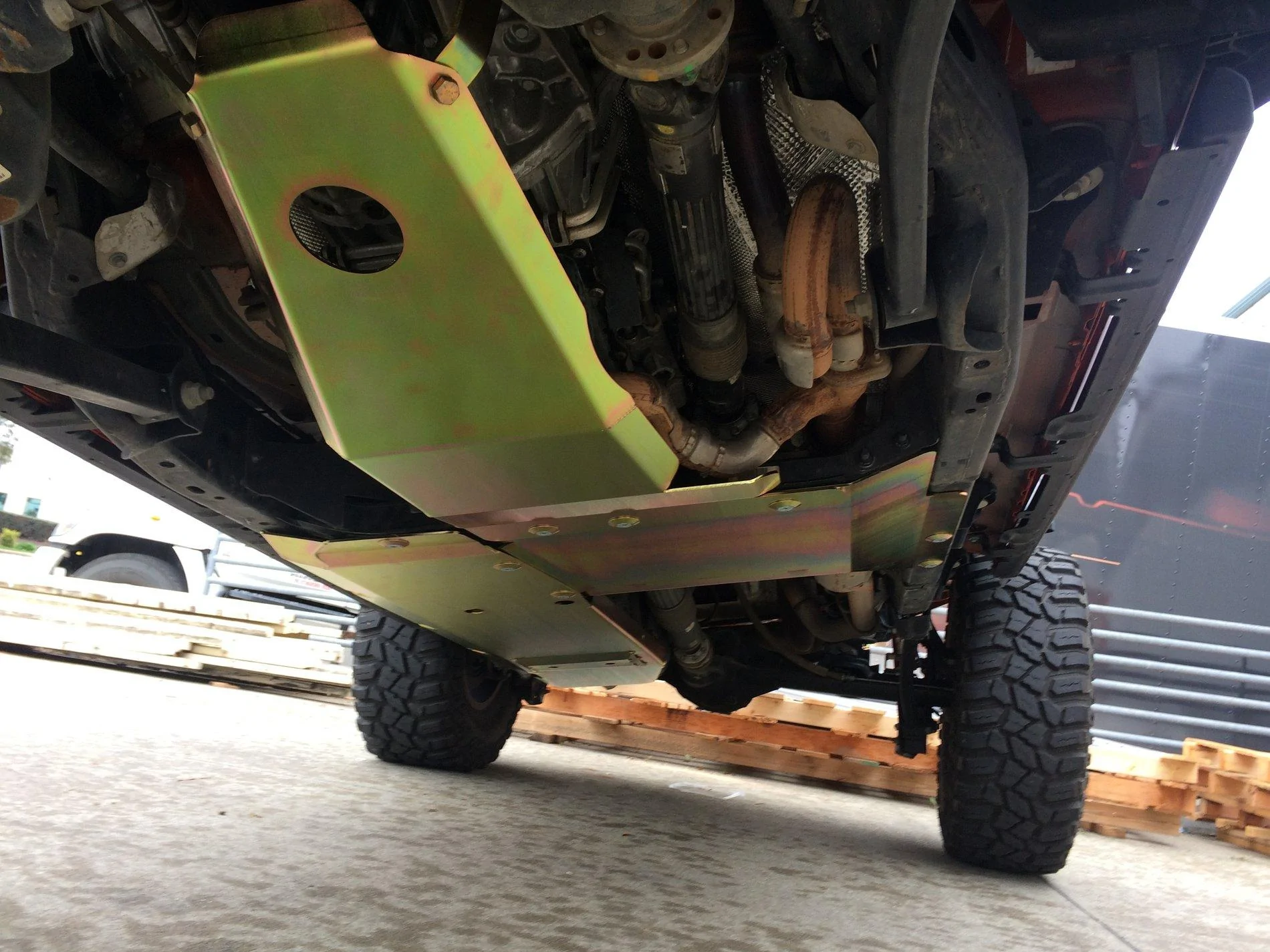

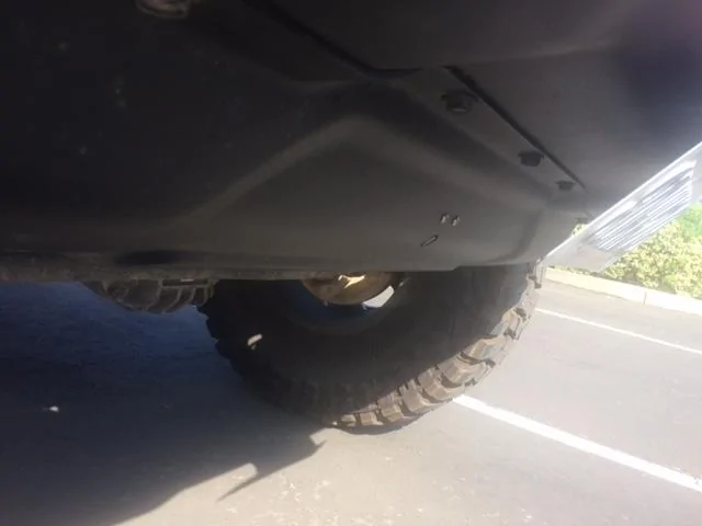

couple more upgrades on the underside and back
