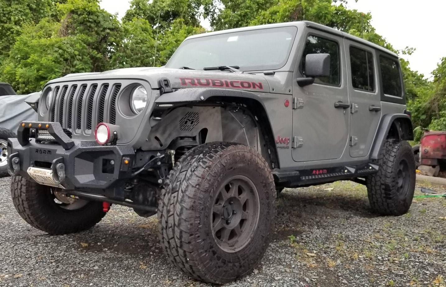

Here are a couple pictures of mine on Method 701s with 35s and a 2.5 Clayton suspension. If this is the kind of "poke" you are talking about, the Methods are a great option. Before I put on the suspension the 35s worked great and did not rub at all for normal driving or mild offroad. They did rub a bit when I got really twisted up in rocks.

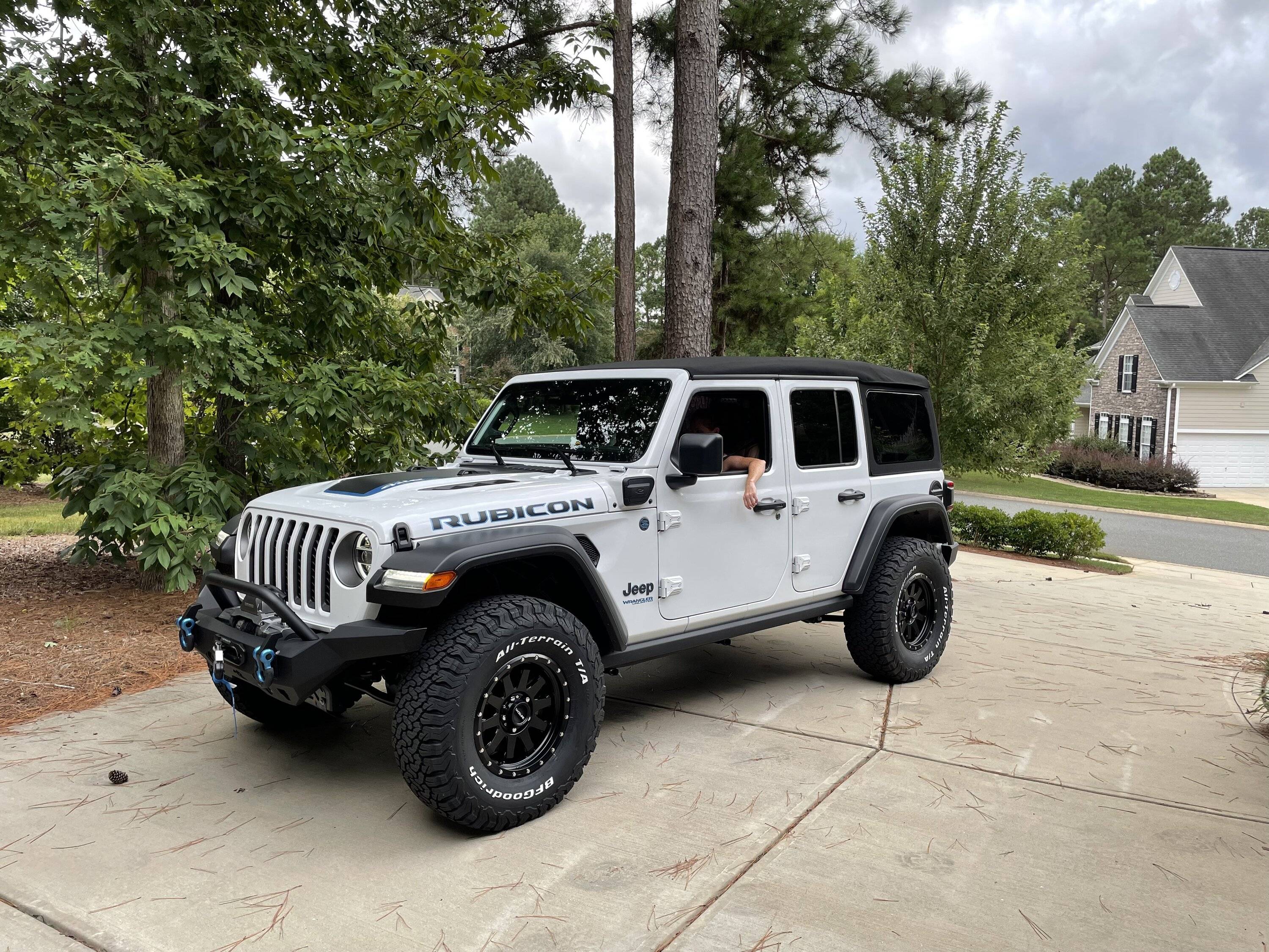

Here’s pre lift and first set of tires for comparison, 35x12.50, 17x8.5 +18
