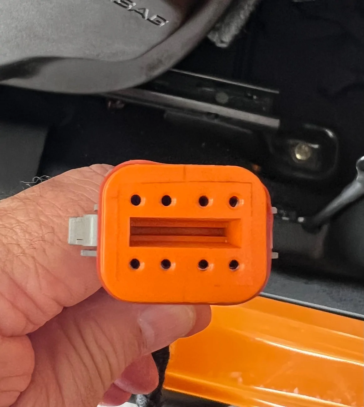

I’m installing an aftermarket BSM - Blind Spot Monitoring System in 2-door JL. I’ve installed the LED taillights with the BSM sensors, the SUMA side view mirrors with BSM and turn signals (turn signals are working fine). Now I’m installing the wiring harness. I’ve plugged in all the connectors except for the one in the attached photo. This one goes somewhere either in the door or under the dash but I can’t figure out where. Any help would be greatly appreciated. Even if it’s just identifying the male connector or the part number.
Thanks in advance.

Never mind, as I started cleaning up, I realized I had additional cables that are part of the complete harness kit. One is a split cable that connects to the male connector displayed in my attached image. Then there are two additional cables, one that goes to the driver’s door and connects to the direct mirror cable connector as spliced connectors. There’s a similar cable that goes to the passenger door with the same connectors. That cable also has a connector that attaches to the connector on the back of the cigarette lighter adapter to complete the harness installation.
I know this is more information than necessary but I thought it may help someone in the same situation.
If you’re looking to install an aftermarket BSM system in your Jeep (a Jeep that didn’t come with the Advanced Safety option), I may be able to now answer any installation questions.
