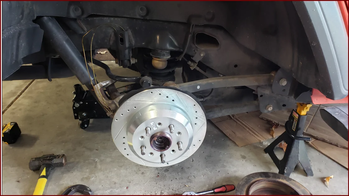

I just did mine back in April. Same thing happened. Smoked/warped the pads/rotor 700+F°, boiled my coolant at the fill tank (I thought i had blown a head gasket), now the jeep has a coolant smell when the engine bay heats up and I washed the ever living piss out of it. Replaced the Lines with OEM, upon install I can see the OEM lines failing again. The way they crimp the brackets damages the hose, its only a matter of time they start rusting internally. I upgraded the rotors to powerstop stuff.

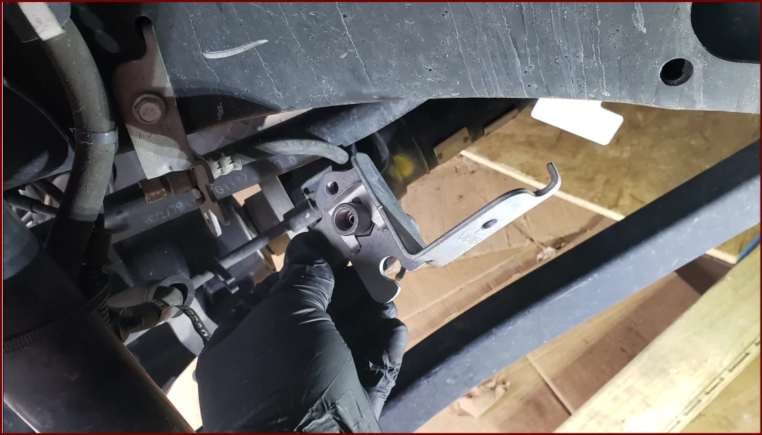

The repair was easy and straight forward did it solo. Pick up a Flare Nut wrench set so you don't round the nut that connects the line to the metal flare/tip when loosening or final tighten. Break the line loose before unbolting the bracket. Note it is a pain to get it started threaded back with the lube seeping.

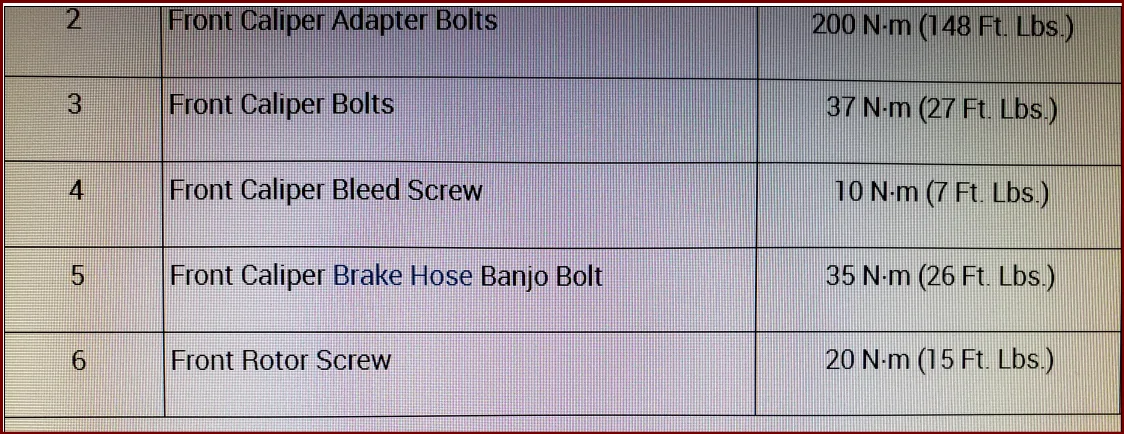

Torque vaules.

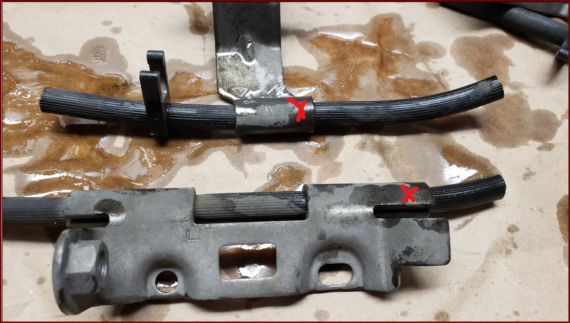

Red X is where the blockage is. Both front sides are guaranteed failing.
Wow good to see, thanks. I think I am going to order the Clayton COR-1309101 kit to replace the lines as I do not want to replace them with the same thing if they will fail again. I have a new caliper on order as well for that left side in case it is combination caliper and lines. If the lines are still good, might as well replace them while I am in there I guess.
