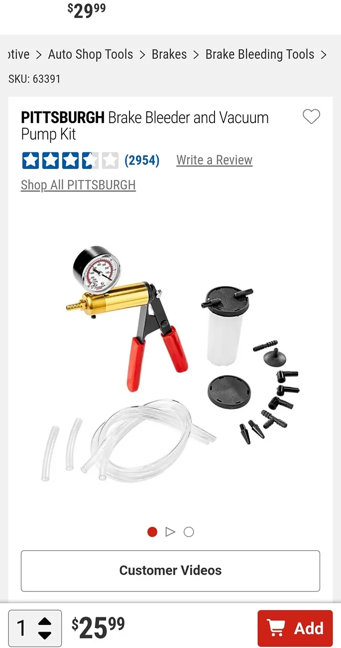

Guys, I'm going to Harbor Freights to check this $30 thingy. Do you have some recommendations? My Jeep is way up high, so I have changed my mind, I'm not going to the self-service shop. I can do it in my driveway. I will give myself a lot of time tomorrow, the weather is super nice too.

That should work put I have never used one. Put if you have air in the ABS module the only way to remove the air is with a scanner and doing an ABS bleed.

Just get a buddy to pump the pedal...open each bleeder 2-3 times to get new fluid in the calipers. Keep your eye on the fluid level...
