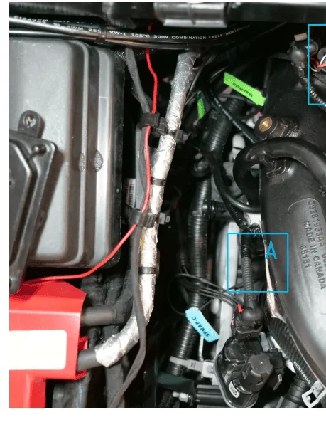

Awesome, I'm having the same issues, I tried checking it last night, but was looking at the MAP sensor, not T/MAP Sensor. Is that in the same intake area, not finding a good image of where it is.

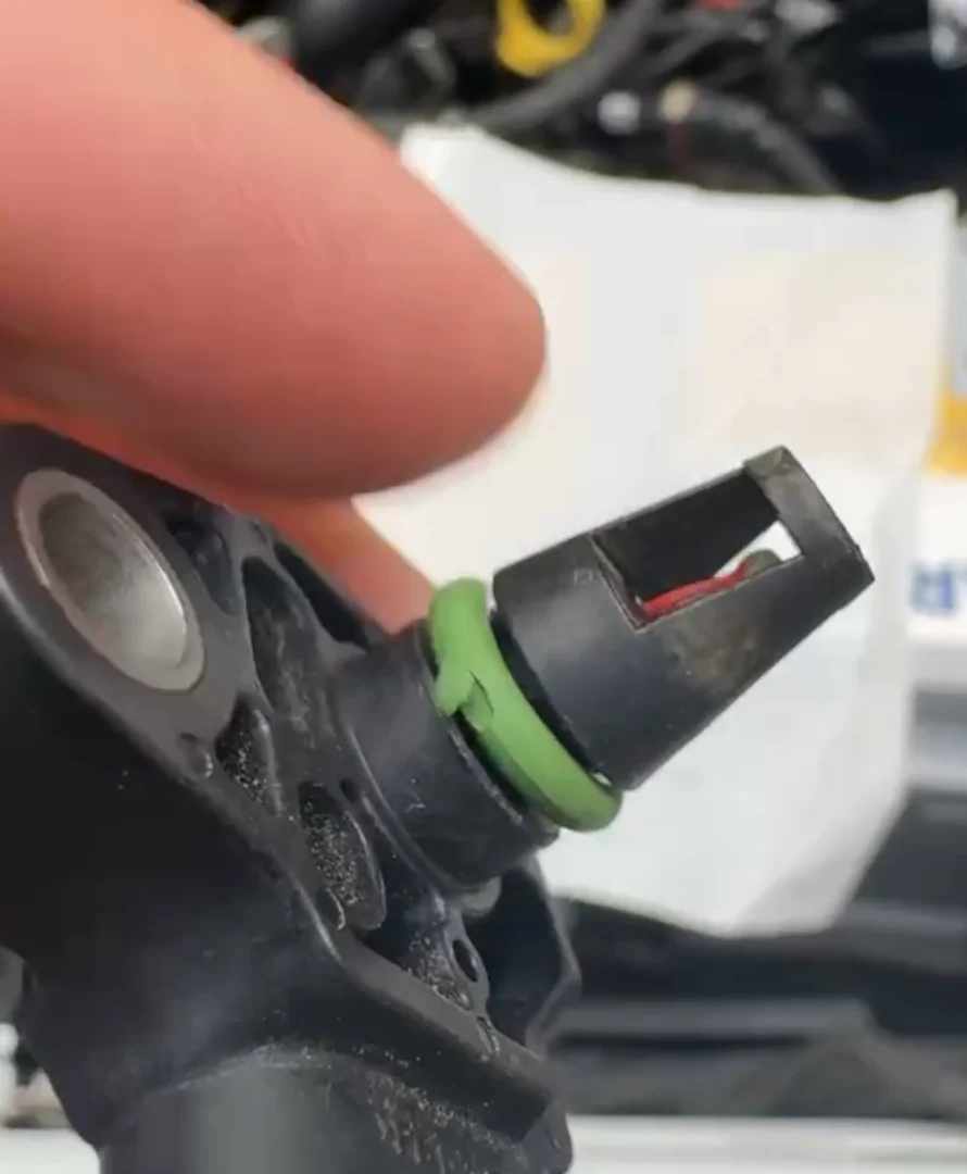

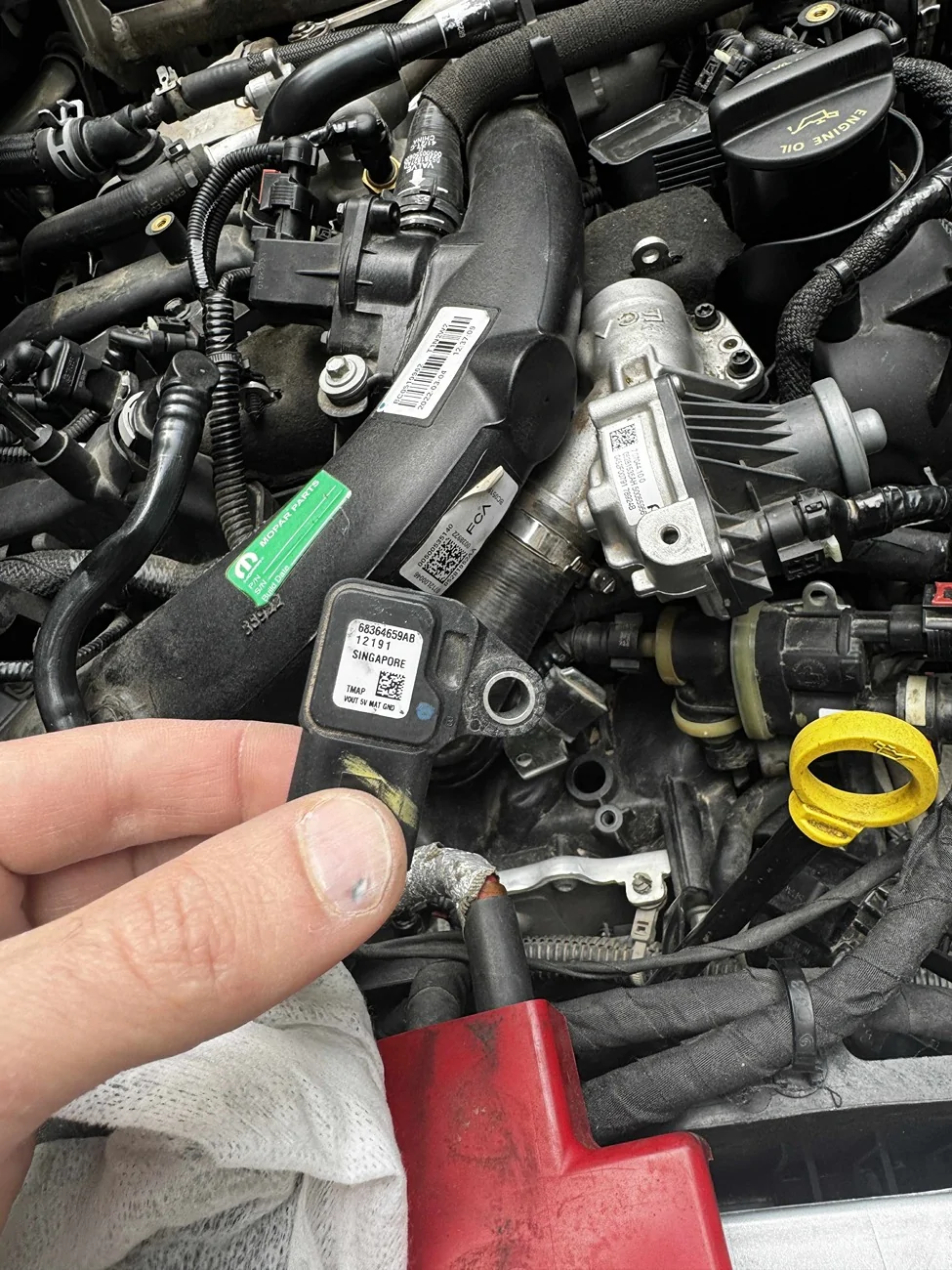

Once the purge solenoid is removed you can remove MAP sensor, but be careful not to damage the green o-ring gasket. I damaged mine when I was pulling it out.

Thanks! I appreciate the pictures! Looks like you just pulled it off the bracket? Mine was stuck hard on there so was considering just taking the bracket off. Looks like you can pull it off though! Haha Much appreciated.
