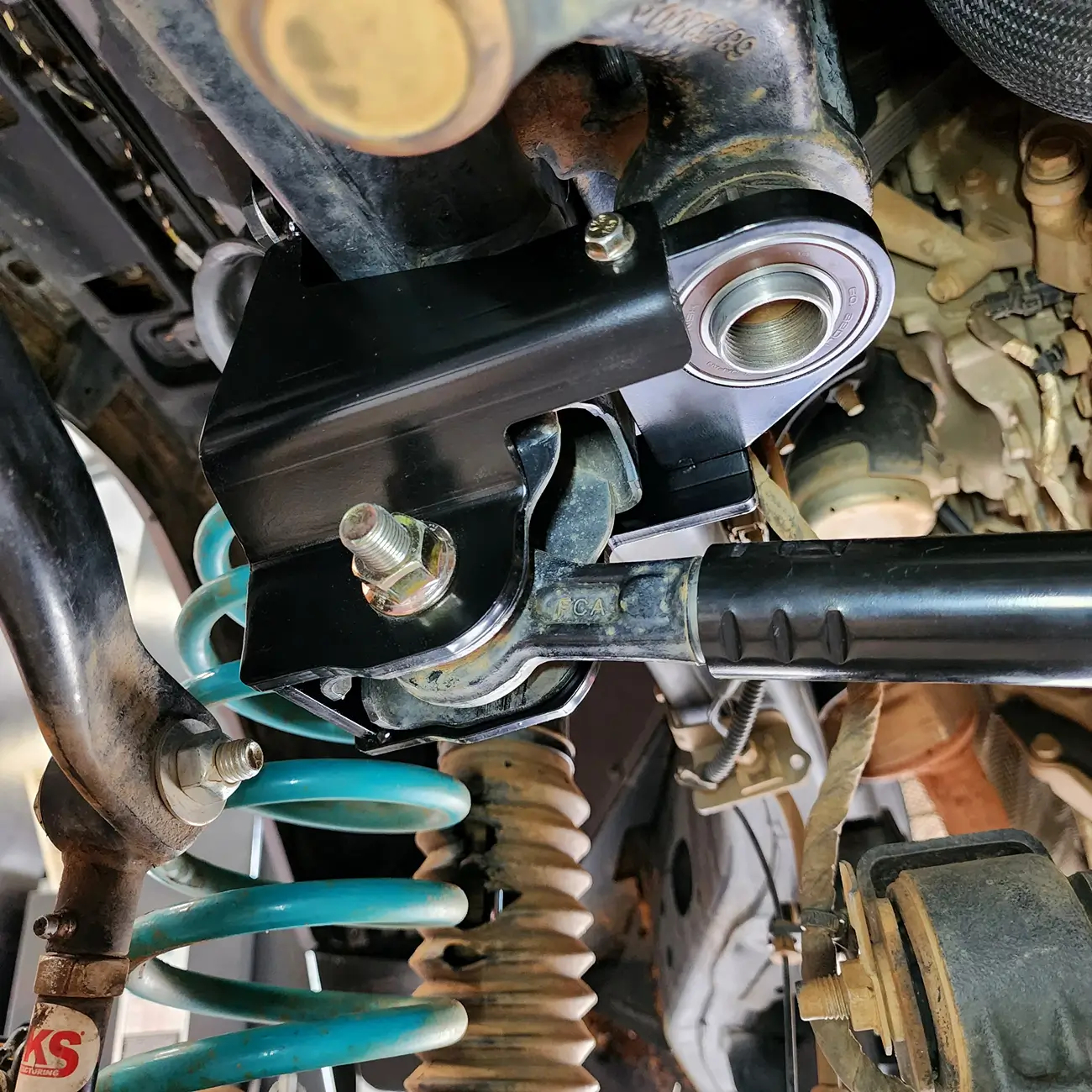

Well, I can say that Teraflex's front alpine trackbar fits RHD.. but.... I had to remove a little set screw in order to get it short enough. I put on a 2.5" lift today and the trackbar at its shortest length was about 3/4" too long.

I have the Toughdog front panhard, massive piece of kit and super solid, been running it for a couple of weeks and brilliant, I have the whiteline rear on the way. I only changed the front lower control arms, left the rest stock so no headlight adjuster issues for me.

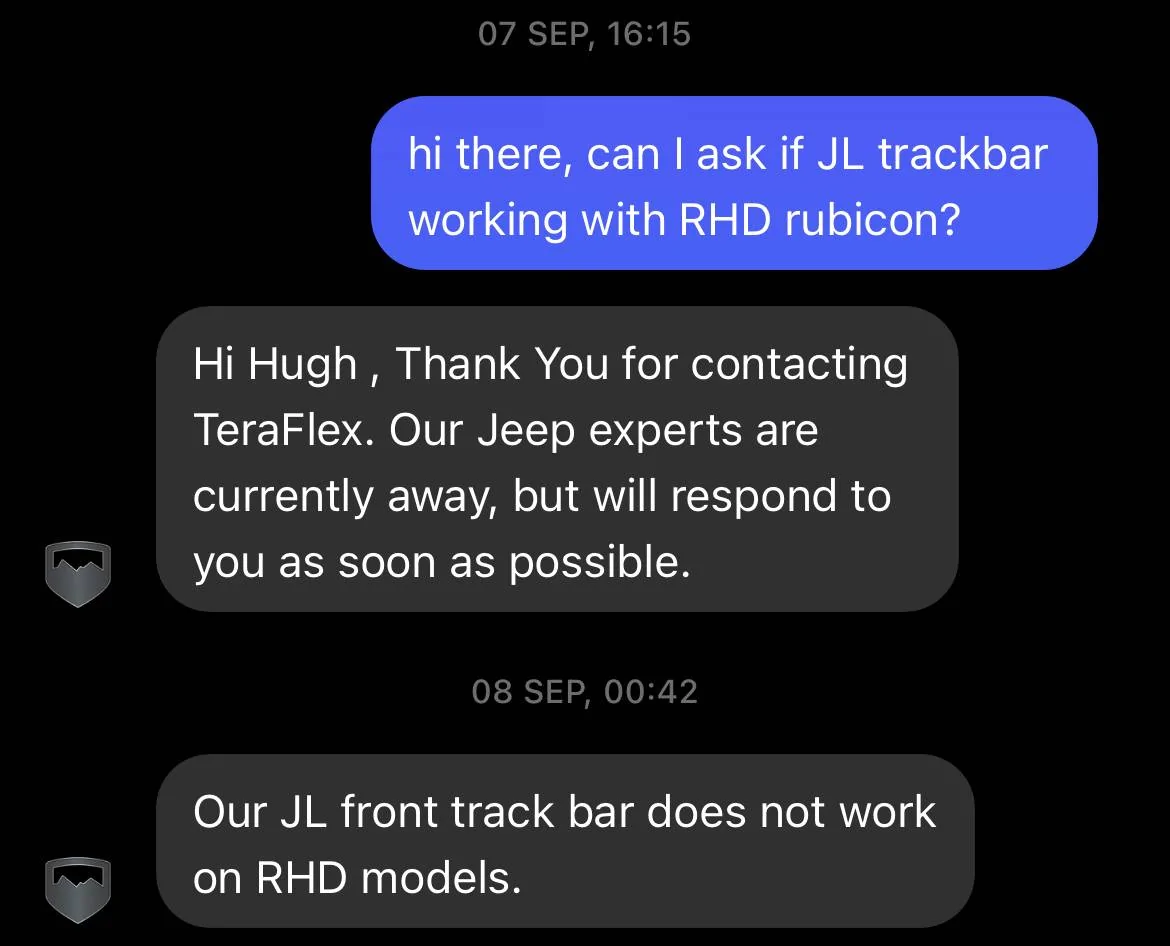

According to Joe Thompson, Teraflex's Int'l Account Manager, both their front and rear panhard are RHD compatible, but they also sell a rear trackbar relocation bracket, TF-1953601. I have their alpine 2.5 lift in the garage with the rear bracket, as soon as I get it installed I'll post the results.
Have you installed it? Any issues?
I asked them via message.. they said it wont fit………
:facepalm:

Get the toughdog one, sold locally in a lot of places and is a huge piece of kit, fits RHD as it was built for it, couldn't be happier with mine :) In saying that plenty are running the Teraflex on RHD but I have heard of some issues wit noise from them *I think* Teraflex may have resolved this though. Checkout some of the Aussie JL facebook sights as well for confirmation if you have no luck here.

Well, that's not the response I got from Teraflex. Below is the email I had received from them. But to answer your question COKENOGOOD, yes it worked for me. There is a small set screw that restricts how far you can turn the small end which had to be removed, just to allow a few more rotations to make the entire length shorter. For more than 2.5 inches of lift, maybe that would be unnecessary. Anyways, I couldn't be happier with it.
From Teraflex:
Wow sounds like you chasing parts for you JL around the world! So we do not have a lot of RHD items at this point. However, both our front and rear JL trackbars will work for RHD and LHD JL’s. We will be releasing our 2021 catalog soon then later on a RHD catalog but that is a bit off. Did you get that rear bracket from Jeepey.com? Also a good source is Japan4x4.
