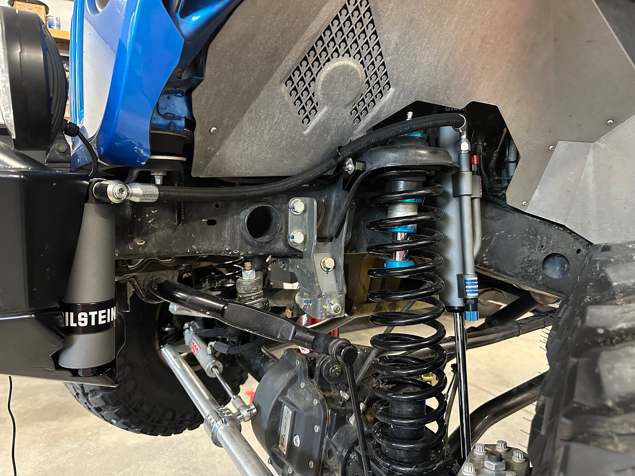

I recently installed a set and absolutely love them. They are silent as stated above. I’ve played with the adjusters a fair amount, but also know I could probably even get them better. I was bombing through 1-2’ whoops and sections of volleyball sized loose and implanted rocks at 30-40 mph like it was nothing in my last trip out.
The lower front mounts are offset to the rear and they come with brackets to move them outward on the lowers too. Check out the install instructions on their website. The upper mounts on front and rear are also offset outboard.
I did have to waller out the holes in the mounts for the rear reservoirs. They want to contact the bypass tubes at full droop & full articulation.

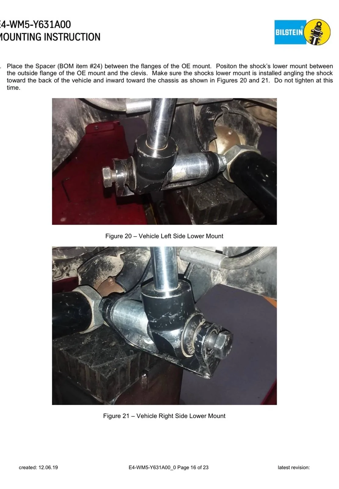

The front shocks come with a lower offset mount. In addition they require a wheel with minimum 4.5” backspacing. The lower mount only offsets horizontaland does not raise or lower the mount vertically.

I recently installed a set and absolutely love them. They are silent and stated above. I’ve played with the adjusters a fair amount, but also know I could probably even get them better. I was bombing through 1-2’ whoops and sections of volleyball sized loose and implanted rocks at 30-40 mph like it was nothing in my last trip out.

I had the hydro bumps before. According to Bilstein, you don’t need them. And since everything else they claim is 100% on point, I have no reason to not believe them. I do plan to drop the pressure in the bumps significantly. King suggests no more than 120 psi and I‘m over 200 because my old shocks were so blown out, I’d hit the bumps way too soon. I also plan to get rid of 1” of that bump stop extension you see as soon as I clearance my steering to allow more uptravel. Currently I have 1.25-1.5” of front shocks left to use at full bump. Then these will function even better!

Ahhh… okay on the shock mounts. I was considering using the new metalcloak offset mount that does NOT raise the connection point. But… now I see the shock eyelet has an angle to it so that’s probably not advisable. I’m guessing that’s to help clear the spring perch or something.

Larger body shocks will hit the frame when the axle is articulated. I had to modify things for the King Shocks I had before- King (and many others) just ignores the issue. Props to Bilstein For addressing it. The springs can also rub the front of the shock bodies. Bilsteins offset lower eye also helps with this.
