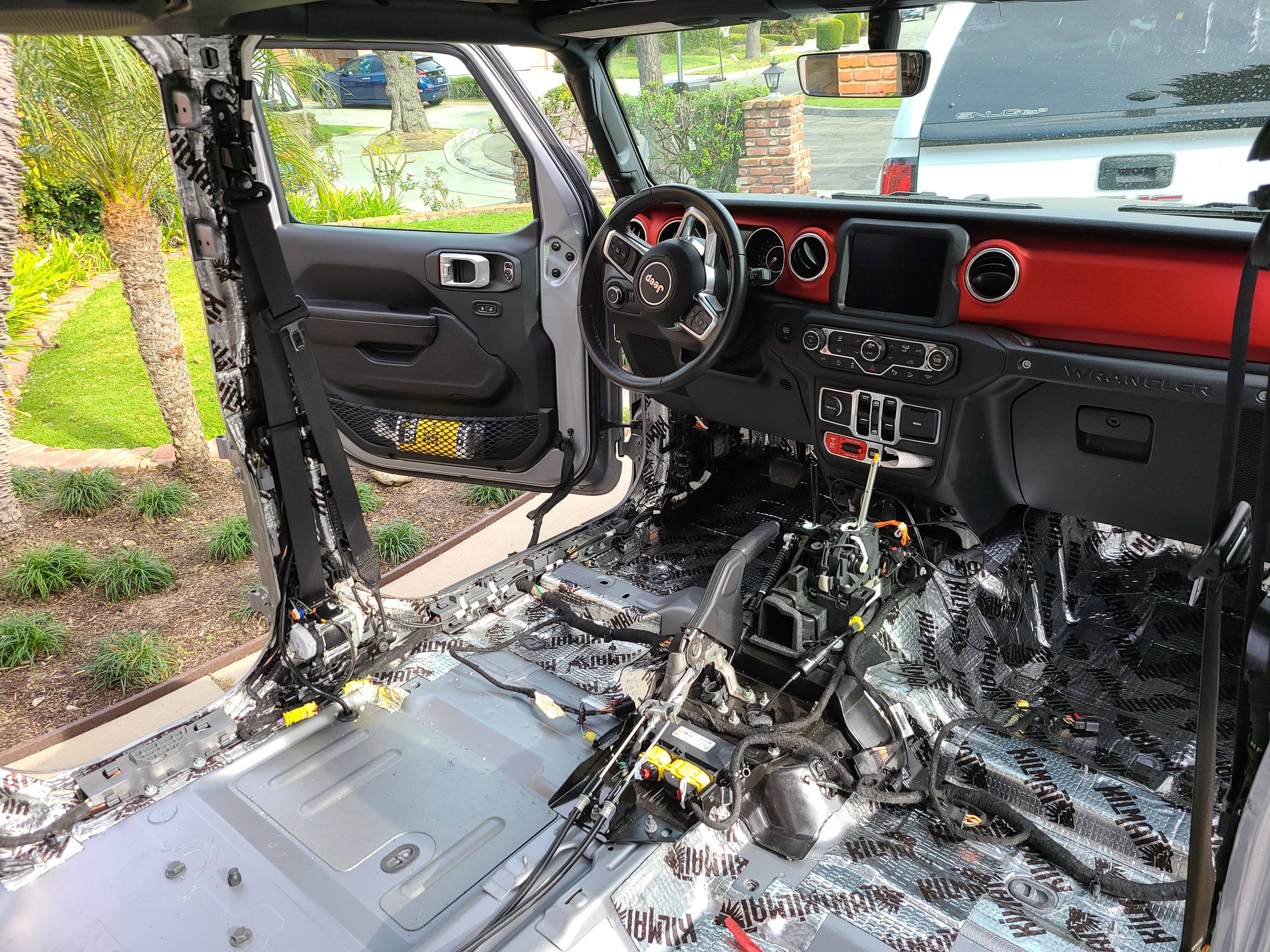

There's quite a bit of wiring and stuff in these JLs. Here's a sneek peek.
Jeep Wrangler JL Bedliner Discussion 20210112_105228
Jeep Wrangler JL Bedliner Discussion 20210110_133425

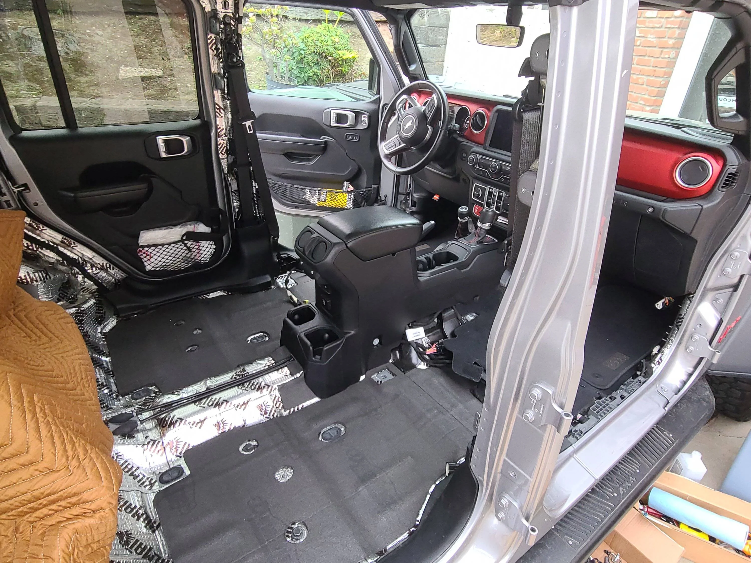

My interest was to reduce road noise from the floor. Considered bedliner, but it’s not nearly as effective as butyl rubber/foil materials. Then there's the issue of all the wires and systems that would need removal.
In the end, I considered it just a way to pass time during covid lockdown. I had it apart for a month. Cause I could and I did NOT work on it every day. 3 guys and some beer, could knock the job out in a few days. Maybe not as detailed as I did, but 90%.
Jeep Wrangler JL Bedliner Discussion 20210119_155840

Just a word of caution about who you get to do any disassembly to this level, it's not the kind of work a bedliner company is likely to have employees skilled and experienced enough for the task. There's a lot of systems in these vehicles that need care and knowledge to get apart without damage and back together properly. If you have electrical problems after the work, you'll likely be left holding the bag. That says nothing about all the plastic trim fasteners that can end up damaged and rattling later.
If you want dog hair protection, get those full floor carpet replacement matts above. If you want sound control, take it to a place that does sound control product installation and routinely disassembles vehicles to this level, so that they are more likely to have experience and skill to do it right.
It's a high risk modification that requires certain skills.
