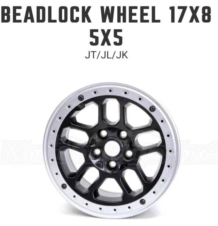

I ended up going with the Mopar beadlocks (ordered the other day)with the true beadlock ring. I like that I can run them either way (DOT rash ring or true beadlock ring). I like that there is a ring that can grind and if needed /desired replace for $100.
looking forward to airing down to under 10psi for the Pismo Dunes in CA...and other trail adventures.
It is my daily driver but I work from home so I only put on about 4,500 miles a year.So really not to worried about checking the bead lock bolts every 6 months.

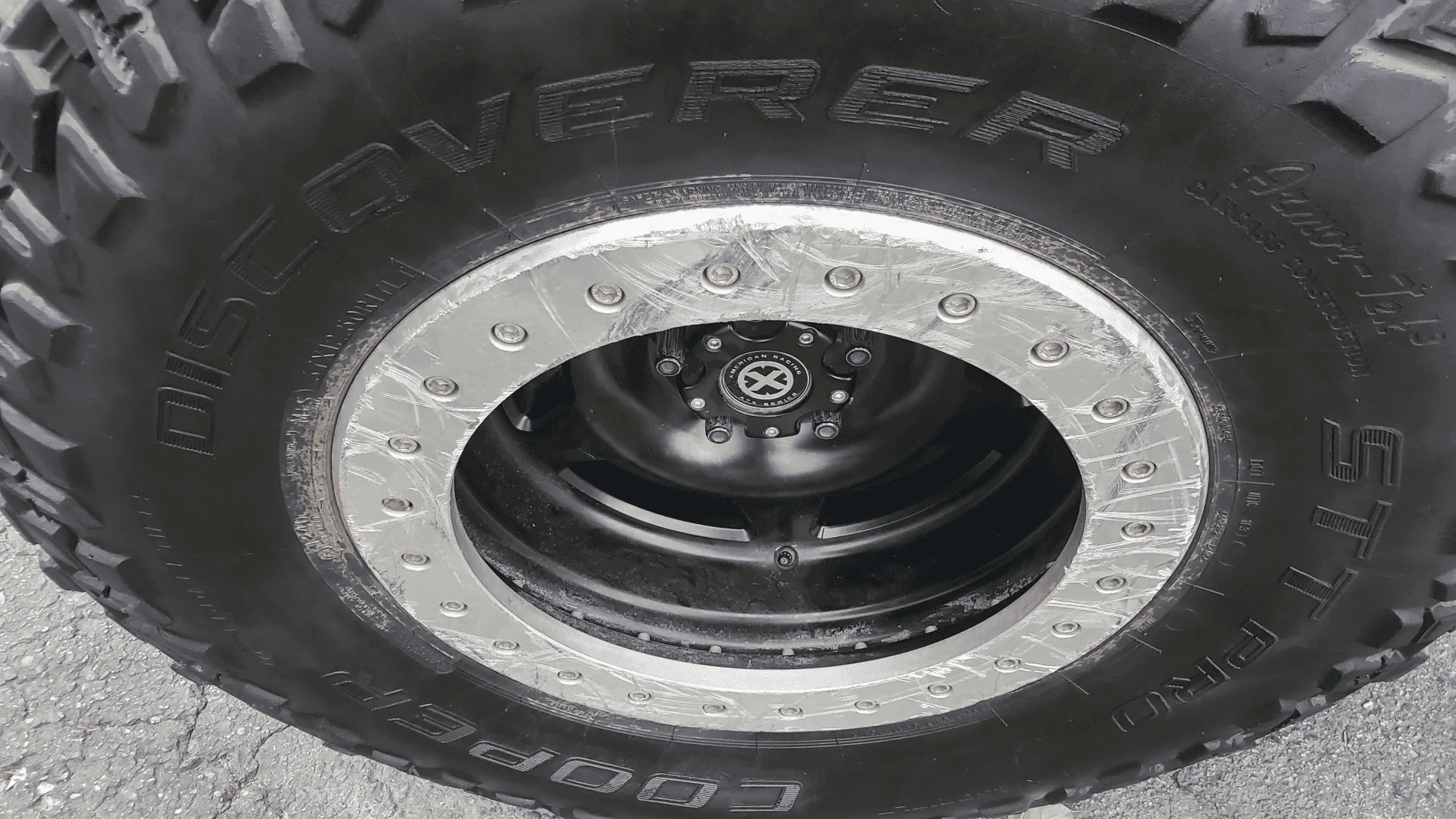

I have 48,000+ miles on bead lock wheels. ATX Slabs, the only thing I get is every once in a while, I need to re torque the bolts on the rings. I can tell when it needs to be done as I will start to lose air from a tire. it will be a gradual thing. Like 2 or 3 psi over a week or so. This has happened twice. So it is no real big deal considering the amount of abuse the wheels have taken. My rings are all scared up. I think that if I had been running normal wheels, they would be junk by now.
All 5 of my rings look similar to this.
Jeep Wrangler JL Beadlocks 1616582771482
As far as bead lock wheels go, I run ATX Slabs. They are a tough wheel.
My bud Gary runs KMC bead lock Machete and they have been a great wheel.
Bill Jeanie and Phil run Dirty Life bead locks. Phil has had one bolt in his beadlock ring break off. This had to be drilled and removed with an extractor tool.
Geoff had DV8 bead lock wheels. JUNK they are. The bolts kept breaking in the ring. Like 5 in a row on one wheel. Each wheel has had multiples bolts break in the ring. I lack the understanding on how this happens. Geoff put new grade 8 bolts in each wheel each time he had a broken bolt in a wheel and the bolts kept breaking.
Geoff switched to KMC wheels and no has zero issues.
