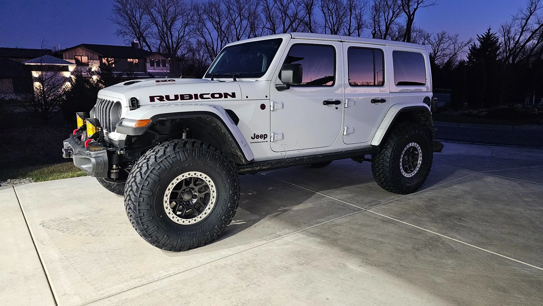

Haven't got to wheel them yet but they are now bolted up on a set of 38" trail grapplers
*1.5in Teraflex spring spacers (~3in total lift with stock 1.5in 392 XR springs and 1.5in spacers)
*Bilstein 8100's, Bilstein 5100 damper
*0.5in front bump stop spacer added (Teraflex 0.5in bump spacer)
*1.5in rear bump stop spacer added (removed OEM XR 1in bump pad, added Mopar 2in lift 2in bump pad plus 0.5in Teraflex bump spacer)
*Mopar 2in lift front lower control arms
*Mopar 2in lift front sway bar links
*Relocated rear OEM XR sway bar links 1in up on axle mount tab
*38x13.50 Trail Grapplers
*OMF beadlock rings making the OEM XR wheels now 17x8.75
