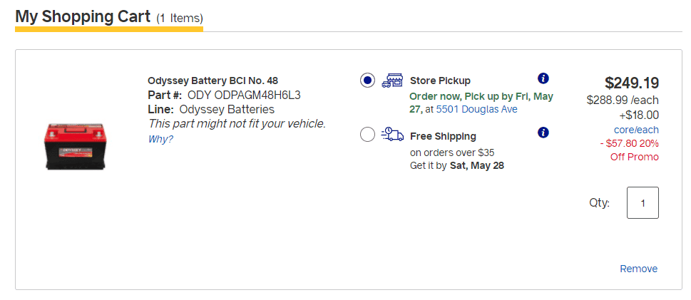

Sorry for digging up an older thread, but found this while searching for some knowledge on which batteries to buy. For quick reference, mine is a 2018 JLR, Manual, 3.6L, 3.5 years old, just crossed 30K miles. Still on original bats for main and aux. ESS hasn't kicked on in months, and couple weeks ago started getting the "Aux Switches not available" message, so I figure it's time to replace the batteries before things continue spiraling from here.
For the Aux, I was going to do the DieHard Platinum AGM mentioned here and several other threads. For the main battery, I found the Batteries Plus battery mentioned in this post and local store stocks them (hell, it even matches my Ocean Blue), but the price has gone up to $330/ea on their website...$100 more than a DieHard Platinum AGM at the local Advance. Other than the warranty, is anything about it worth $100 more than the DieHard?
Lastly, the thread references "Group 48" as the battery size, but I note that the DieHards on the Advance website list both a "Group H6" (760CCA) and "Group H7" (850CCA) as being an "Exact Fit" at the same price.
The Die Hard Platinum AGM is probably a very good battery. But it is not a high performance AGM like the X2, which is made by Northstar/Odyssey. I think the X2 is worth the money. Go sign up for Rakuten, which is a web discount site. They hae 3% cash back now with Batteriesplus.com and if you time it right you can get 10 to 15 % off from Batteries Plus for purchasing online. That'll take a nice bite out of the price. The warranty on the X2 is outstanding, too. Better than Northstar/Odyssey's warranty on the same exact battery.
Winching and high load situations is where that X2 really pays off. Plus, they last a long, long time.
But again, I think the Duracell is very good. And it, along with the Northstar, Odyssey, and X2, are made in the USA. The Duracell is made by a privately owned company in Pennsylvania. Owned by an American family.
