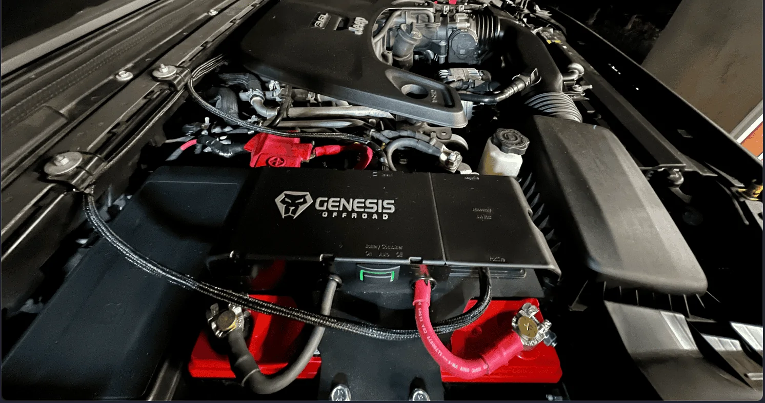

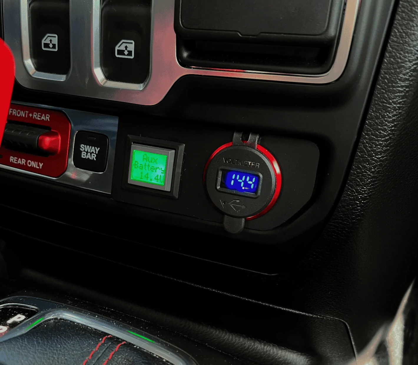

Dual batteries as @Maverick909 mentioned has been the way to go for me.
Not once have I regret buying the Genesis system and probably one of my favorite upgrade I have done to the Jeep.
Jeep Wrangler JL Battery not keeping up with fridge - while running. Screenshot 2023-05-03 at 11.57.48 AM
I added their volt meter on the left which displays both the main and aux volt levels. I also added more charge ports which also had a volt meter integrated with it so now I leave the one on the left displayed with the AUX battery voltage and the right is the main battery voltage

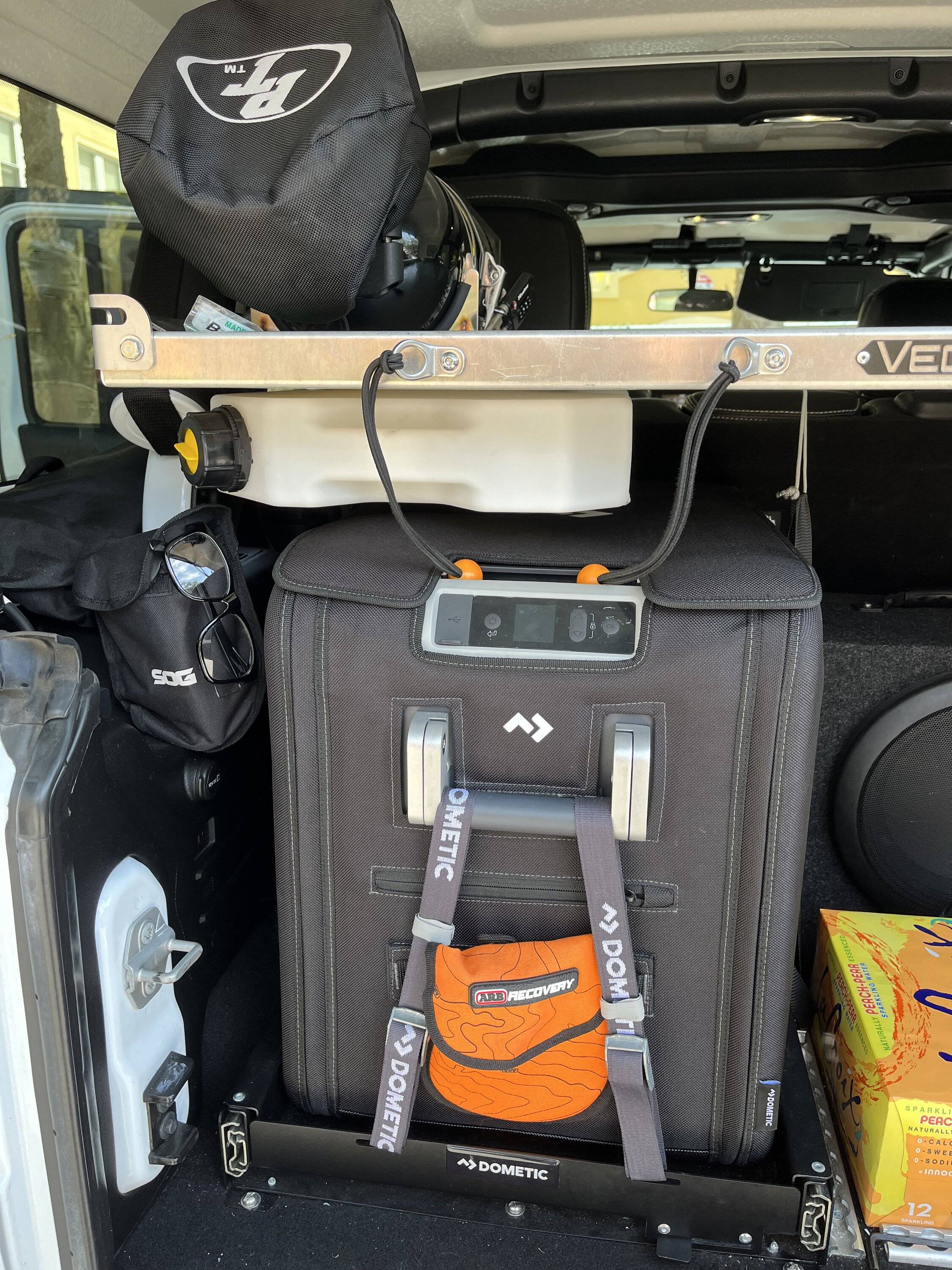

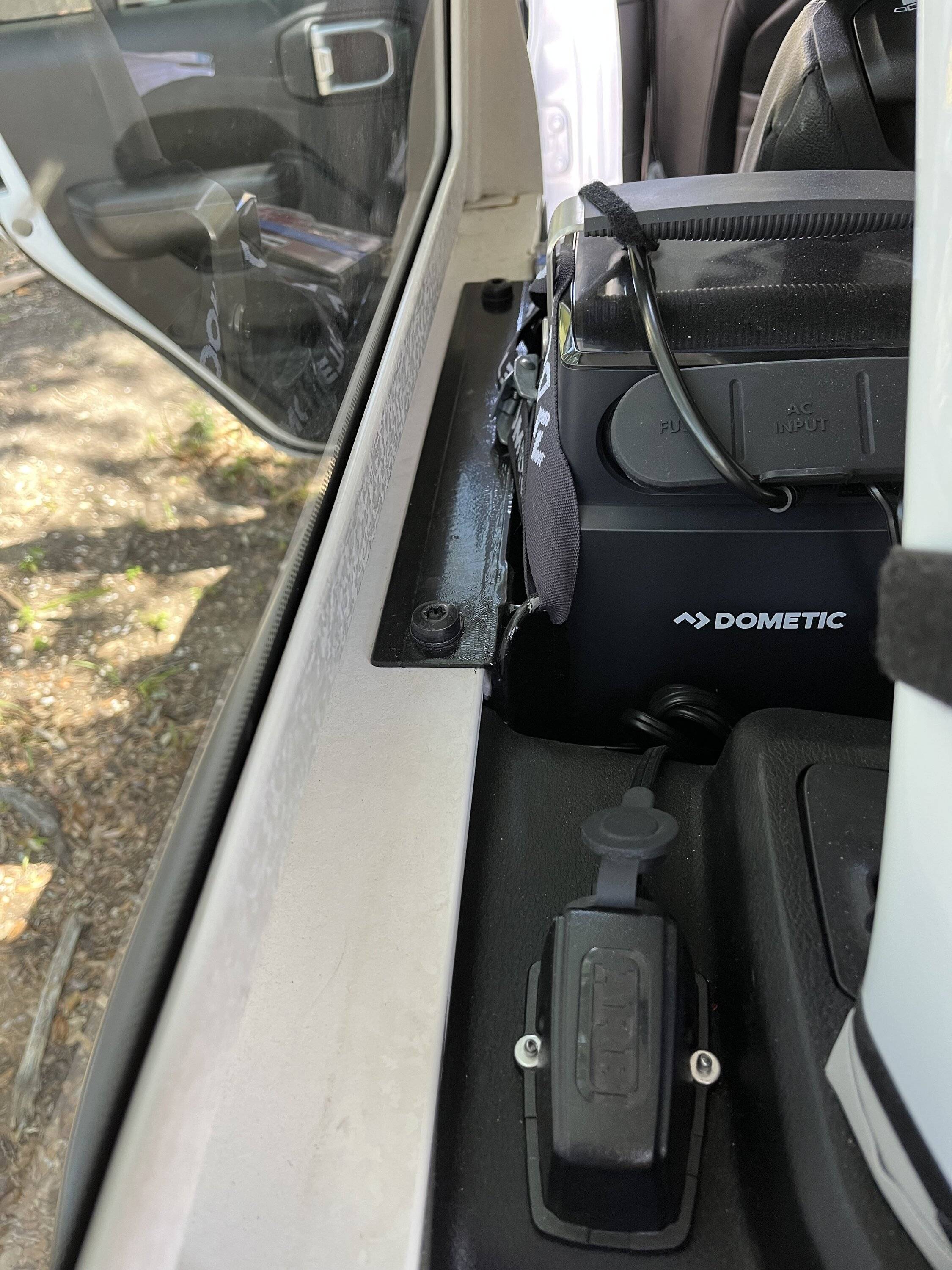

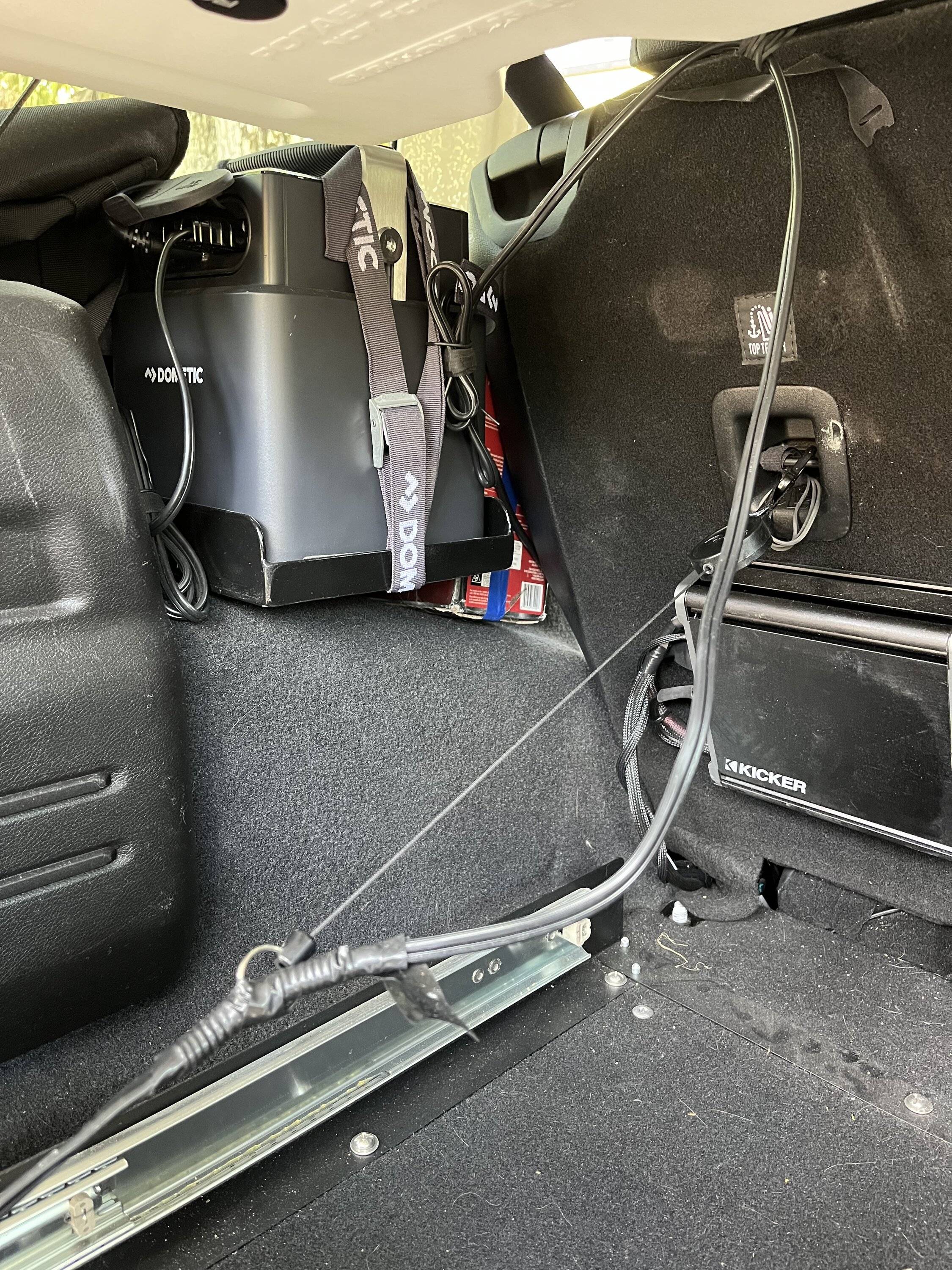

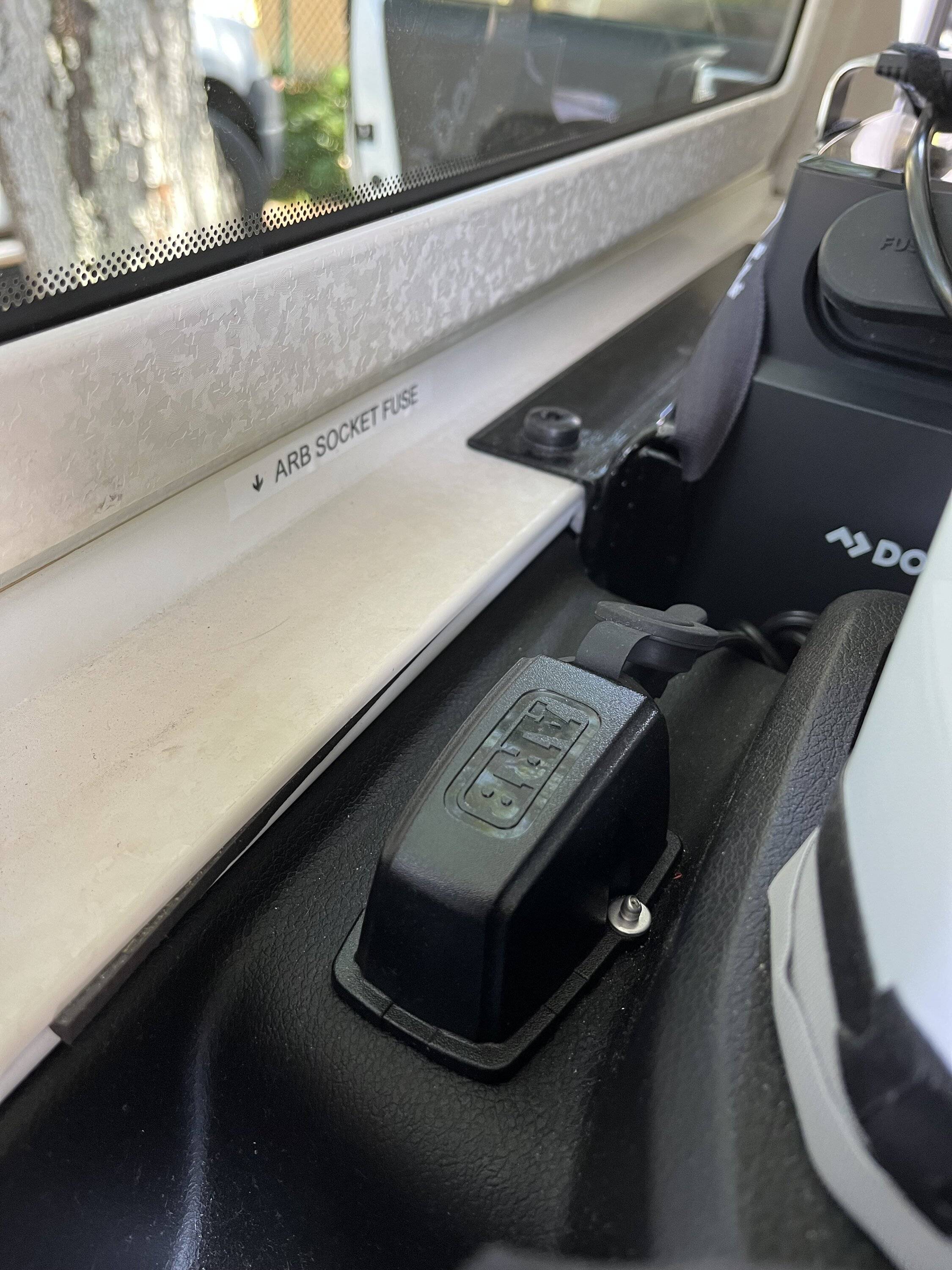

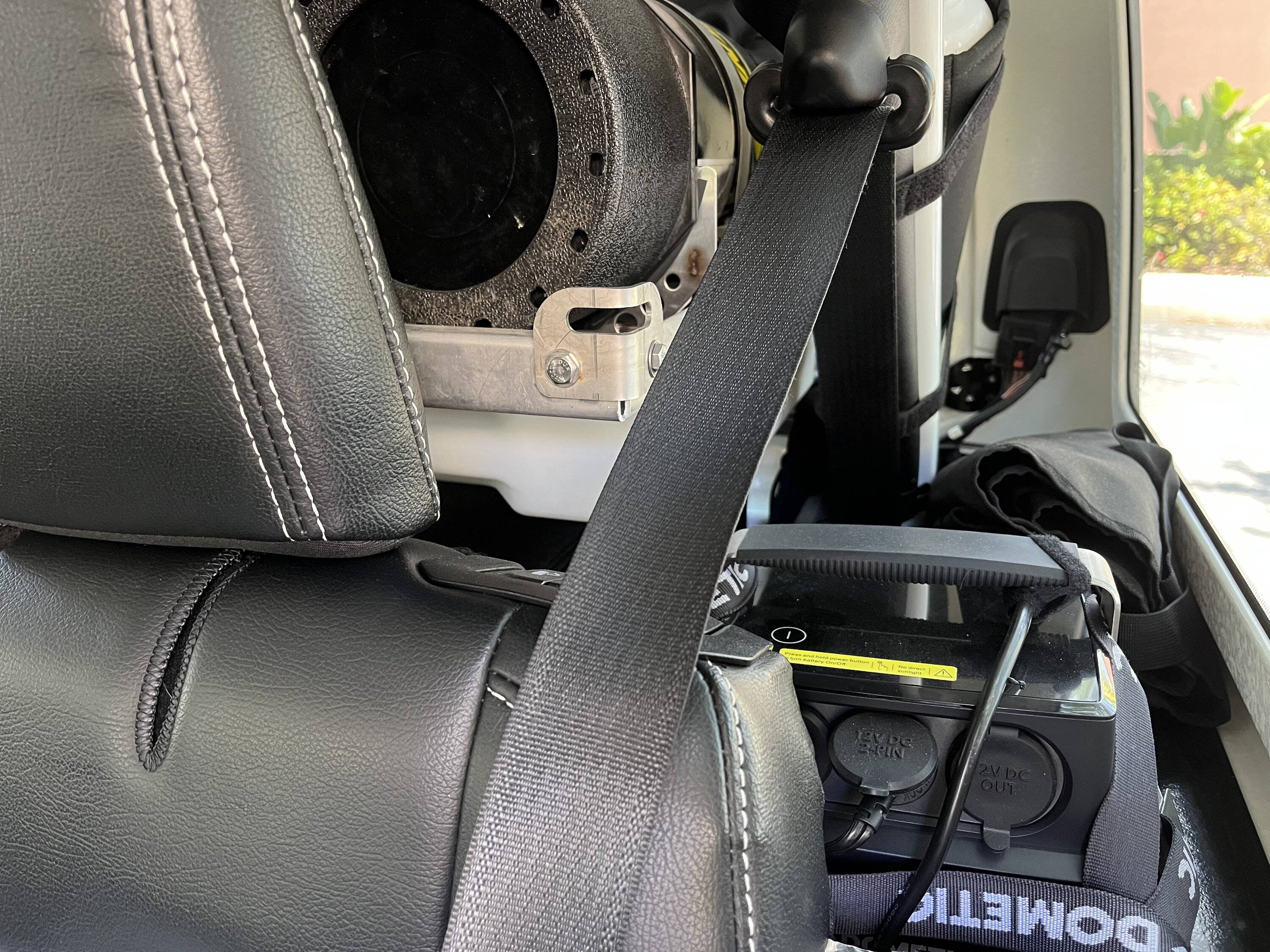

I’ve had this fridge running for 3 years straight. I drive a lot… If I’m not going to be using the Jeep for more than a few days I plug in the battery to an extension cord and just slam it in the door.
I welded up a basic battery cradle with some scrap angle iron. It comes off with the top so it can be used with or with roof. ARB plug is connected to jeeps 12v w a quadratech splitter. 12v outlet is switched w key(inside fuse box optional)
Retracting cable keychain keeps wires outa slides.
best mod I have done, always cold drinks and snack.
Honestly I haven’t thought this much about it in years, it’s just always there and on.
( Jeeps been in SoCal and Florida all of that so outside temp doesn’t matter)
