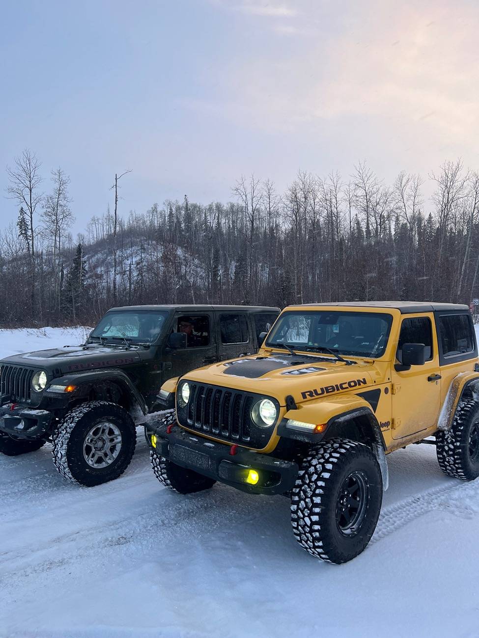

I did a great budget lift with my Jeep. I sourced the Mopar lift kit springs for my specific model and then paired those with Bilstein 5100 shocks, and since you already have track bars, you are already ahead of the game. It works great for me and very cost-effective. At first it was about 3.25” of lift and it has no settled to about 2.5-2.75”. If you’re interested, you can DM me and I will help you with the part numbers for the springs
