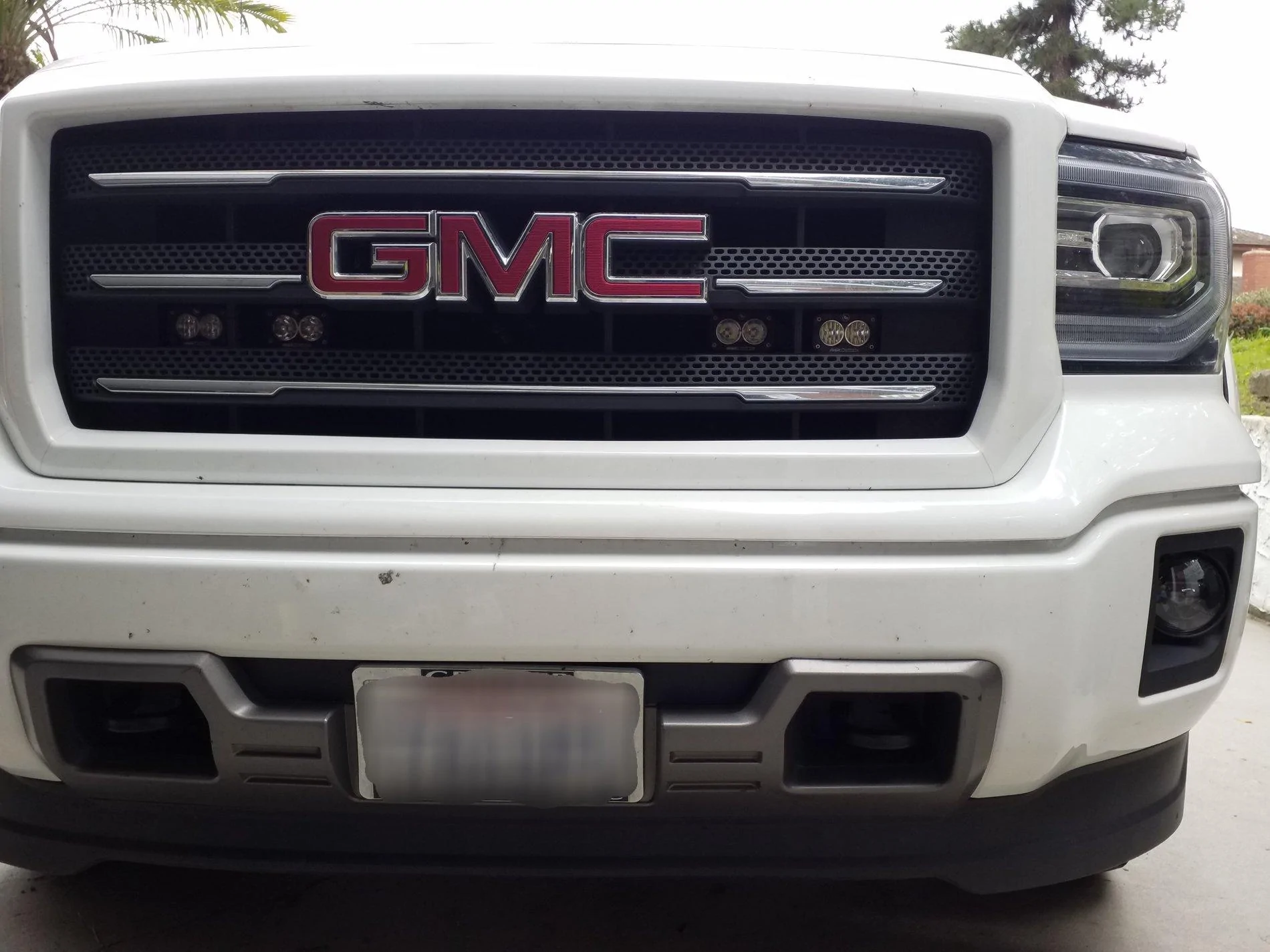

Is anyone using the squadron sport as their everyday driving fog lights?
I know someone mentioned that pro are too bright for everyday driving.
About 4 years ago, I installed 4 of the S2 Pros, 2 spot beams and 2 wide cornering beams, on my truck. Basically the same as 2 Squadron lights with the mix wide/spot configuration, but I had them wired separately for the reason you mentioned. I could turn on just the wide beams, but I found that they had a lot of stray light above the "cutoff". Actually, they don't really have a true cutoff. The beam is just a flattened oval shape. They really aren't designed to be driven on-road with oncoming traffic. If you want a streetable fog light, look into either the Morimoto fog light replacements for the JL or the SAE compliant Rigid Industries lights. I have had both on my truck. The bracket failed on my GMC recently and I decided to go with a more stock looking installation with the Morimoto GMC setup. Both are "street legal" types of beams. The Rigid has a more controlled beam than the Morimoto, but both are good. The Rigid 3x3 cubes are advertised at around 1700 lumens and the Morimotos are touted at 1200 ish lumens. If you're just driving around with your fogs on to "profile", factory fogs are your best choice. Low output, won't bother anyone, you already own them.

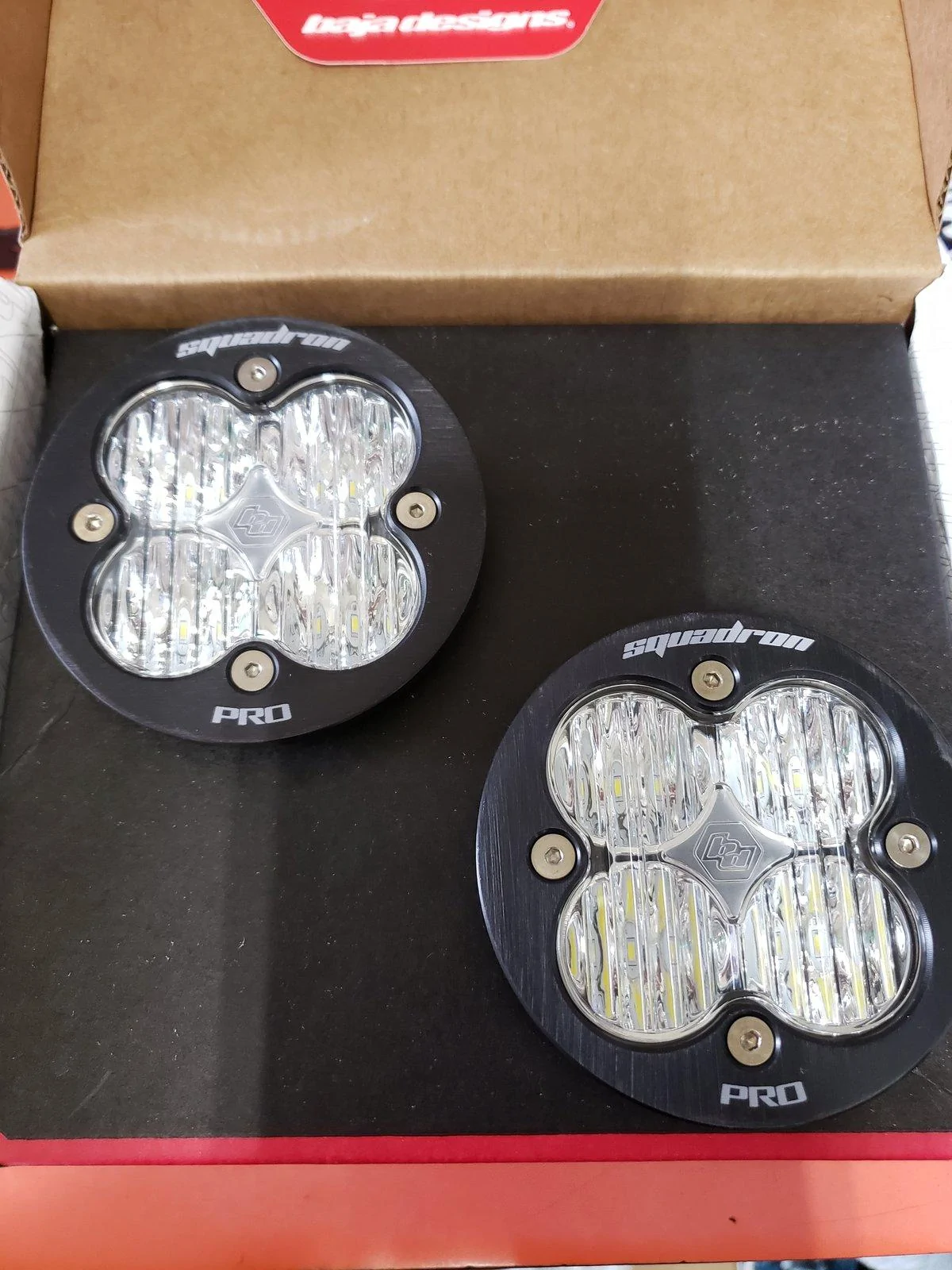

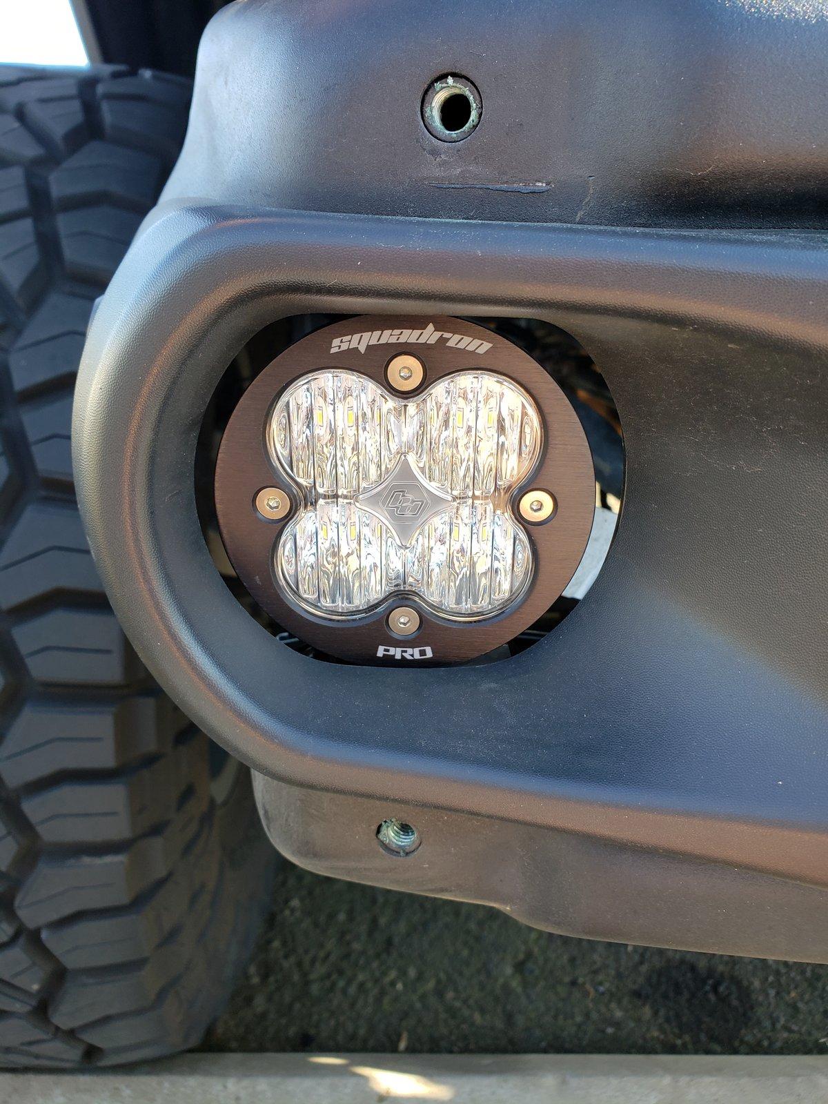

They now list a SAE compliant (street legal) Squadron Fog, with 2480 lumen output each. It basically is a Squadron Sport with a new fresnel lense to control scatter.
I just ordered the Squadron Pro kit 447071 combo beam for my JL Rubicon, which now has a Rock Hard aluminum bumper that has the 4 hole Sahara style fog light mounts.
I have 2 new Rigid SAE cubes that I may put on the light/brush bar and point them out at an angle or cowl mount them for low speed manuevering .

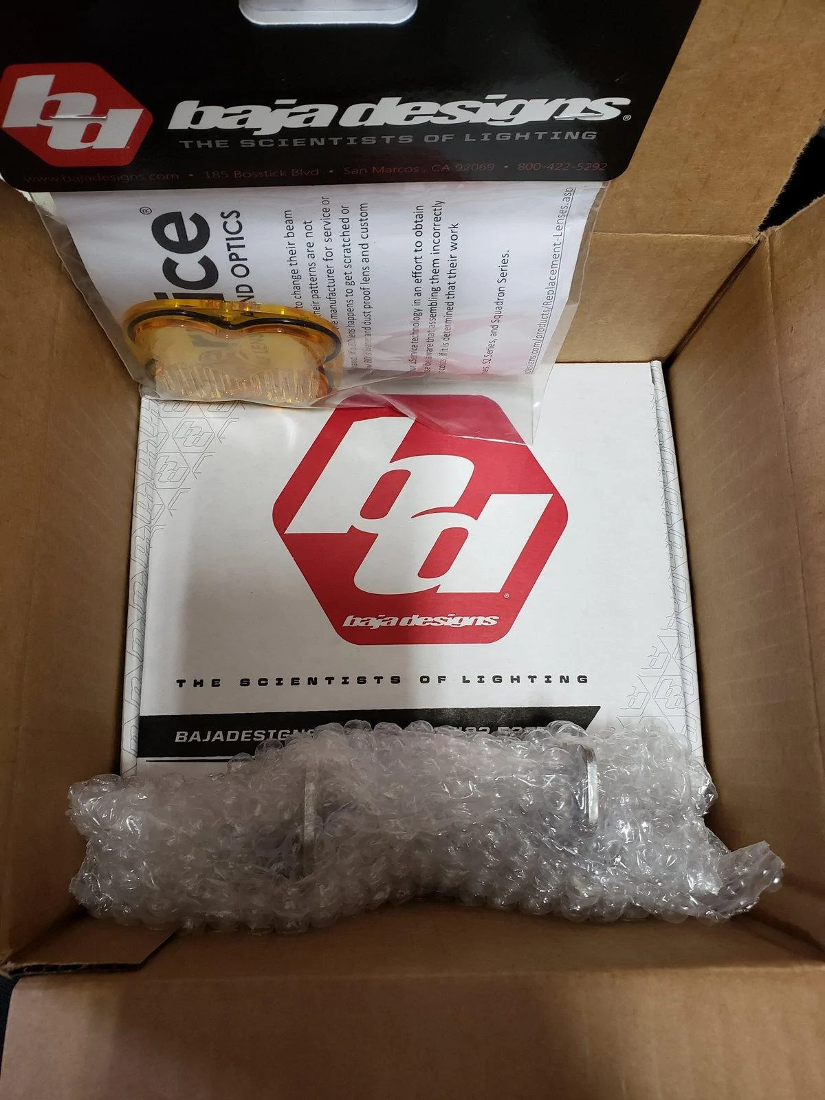

Unfortunately, 1) I didn't mention I was a forum member and paid full retail, and: 2) they sent me wide cornering lenses instead of what I asked for, which was the combo beam pattern. I guess they're going back.
