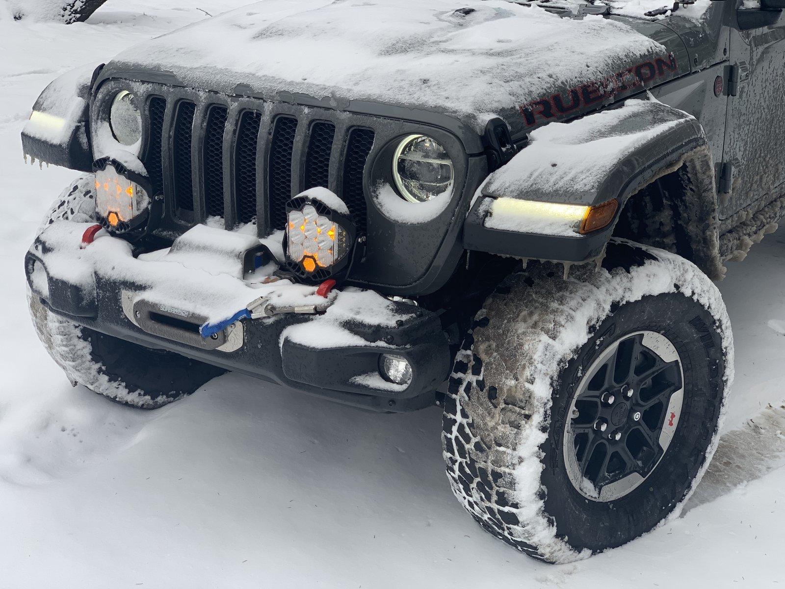

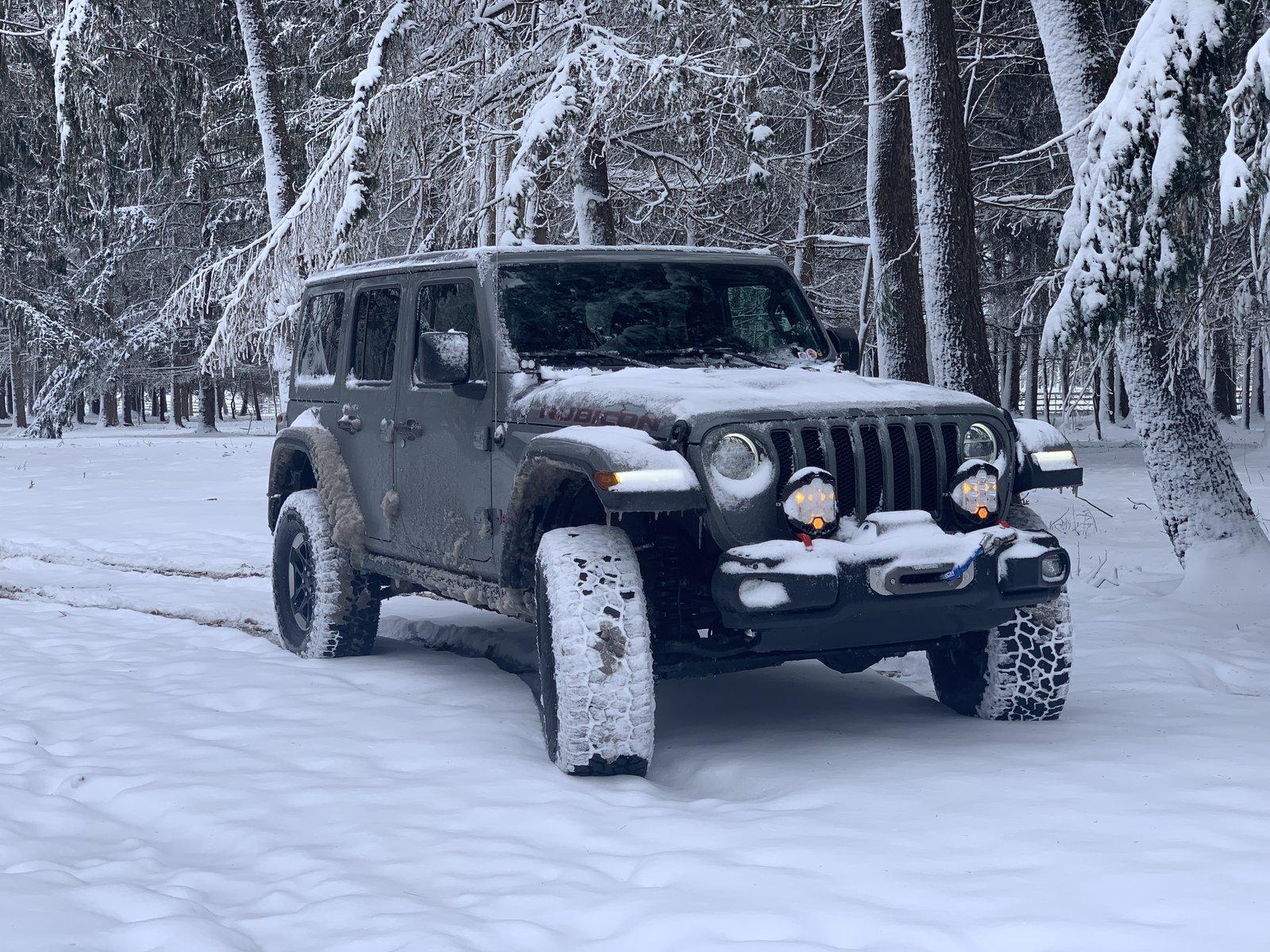

Jeep Wrangler JL Baja Designs LP9 install? ead5f0fd-24d2-4aff-93bc-0d1e22d12595-jpe
I seem to always respond to BD posts, but I love my lp9 pros. IMO they do not block the headlights at all.
Also, I didn't use the BD wiring harness, and it was super cheap to build, $20-30. I have it set up with a relay wired to Aux1 and the regular vehicle high beams. Aux1 turns the lp9 low beam on and turning on the high beams via the steering wheel stalk it turns on the high beams for lp9s when Aux1 is already pushed. It does mean you need the lights on to get the high beams for the lp9s to work, but I only used one aux switch. The relays are on the passenger fender so the wire runs are pretty short. I tapped into the oem high beams via the headlight wiring harness.
