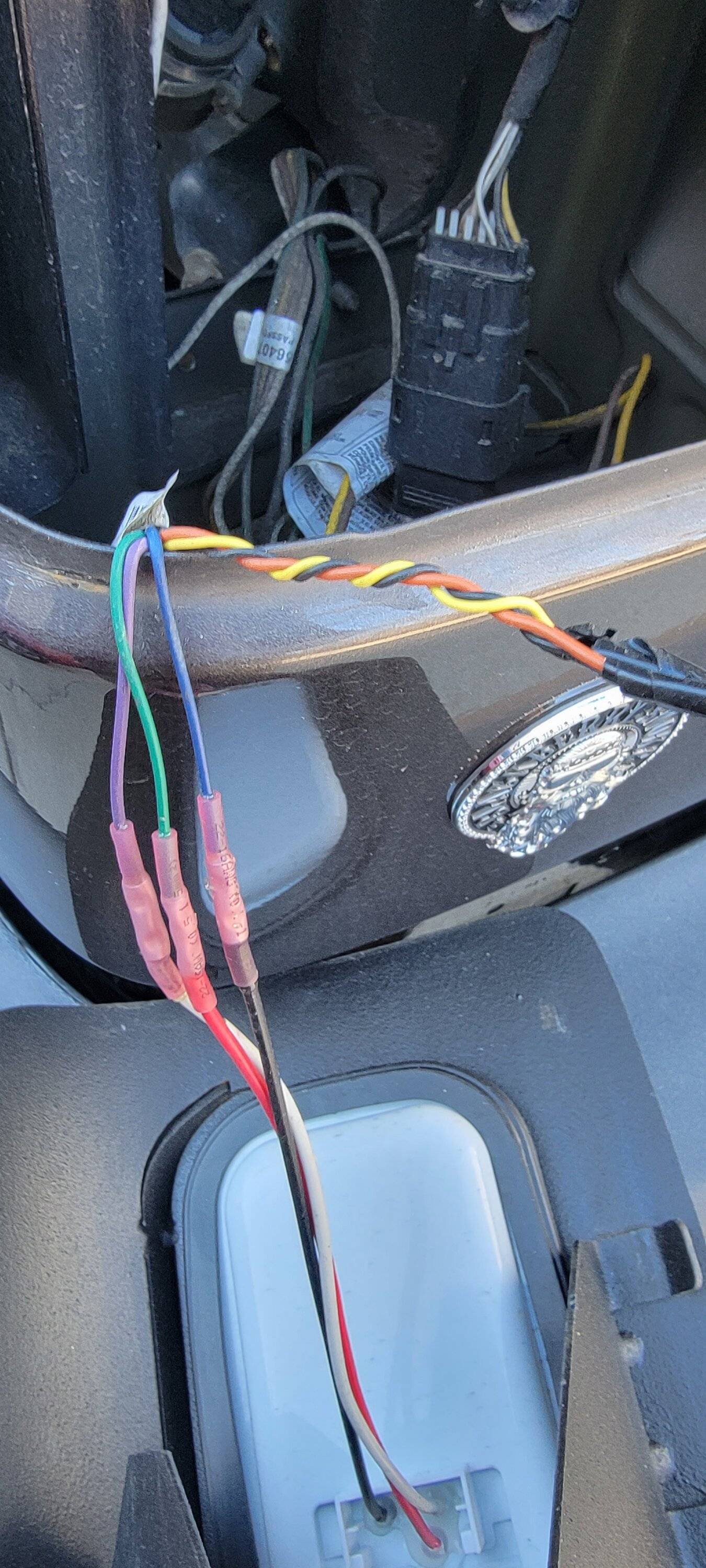

I have the Next Venture taillights. They have been wired up for a while. Going to add some small leds in the bumper for reverse lights. What color wire is for the reverse lights? I have yellow,orange and black on the driver and passenger sides.

This is the old Next Venture lights just had a plain LED to wire into the factory light plug. I think the new ones actually come plug and play with a reverse light.

the wire should be orange, at least it is on my 23 JLUR.. but depending on the size of lights you plan to run in the rear proper way to do this is to wire in a relay harness then your trigger from the harness you tap into the reverse wire light..
