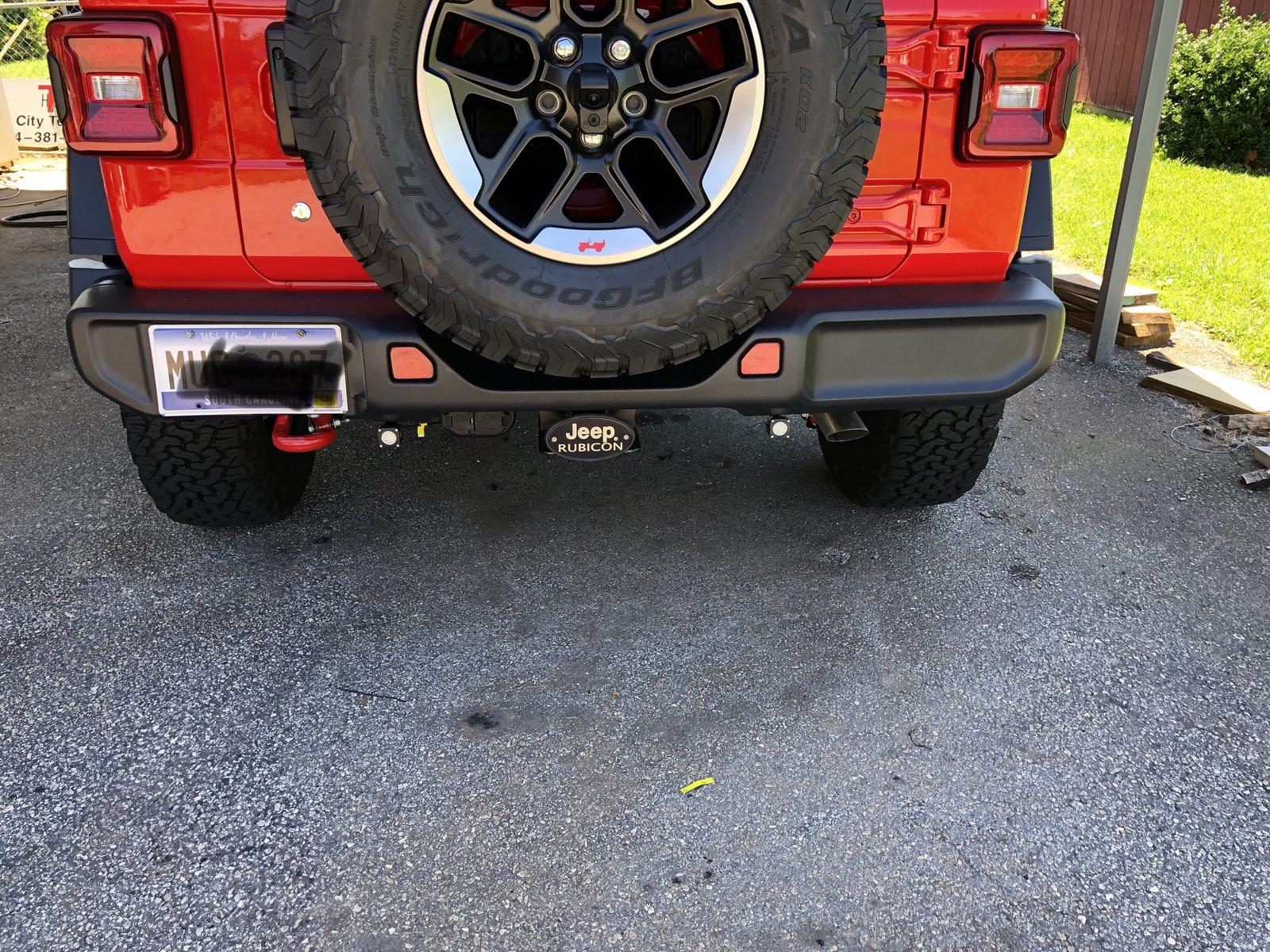

I am going to put some auxiliary led backup lights on my JL. I would like to power them from the backup light circuit in the 7 way factory trailer plug. Anyone have a wiring diagram or wire colors for the factory plug?

Traced it down. It is a white wire with a orange trace. Makes is easy to connect secondary backup lights.

Can you give info and link in regard to the two little circular LED backup lights shown in your pic. I assume those are the two that you will receive power from the white wire with a brown trace?
Thanks in advance for the info..

Rigid Ignite Surface mount LED backup lights.
