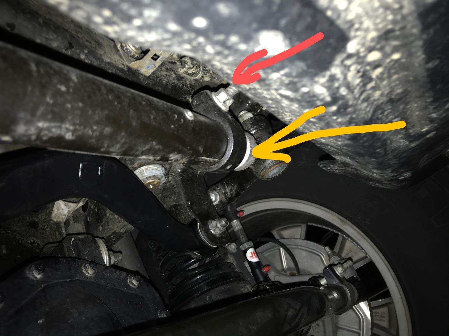

What should’ve been an easy bolt off bolt on has royally ruined my afternoon/evening.
Bought the Teraflex adjustable trackbar, took off the OEM one, measured and adjusted Teraflex to factory suggested length
Went to bolt on, as expected the frame (drivers side) was a bit far away for the bolt to go through.
Worked solo, so I couldn’t have someone turn the wheel. Instead used a ratchet strap from the drivers side frame to the axle. Put the bolt in and tightened everything down.
I just went for a test drive and everything is wonky:
-Traction control light is flashing
-To drive straight wheel has to be turned 2* to the left
-Driver’s side wheel is approximately 16” from frame and passenger front is approximately 15”
No clue what I did right or wrong, any advice welcome!
