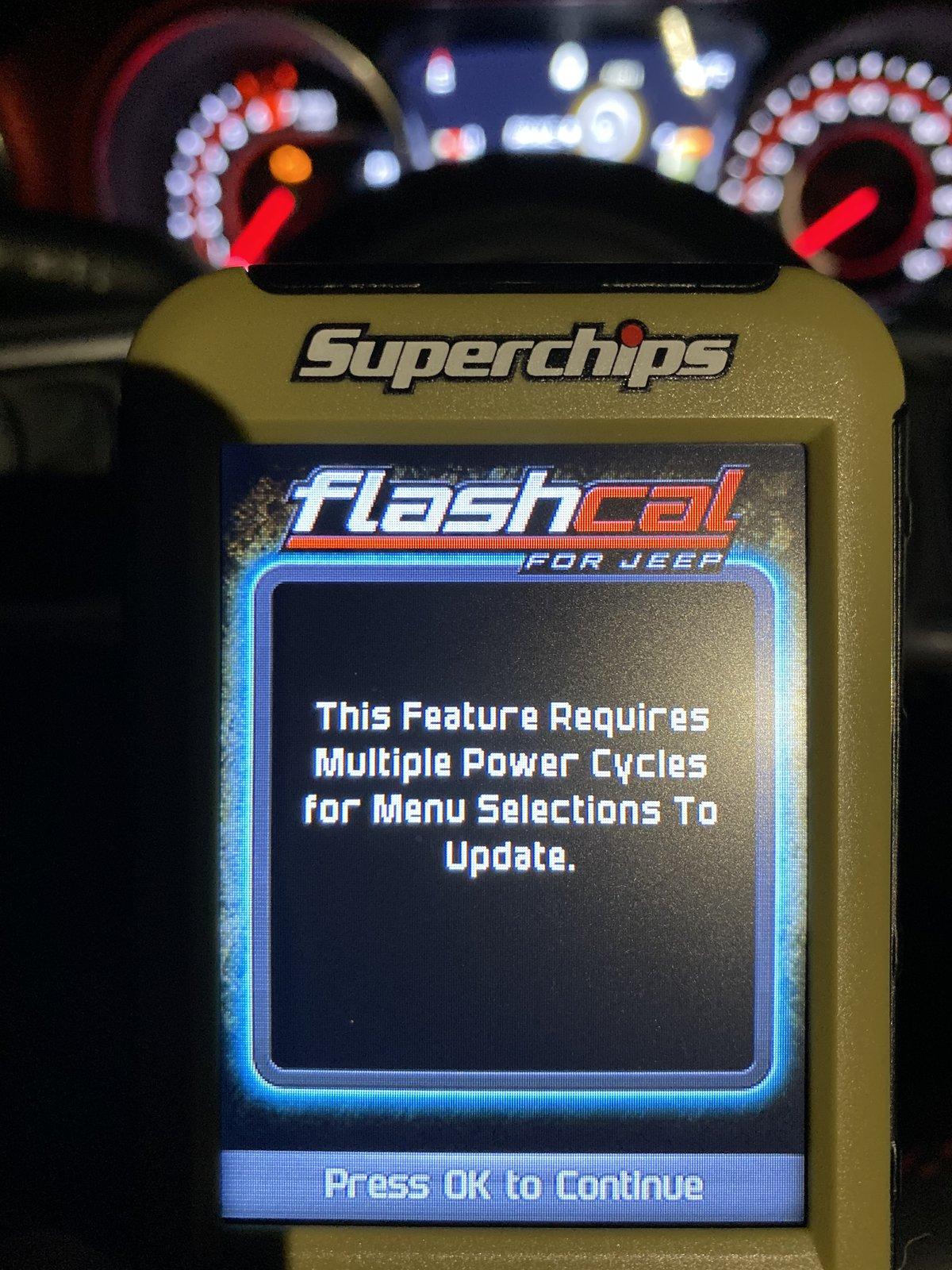

So I get this far and then nothing shows up on the Uconnect screen. Am I missing something?
did you go to settings in Uconnect?

Can you give us a summary of your install. My issue was due a connection not seating properly.
I’m thinking the plug behind the switches themselves may need to be looked at. Also I’m look at the fuse issue too.
did yours only show up in uconnect when the harness was done correctly?
no, they showed up even when actual switches weren’t plugged correctly.

well It showed up this morning in uconnect. But now need to see why the switches don’t have power.
Do they light up at all wether pressed or not? If they don't light up at all check the actual connection on the switch panel. For some reason I hadn't pushed mine all the way in.
I am going to check that today as they do not light up.
