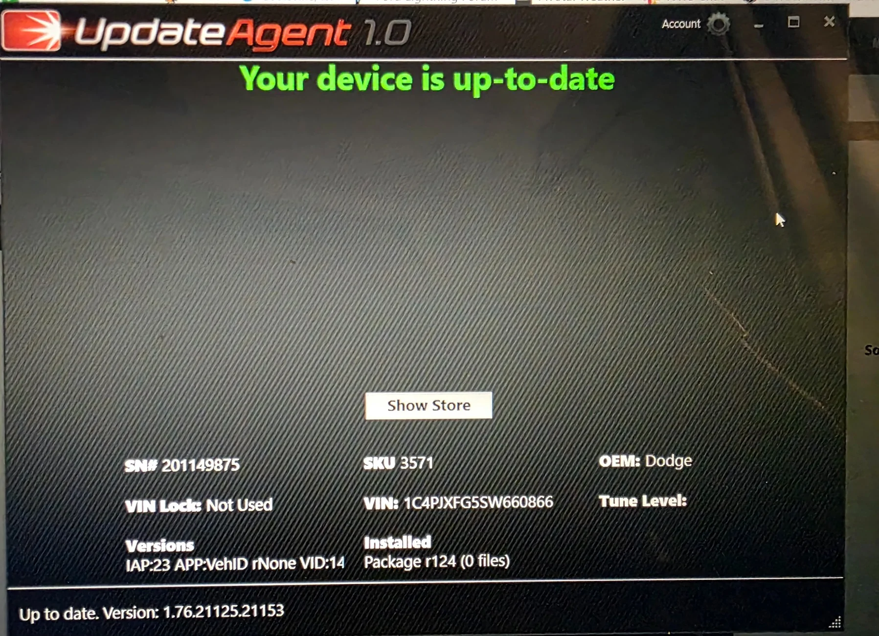

So this is the same problem I always have. It says the device is up to date but it isn't. If you look at the bottom of the screen it says 0 files were updated. And when I go out and connect it to my Jeep I get the same error message.

Looks like the Flashcal is locked to an old firmware version. I reset it to live, please update again, and it will deliver the latest firmware, and allow you to use it on the 25.
