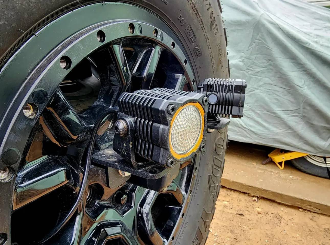

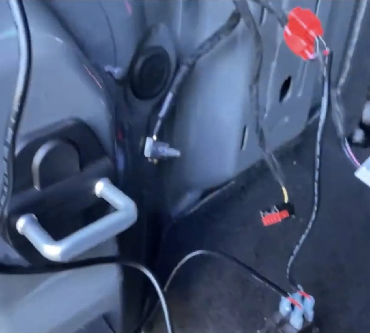

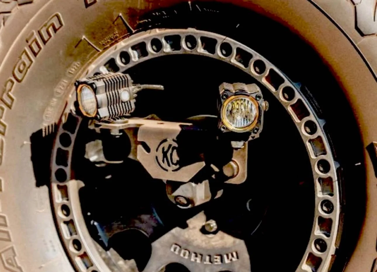

I just got the new KC Flex Era 1 license plate bracket that just came out <1 month now and will be installing this week - maybe tomorrow but definitely by this weekend (DM or respond if you want to see how nicely it turns out or how bright the lights are). I have been “sitting” on the FE1s for awhile considering running them to the A-pillars as secondary “alley lights” or making a license plate bracket via CNC until I got the email from my sponsor at KC saying they ran with my concept since they were also making them for Bronco as well. While my idea was to mount them to an adapter plate to add to any license plate relocation, they opted to design one that uses 90mm extension lugs for those with or without the license plate relocation. (The first pic was my design, from the side on a set of old wheels, the second pic with the beadlocks a d “KC” logo, is their finished product.)

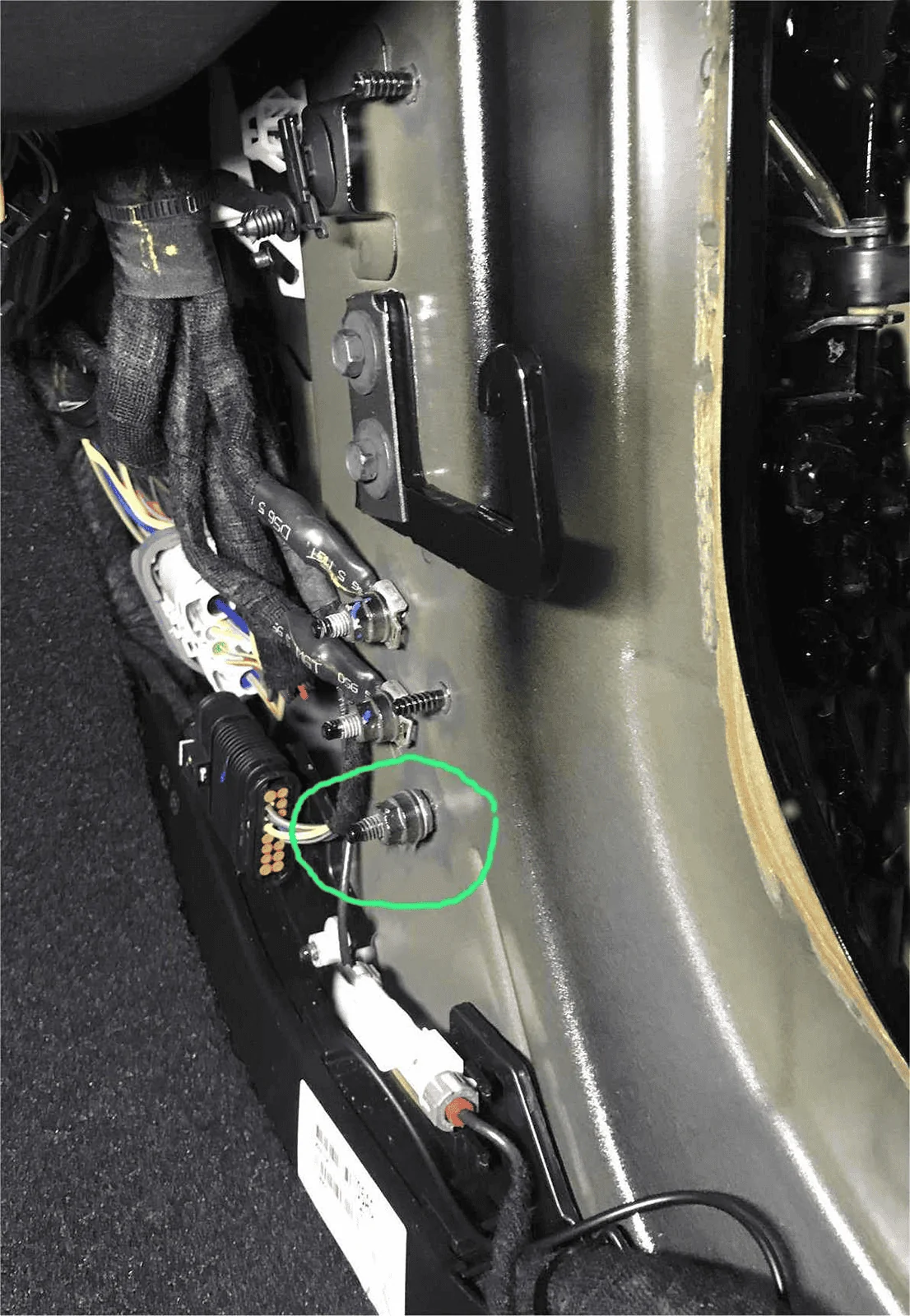

so here’s the reason for the post… for those who have ran to the internal wiring for the aux switches (I know where the wiring is located), does any one have a suggestion for a good grounding location that is relatively close to the wires? I will be running them to Aux 4… that way I will not only be able to have flood lighting for the rear, use as added reverse lighting but not constant but more importantly (and for “fun”), to “deter tailgaters” from riding my ass.
There should be 3 grounding studs near where the front door harness connects in the footwell area. They may be hidden under the plastic panel, I haven’t looked in a while.

Yes three grounding studs under the passenger side kick panel one of which is unused. Also a similar grounding stud under the drivers side trim panel in the rear cargo area. There may be one in the rear cargo area under the passenger side trim panel, then you could route your wires along the existing wiring, through the tailgate and out to the passenger side trim.

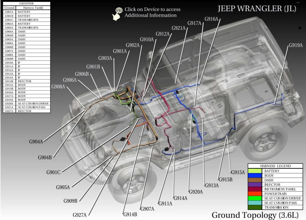

Sounds like you’ve done something similar @Terrymo lol. It’s been awhile but I remember coming across this thanks to @[Banned Site]. ONLY problem is that the G-Codes don’t show specific locations only generalized.
