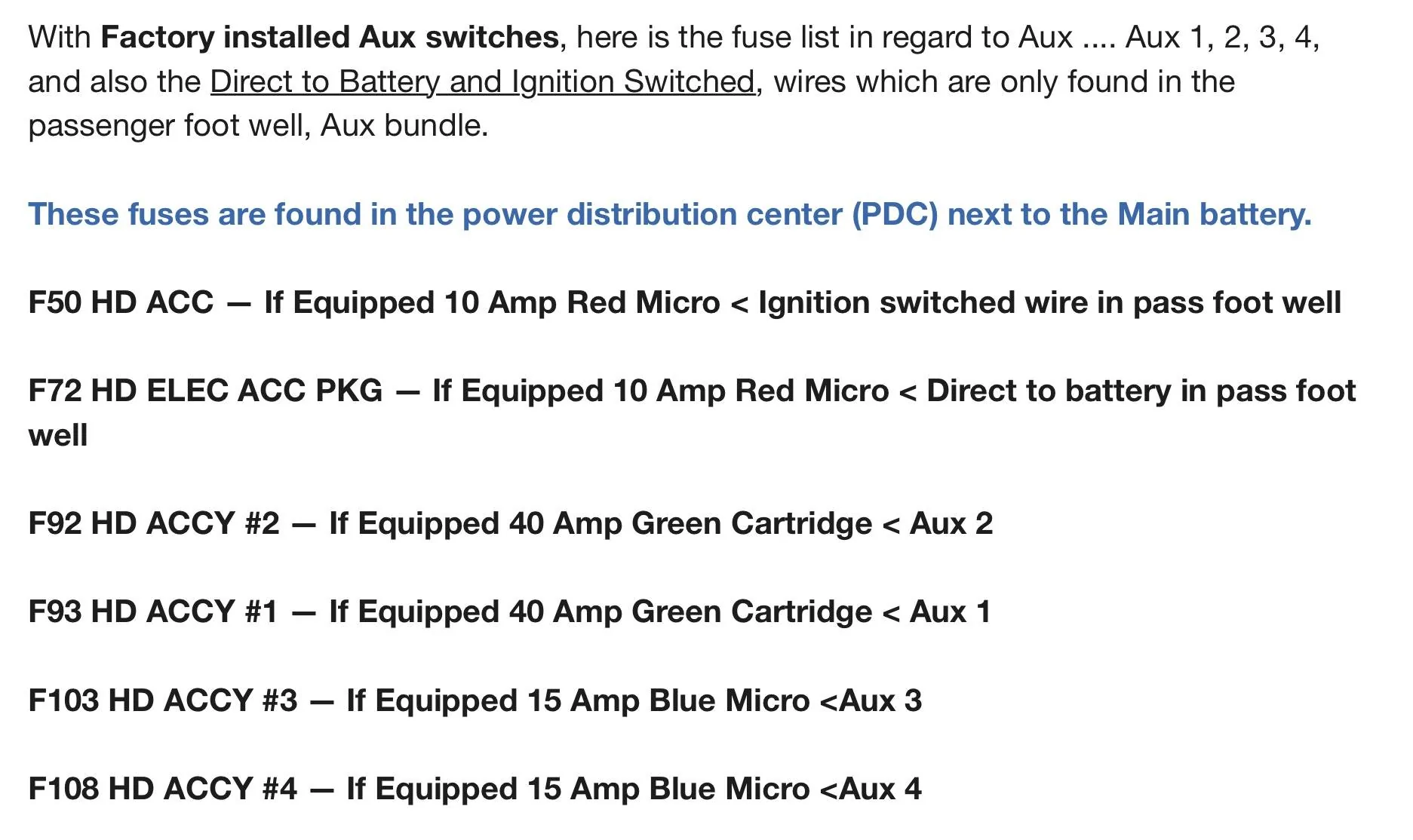

OK, i've searched my Owners Manual and here and failed to find the answer.
where are the fuses for the Aux Switches located? (this is as supplied from the factory, not the add-on kit.) it's always good to have spares,..
'21 EcoDiesel, if it makes any difference.

From @Rhinebeck01 wherever you are
Jeep Wrangler JL Aux Switch Fuse locations? IMG_1942
