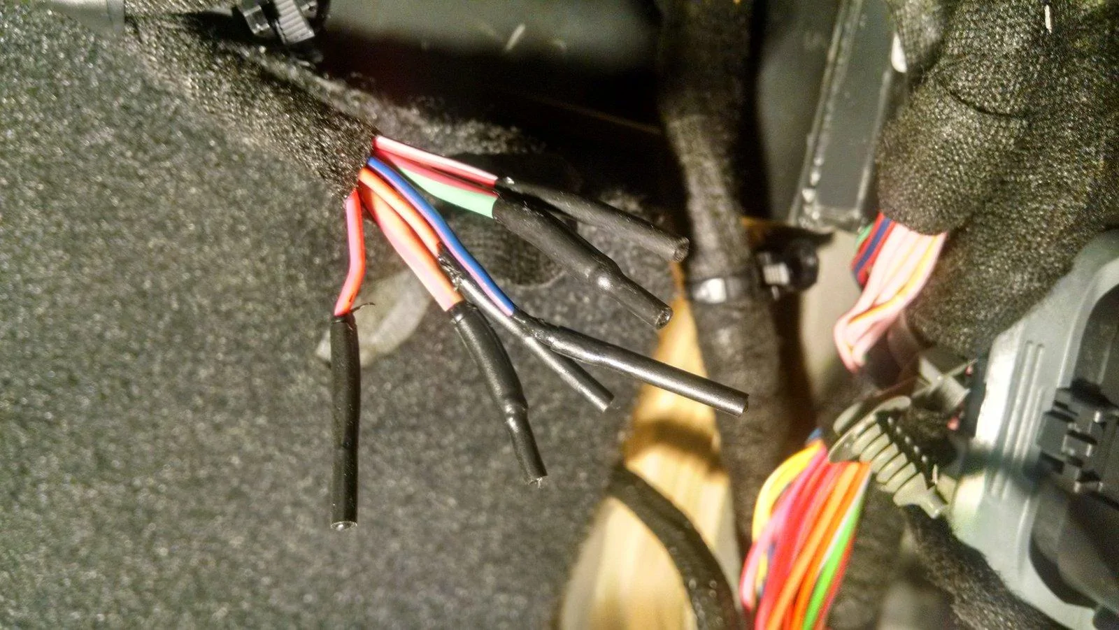

Which wires do what? I have 2 larger wires. Green with a pink stripe and Orange, then there are 4 smaller wires. Blue with a pink stripe, red, orange and orange with a white stripe. Which wire goes to what switch?
Jeep Wrangler JL AUX switch wire code? IMG_20181112_114915071_HDR[1]

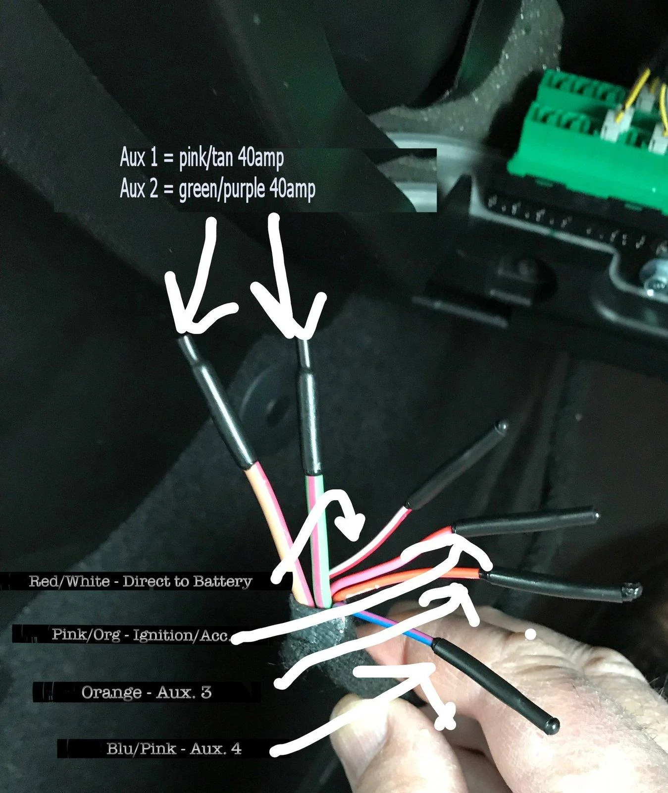

FIY, All I need is for a wire to go hot, and stay, when I flip one of the switches.

Great! Thanks!
Not my picture, but one I saved from here. I haven’t hooked anything up yet, but figured it would help so I saved it.
