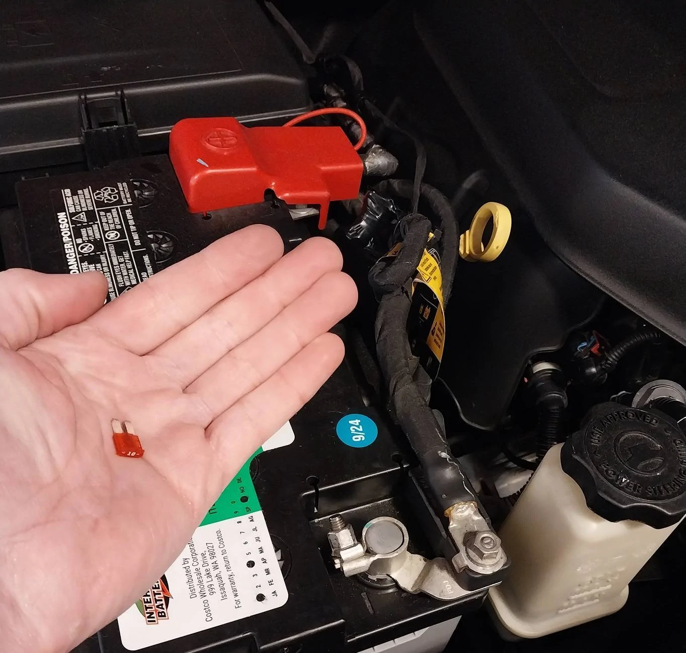

The traditional definition in this context means to cover the Negative cable end(s) with electrical tape, or wrap them securely in a rag that won't come loose. The idea here is to protect against unintended electrical discharge, should the cable ends accidently make contact with anything while the batter(ies) are being replaced.
To electrically isolate the ESS battery, while leaving it in situ (thus avoiding the trouble of removing or replacing it), you'd perform the following steps:
1. Remove the ESS Negative cable from its connection on the main battery's Negative lug. The ESS cable is the slightly thinner of the two Negative cables.
1a. Fold and secure the ESS Neg cable out of the way with a zip tie, after first wrapping the now exposed connector very well in electrical tape.
2. Remove Fuse F42 from the fuse box, aka PDC.
Isolating the ESS battery in this manner removes it from the vehicle's electrical system, at no expense to the owner but his time.
Here's what mine looks like after doing that very thing. Note the continued presence of the Intelligent Battery Sensor (IBS) under the main battery's Negative cable connection.
Jeep Wrangler JL Aux battery replacement help! ESS battery isolated in my JLU
Thank you! I think I want to try to keep the AUX attached to try to save what I can on gas mileage if I am mainly making shorter trips in the jeep. At least that is my hope with the SS.
