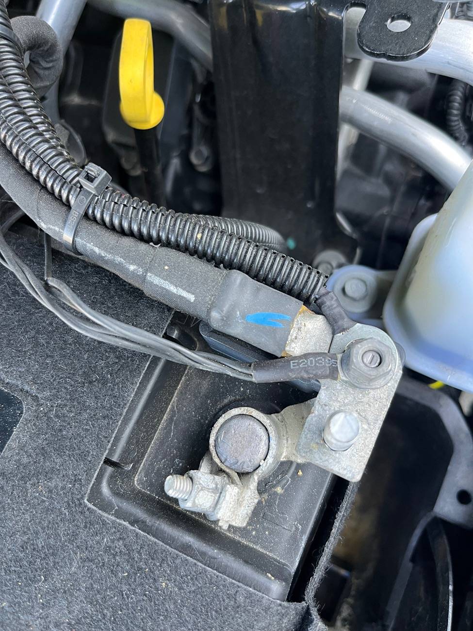

Jeep Wrangler JL Aux battery replacement help! IMG_1606
It looks like I have three different things attached here. One set of wires and two cables. Should I remove the first two (wire and top cable) leaving the mother attached to the negative?
I don't see an AUX (ESS) battery ground cable in that picture.
I don't see an AUX (ESS) ground cable in that picture.
Pic he posted is poor poor in regard to angle... but it appears he / @churlk has etorque... and you know as I do, no Aux battery.

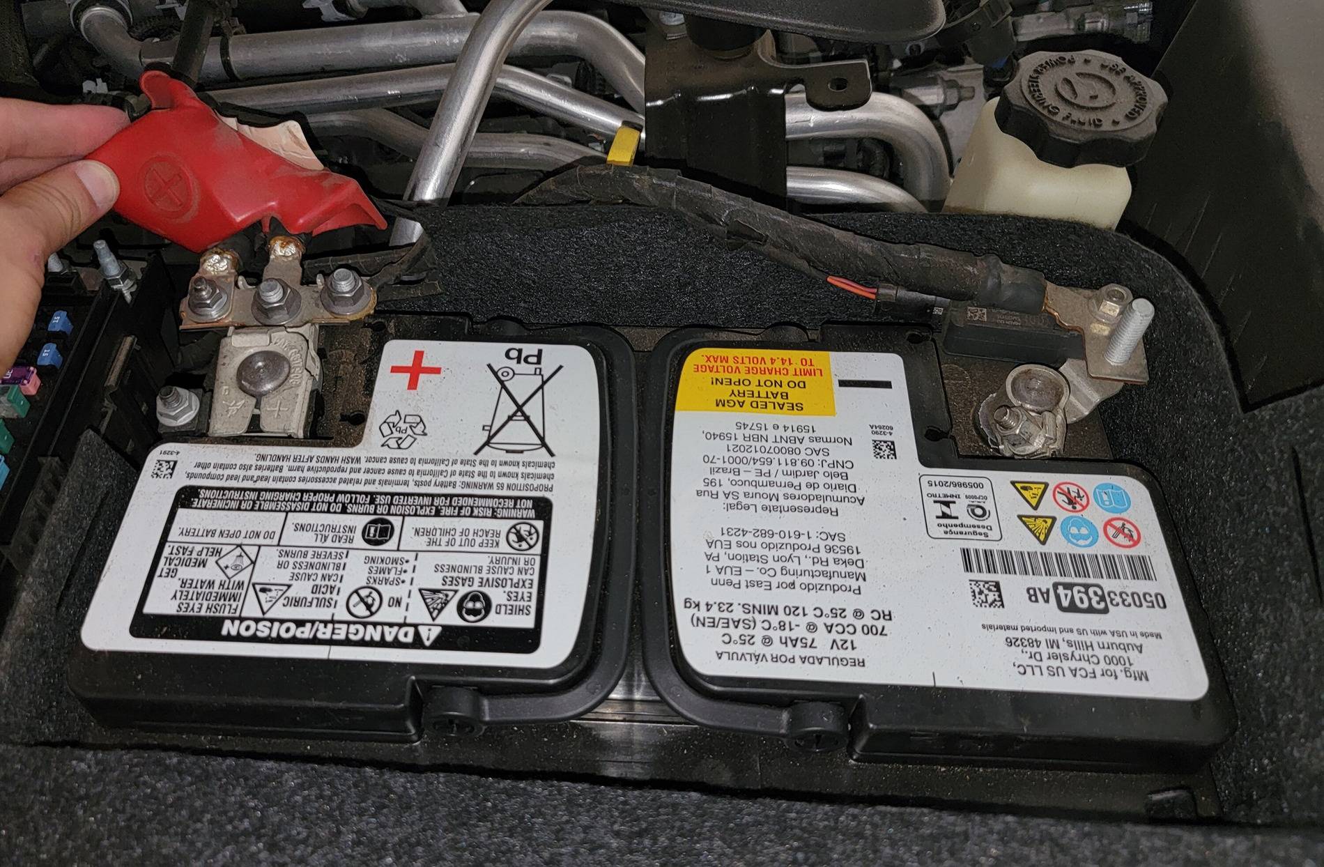

Here is a better pic of an etorque equipped ..
Jeep Wrangler JL Aux battery replacement help! etorque-neg side

The top one on the negative is not the aux? I think the bottom one is from the rockslide powersteps. (I just bought this jeep so I am trying to figure out what this person messed up so I can fix it)
I do have etorque but what do you mean that I have no Aux? 100% I have an aux battery.
Most of the time, the smaller battery in the fender well is referred to as an auxillary, start/stop, or ESS battery. If you don’t have that, the 48 volt battery under the Jeep is commonly referred to as the etorque battery. If you have an etorque battery under the Jeep, you still have an empty auxillary battery box in the fender well.

It
Those outboard wires -- one with loom, one without -- appear to be post facto additions. If you're not the original owner (and we'd guess you're not?), you'll want to confirm their function/purpose before proceeding here.
