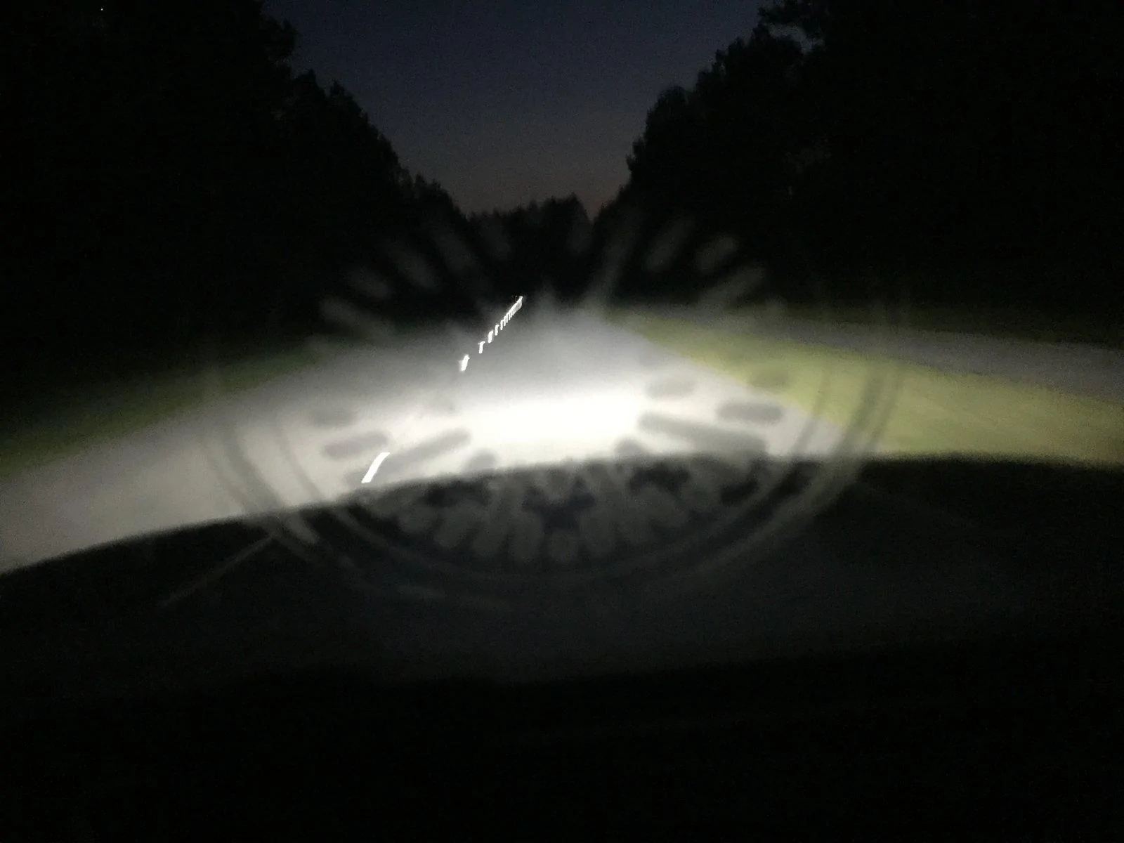

91% IPA then invisible glass and still have these F'ers
would anyone suggest a heat gun? Im thinking its a rubber/silicone snail trail so maybe a lil heat will do it?

Have you tried IPA with a magic eraser? The ME adds mechanical action (think light sanding) to the solvent power of IPA. If that doesn’t work for you, increase the mechanical action by going to 0000 Steel wool in place of the ME.
for sure going to try this next, thanks!

I used Barkeepers friend (mild abrasive powder) followed by magic eraser and glass cleaner....seemed to do the trick for me.

I had three suction cup marks on my windshield. I first tried Isopropyl alcohol without success. I then used a couple of drops of actone on a soft cotton rag...the marks wiped off immediately!

Carb cleaner might also work, but spray it on the paper towel well away from anything plastic since it reacts badly with certain plastics -- like clear plastics in motorcycle windshields.. :(

As it happens, I just got some acetone to install my headliner.
Pefecto.
Now I just have to wait for just the right light to see if I ever see those UFO's again. lol

Fingernail polish remover is just acetone plus some fragrance oils and a higher price tag. Buy a gallon of it and use it to refill your wife's fingernail polish remover bottle periodically.
