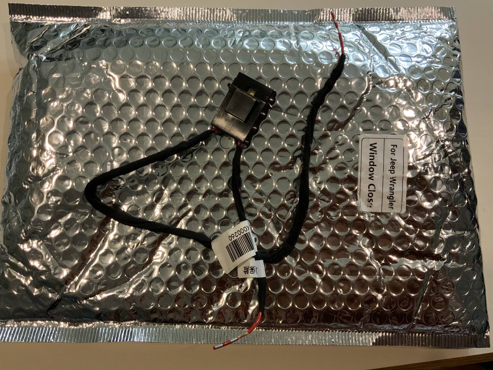

I just received mine today and ready to install. Quick question, I also received an additional fuse box with 2 red wires. Do I need to hook this up between the red battery wire and the battery? If so, does it matter which wire connects the the battery wire then to the battery?
How many fuses did you get in total? My set came with one fuse on the red wire that runs to the battery. If you don't have that fuse built into the wiring harness, then yes, you'll need to connect this fuse between the battery and the module. It doesn't matter which red wire connects to the battery since fuses work in both directions.
Otherwise if you have 2 fuses, then they sent you an extra.
