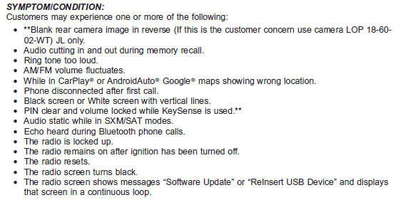

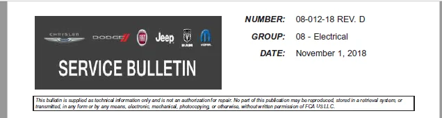

I got the run around from a dealer (Ziegler in Downers Grove IL). Jeep Cares told me that they have to follow a process to reproduce the problem. No help from Jeep Cares even though there is a service bulletin on this issue that states the fix is replacing the backup camera. It should not take multiple trips to a dealer and require the dealer to keep your vehicle for multiple days to try and reproduce this problem. After two winters, I said screw it and bought a new backup camera (part number 68452959AB). Installed it myself in 1 hour. Solved the problem. No issues this winter! Sad that a dealer could not do this for me. Jeep service and customer support is terrible.
